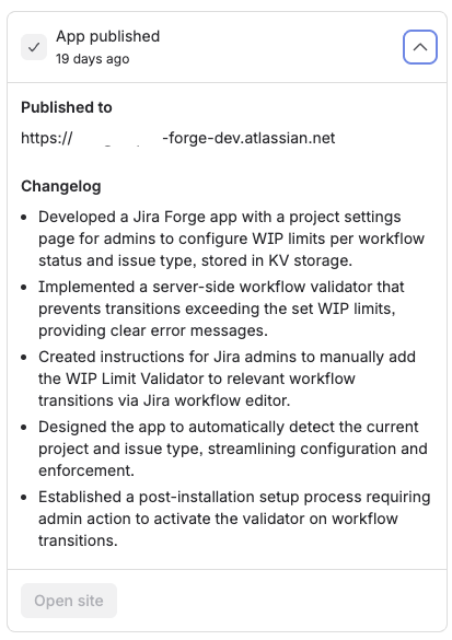

It looks pretty. Actually, it’s impressive. But there’s a lot more to the app I need to try out. I need to get my app onto my development instance. For that, I need to push Publish.

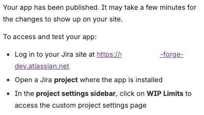

I can now see whether it works in my test environment. Rovo also provides instructions for testing.
And, following along, a synopsis of the build.

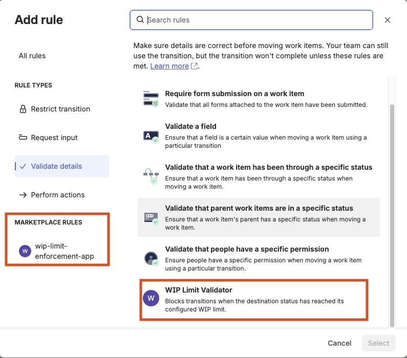

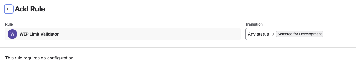

The first thing I want to check is whether my Validator is there. I open up a workflow to edit it. I go see if I can add the validator to a transition.
On the next screen, I confirm that I don’t need any additional configuration, so I click Save at the bottom.

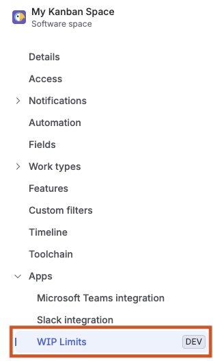

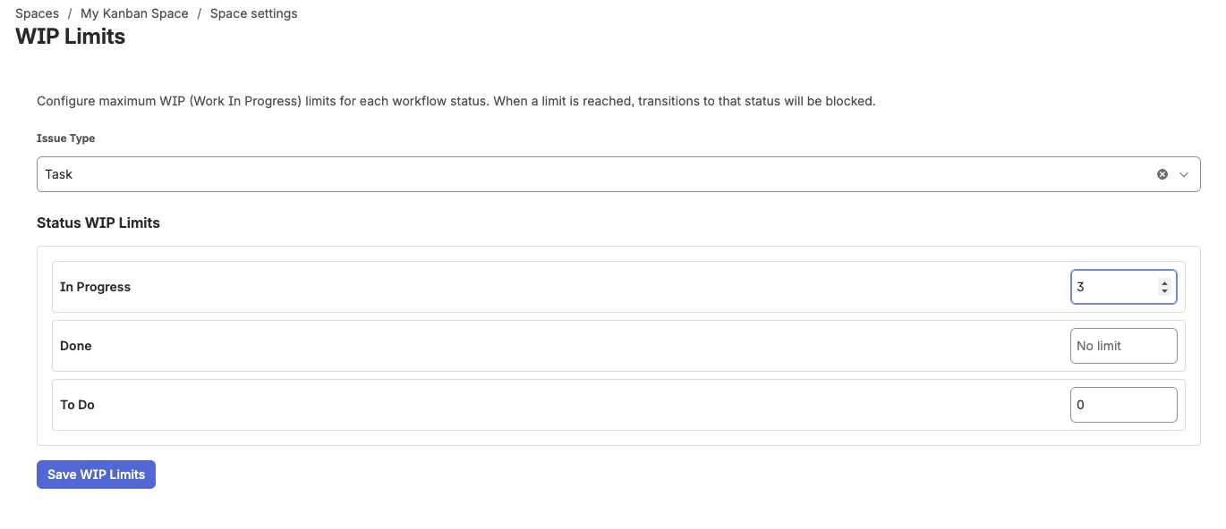

The next thing I need to configure is on the space level. I go to the settings of my test space to define which work items need WIP limits at which transitions. I find the app in the Apps section of Space Settings.
Clicking on WIP Limits gets me to the configuration page. From here, I select the work type and then select limits for each destination status. When done I click Save WIP Limits.
I can do this for each work type where I want WIP limits in its workflow.

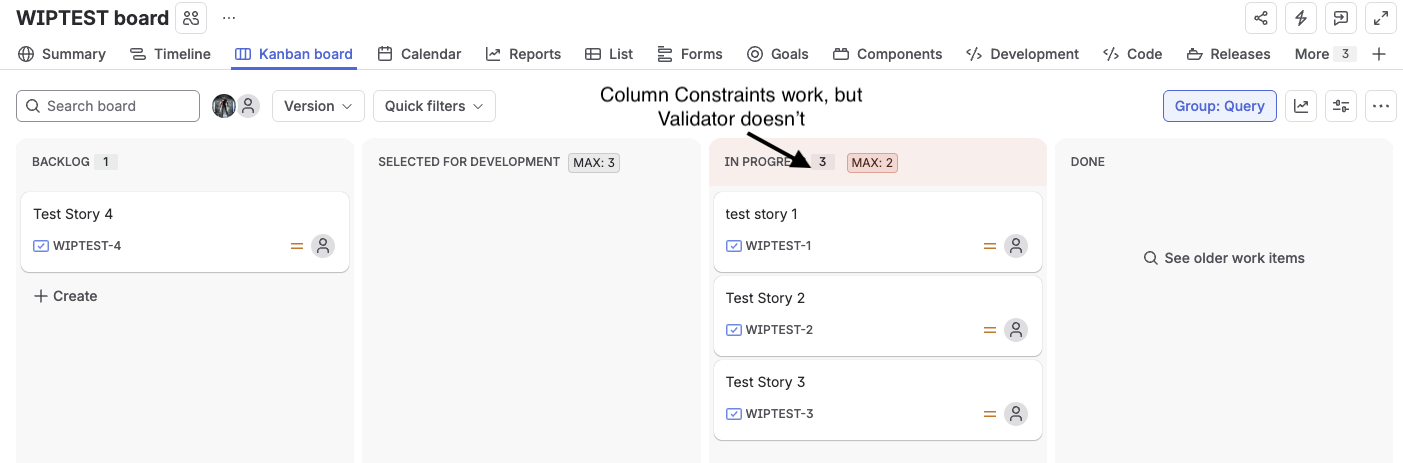

So, the configuration is done. Time to see if WIP limits are actually enforced.
Hmm…it’s not working. My first instinct is to look at the generated code and the logs to find out why.

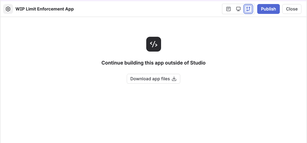

I want to have a look at the generated code. I can do so from the Rovo Studio page.
This lets me put the app’s code into Bitbucket, which I need to do, but I still need debugging help. Where to turn?

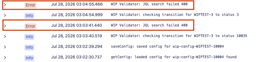

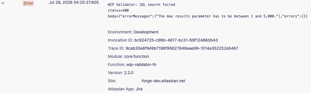

I’m eager to see what happened to my test runs. So, on the left column, I select Logs in the Troubleshoot section. From here, I can filter the logs based on when the events happened.

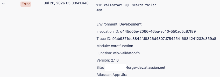

When I filtered the logs to match the timing of my tests, I found several errors:
Expanding on the error gives some more details.

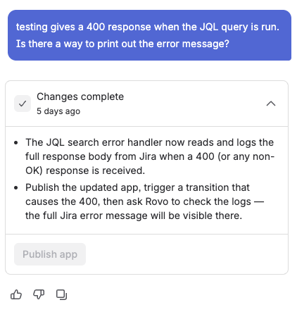

I got the error, but I need more context. Is there any way of adding the REST API response for the call that made the JQL query? Time to ask Rovo Studio if that was possible.
Publishing this version to the development environment added a new error log entry.
At this point, I have to download the code and examine the routine making the REST API call:

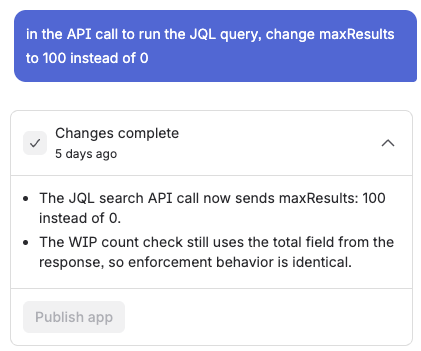

Reviewing the REST API documentation, I found Rovo Studio’s first error: maxResults is the number of results to return on each page when the JQL query returns a lot of items. A value of 0 is illegal. I let Rovo Studio know and started another publish-and-test cycle.

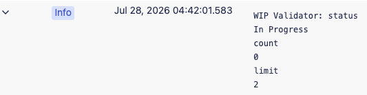

In this round of testing, I didn’t see any errors in the log, but the validator still wasn’t working. That meant the maxResults fix had resolved the API error, but not the validation problem. I did, however, see a useful clue:
Seeing the value of limit settles a lingering doubt: It is picking up the correct WIP limit from the stored configuration (more on that later). But the value of count is concerning: it is not picking up the correct value from the API call.

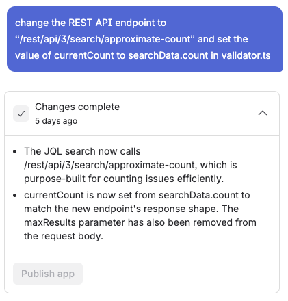

Rovo Studio had a choice for the REST API endpoint to use. It chose /rest/api/3/search/jql over /rest/api/3/search because the latter endpoint was being deprecated. But the original endpoint has something the newer endpoint doesn’t: a total child property that counts the total number of issues and is available in the API response. Rovo missed out on that.

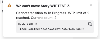

But there’s a better endpoint: /rest/api/3/search/approximate-count provides a count of work items that match the JQL query. My next revision is to ask Rovo Studio to use this endpoint instead.
From here on out, everything works as expected. I see the following popup message when I try to exceed WIP limits.

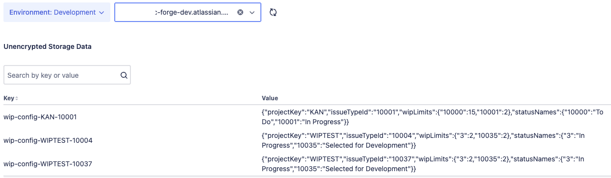

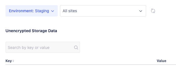

One of the things I couldn’t verify was whether any settings I had saved were really being saved. Now that I could view the storage from the Developer Console, I could check my settings.
The application spec that Rovo Studio created specified that the connections between work types, workflow statuses, and WIP limits were stored in Forge KV (Key-Value) storage. I can verify this by selecting Key value store in the Storage section of Developer Console.
After selecting the environment (development, staging, production) and site, I’m able to find the key value stores divided by space and work item.
