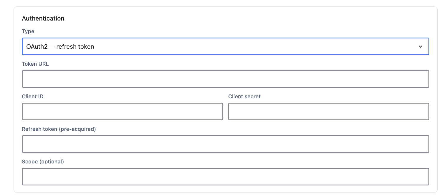

Snowflake Authentication
OnLink supports OAuth authentication to Snowflake.
Snowflake's SQL API accepts three authentication methods — OAuth, key-pair (JWT), and workload identity federation. OnLink uses OAuth, which means you configure an OAuth integration in Snowflake, OnLink obtains a token, and that token rides along on every API request.

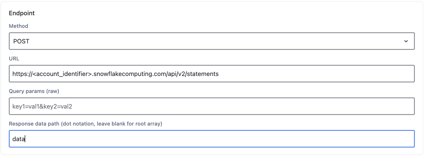

What to configure in OnLink
Endpoint Configuration

The endpoint
POST https://<account_identifier>.snowflakecomputing.com/api/v2/statements
Replace <account_identifier> with your Snowflake account identifier — for example, myorg-myaccount.
