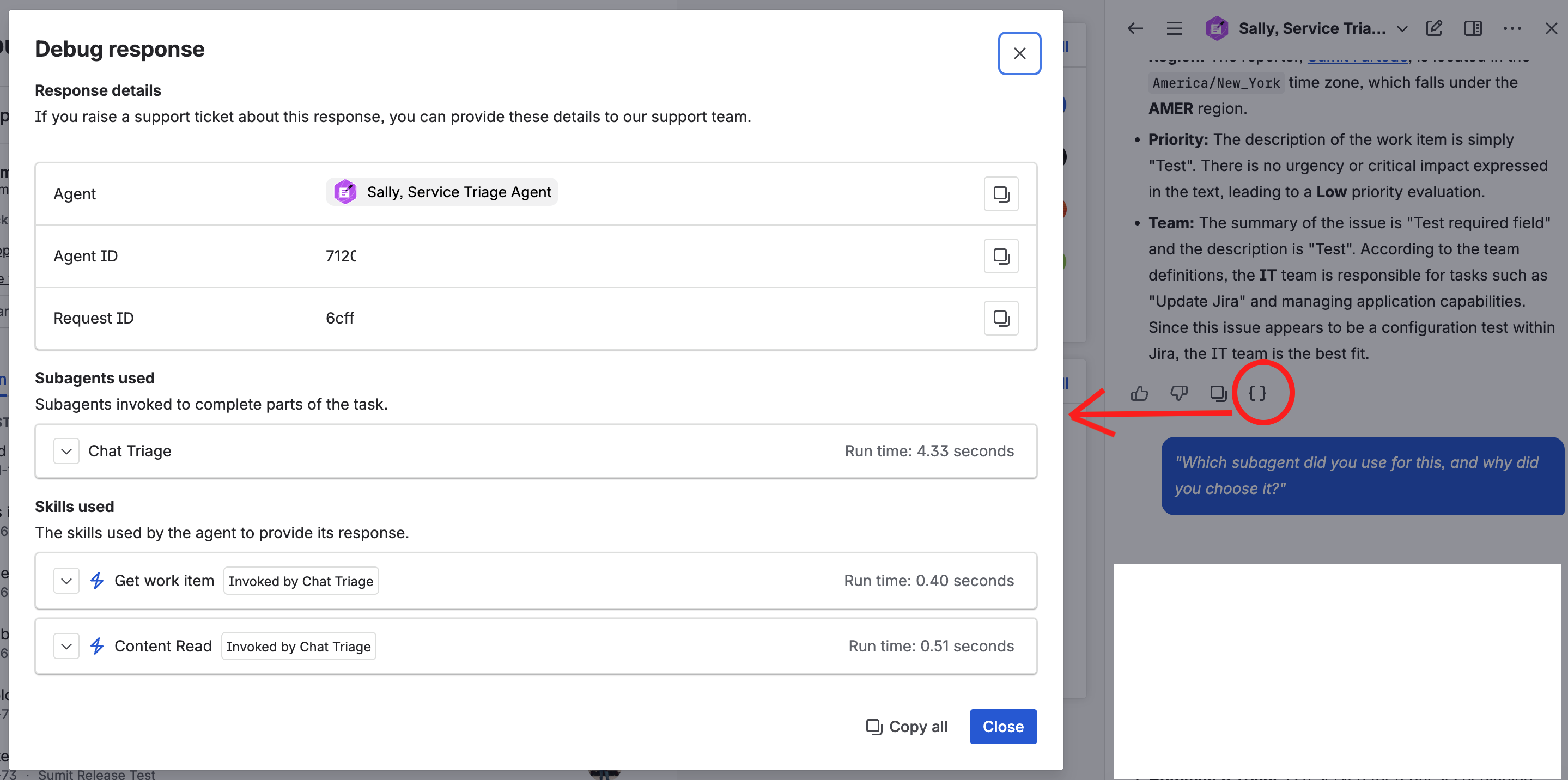

📺 Use the built-in Debug view
Rovo Chat has a built-in Debug responses from Rovo agents feature that lets you peek "under the hood" of any agent reply.
What you'll see:
Subagents used — which skill/instruction set the agent used to answer.
Agent ID and Request ID — unique references for that response.
Skills used - List of skills used by the agent to provide a response.
Tip: The Debug button only appears on a message from a custom agent — not in a regular Rovo chat. If you don't see it, confirm you're chatting with a custom Rovo agent.
🔬 Click here to Deep Dive into Debug Response!
Expanding Subagents used tab:
Check which subagents the response used. The Input and Output tabs show the subagent query and its actual response. If the correct subagent triggered but the agent’s final output differs, this can explain why.
Compare the subagent output with the agent response to see the differences.

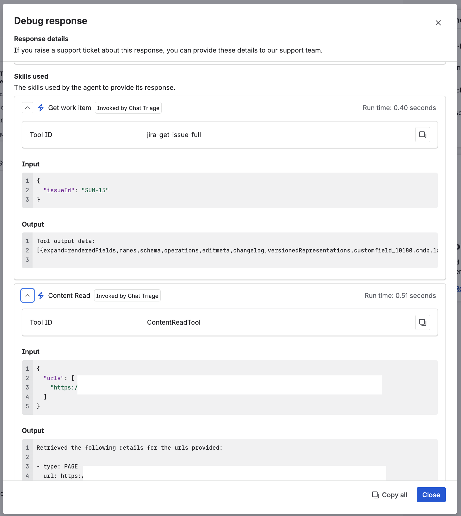

Expanding Skills used tab:
This tab lists the tools Rovo uses to generate responses, for example Get work item (Tool ID = jira-get-isssue-full) and Content Read (Tool ID = ContenReadTool). Users can pinpoint the exact skills used or missing, provide micro input for each skill, and view the corresponding outputs.
This view helps users determine whether the agent is unable to perform a task, or missing a specific micro detail.

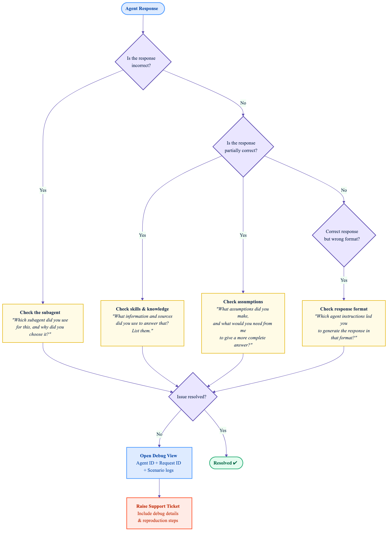

🪜 Example Debug Flow
🎫 Last Resort : Raise a new support ticket
If a response still looks wrong after checking the above, open a support ticket and use Copy all button to send Agent, Agent ID, and Request ID from the Debug view. These details let Atlassian trace the exact response quickly.
