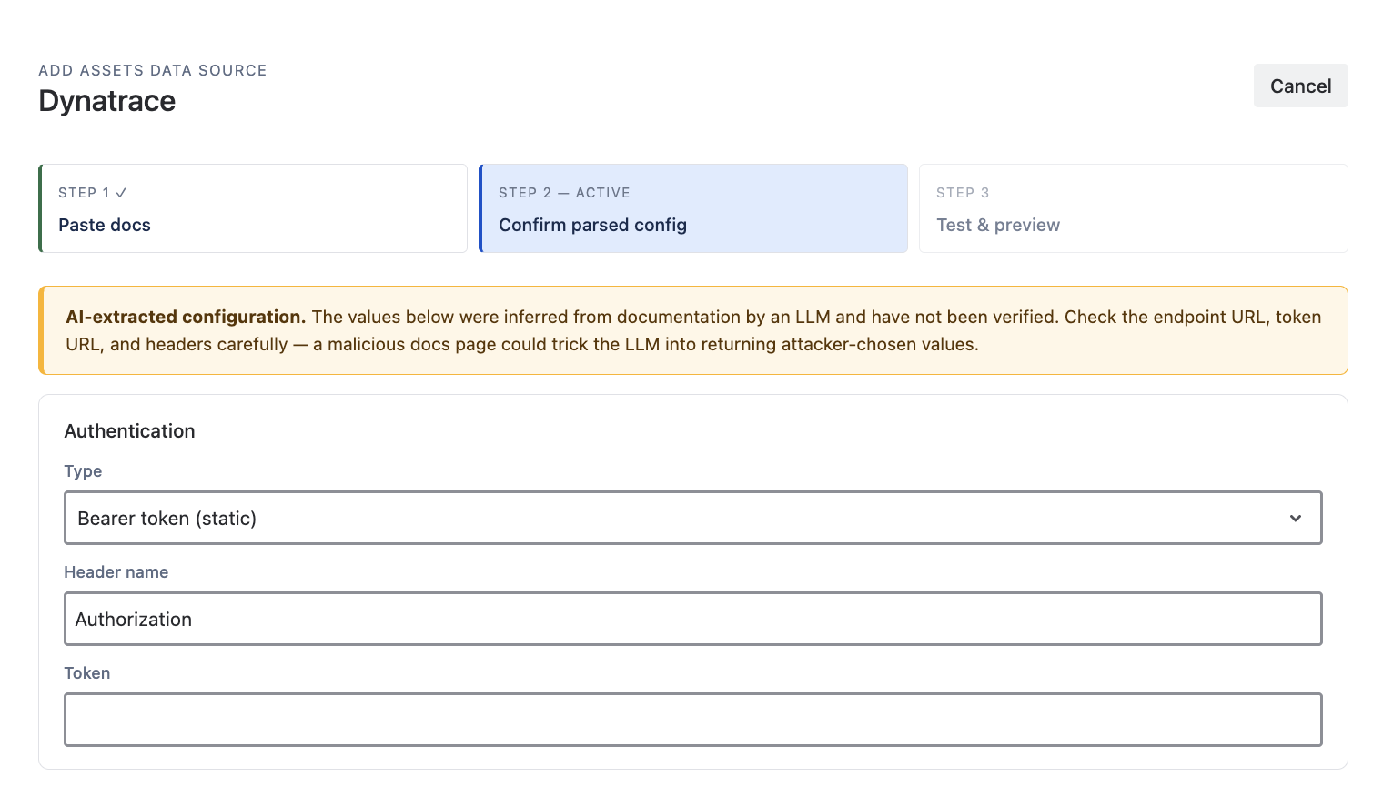

In the OnLink data source configuration:
- Add an Assets Data Source.
- Set Authentication Type to Bearer Token and paste the Dynatrace token.

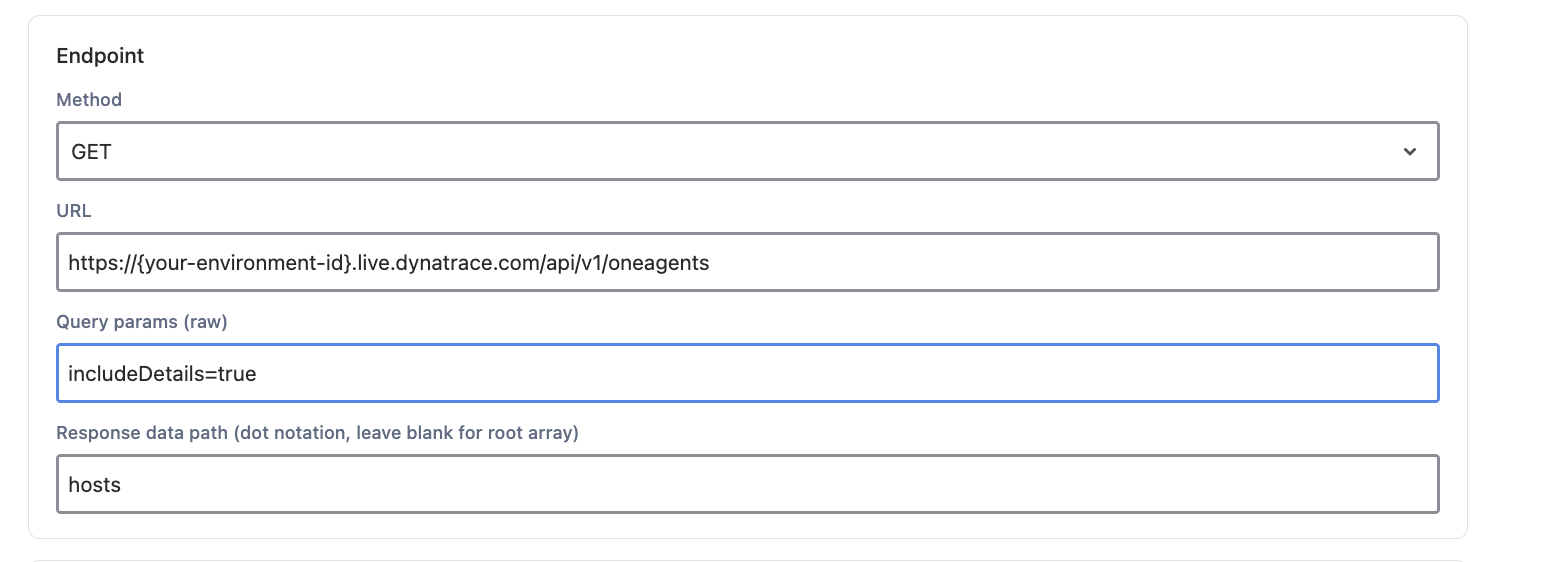

- Set Method to
GET and the URL to your environment's OneAgents endpoint:
<span>GET https://{your-environment-id}.live.dynatrace.com/api/v1/oneagents</span>
- Set Response data path to
hosts — the API wraps host records in a hosts array.

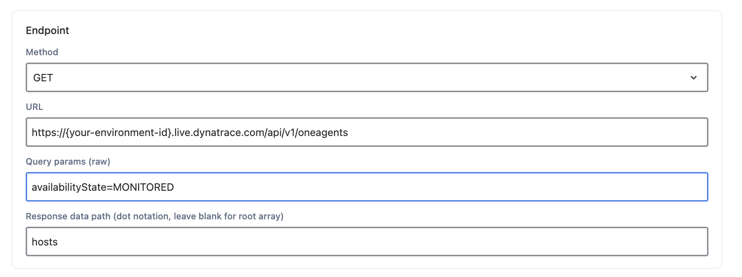

Filter query
You usually don't want every host Dynatrace has ever seen. The OneAgents endpoint supports query parameters to limit results server-side — see the OneAgent API parameter reference.
For example, to import only hosts that are currently monitored, add:
<span>availabilityState=MONITORED</span>
Other useful filters include narrowing by management zone, network zone, or update status. Filtering at the API level keeps imports fast and avoids stale or decommissioned hosts landing in your CMDB.
