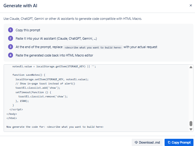

If you're using HTML Macro specifically, this same prompt structure is already built in: the macro editor has a "Generate with AI" option that produces a ready-to-copy version of this prompt for you.

- Copy the prompt above (or the built-in one, if you're using HTML Macro).
- Replace the placeholder line with your actual request (e.g., "a collapsible FAQ list," "a status dashboard pulling from a table on the page," "a countdown timer for a launch date").
- Paste the generated code into the HTML macro editor.
- Preview the page. If something doesn't render as expected, tell the assistant what broke. It can usually fix sandboxing issues in one follow-up.

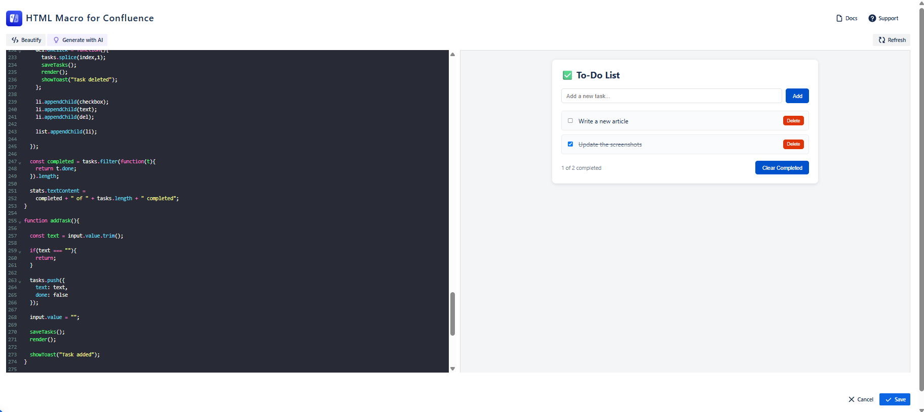

Here's what that looks like in practice: a simple to-do list, generated this way, pasted into the editor with the live preview updating automatically.

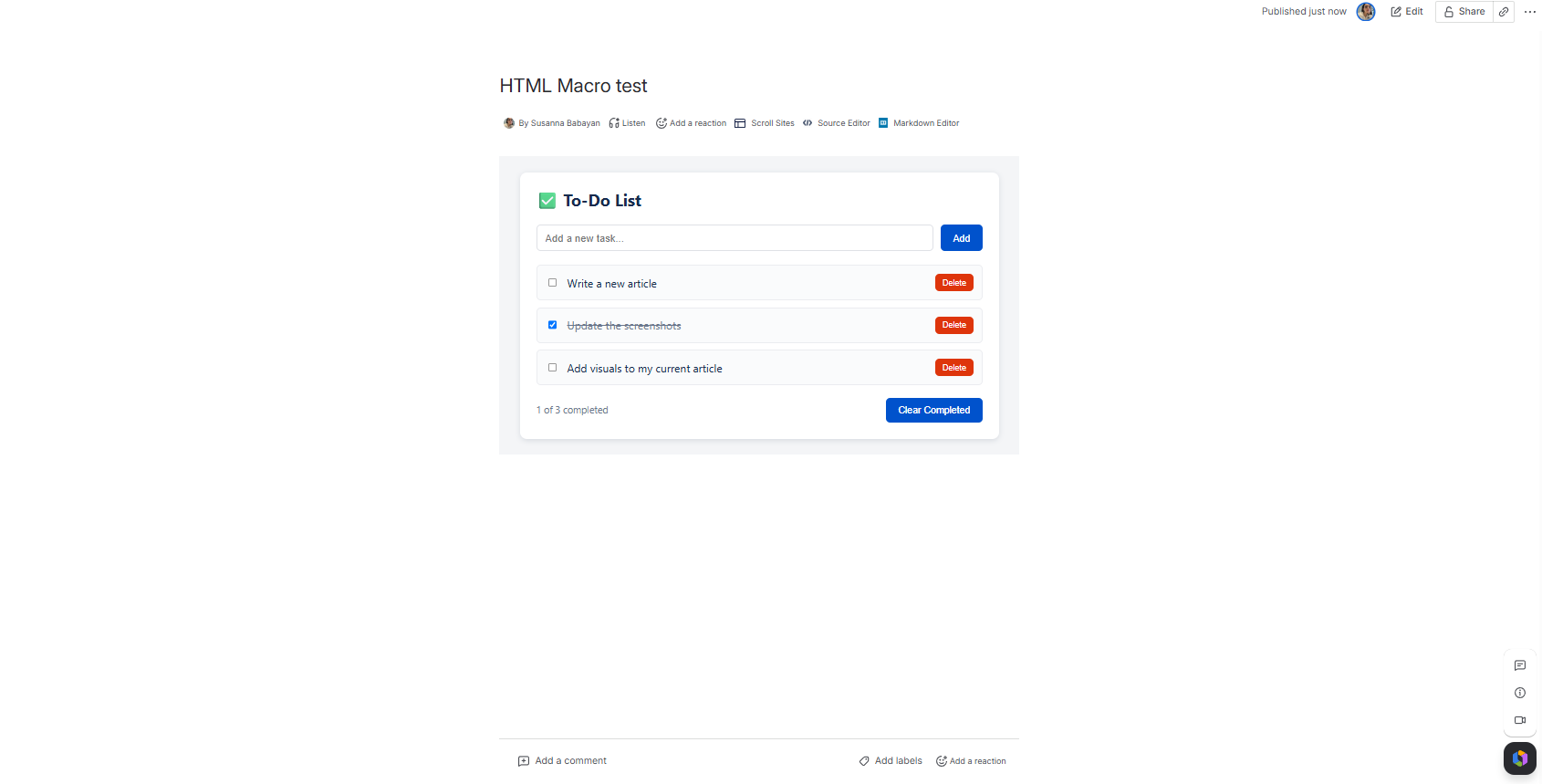

And the same widget once published, fully interactive on the live page.
