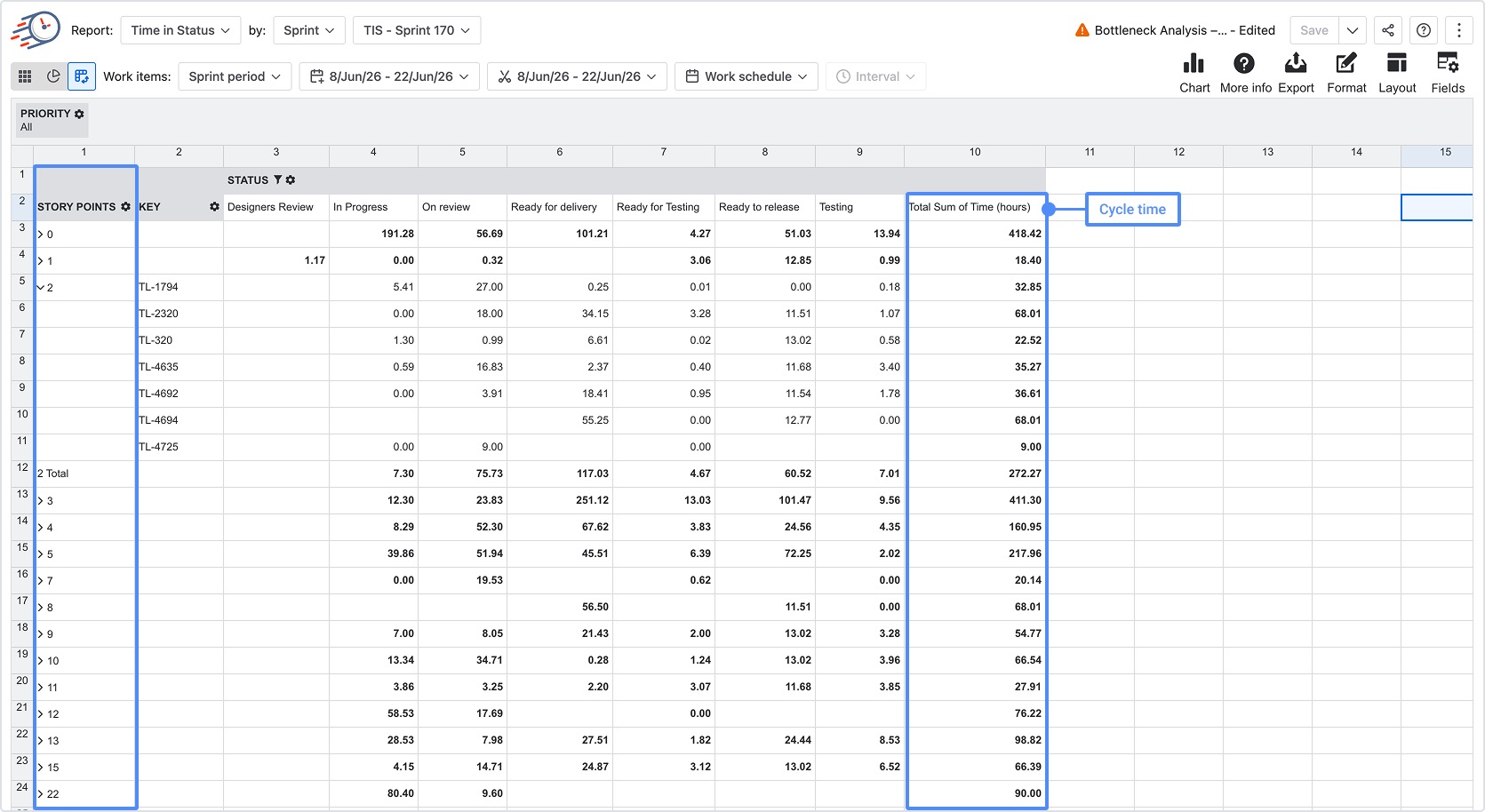

How to Use Both in Jira
A practical way to start is simple: group completed issues by story point value and compare average cycle time across several recent sprints. The goal is not to create a perfect prediction model. The goal is to understand your own delivery behavior.
For example, a team might look at the last six sprints and ask:
- How long do 1-point issues usually take?
- How long do 3-point issues usually take?
- Do 5-point issues behave consistently?
- Do 8-point issues have a wide range?
- Which point values are least predictable?
- Are some issue types skewing the results?
- Does cycle time grow as points increase, or is the relationship weak?
This gives the team a baseline built from real history. Not a generic agile textbook. Not another argument about whether Fibonacci is sacred. Actual team data.

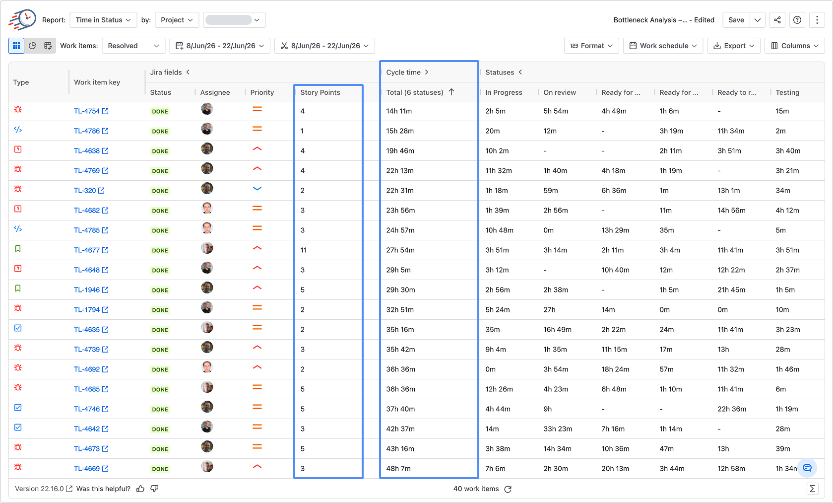

Where Time in Status Helps
This type of analysis becomes much easier when Jira history is turned into time-based reporting.
In Time in Status by SaaSJet, teams can use reports such as Average Time and Time in Status to understand how long issues actually spend in different workflow stages. When those reports are grouped or pivoted by story point value, the team can compare estimates against real cycle time.
A useful setup could look like this:
- filter completed issues from the last several sprints
- group by story point value
- calculate average cycle time
- compare results across issue types, assignees, projects, or sprints
- look for point values with unusually high variance
This is where Pivot Table View or row grouping becomes especially useful. Instead of scanning issue by issue, the team can compare story point values across groups and see whether the data support the assumptions behind the estimates.
