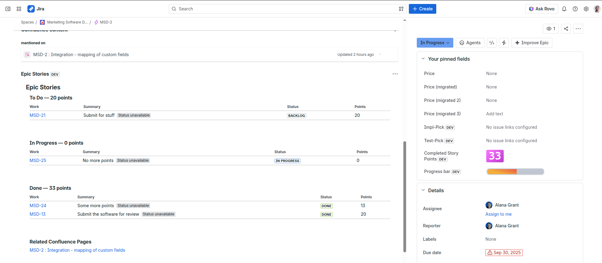

The first stretch is genuinely delightful. I described what I wanted, "a Jira panel that groups an Epic's stories by status and sums their story points", and a couple of minutes later it was running on a real issue, with a real app id, installed on my dev site. No scaffolding, no boilerplate, no CLI.

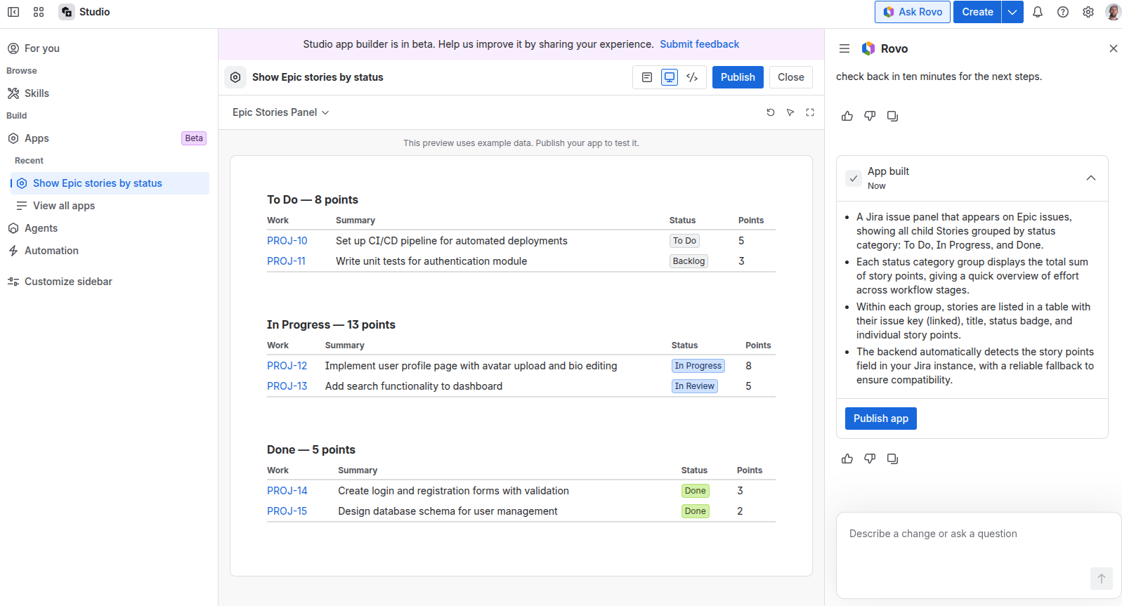

Then the small magic. I clicked a column in the live preview, typed "swap these two", and it rebuilt just that piece. When a build broke, I pasted nothing but the bare error message and it found the fix. When I told it something was wrong, it reconsidered and corrected itself instead of digging in. I asked it to handle the failure case for an unreliable API, and it added neat per-row fallback states so one bad call never took down the panel. There are thoughtful touches too: a desktop notification when a build finishes, a clearly labeled "this is example data" in the preview.

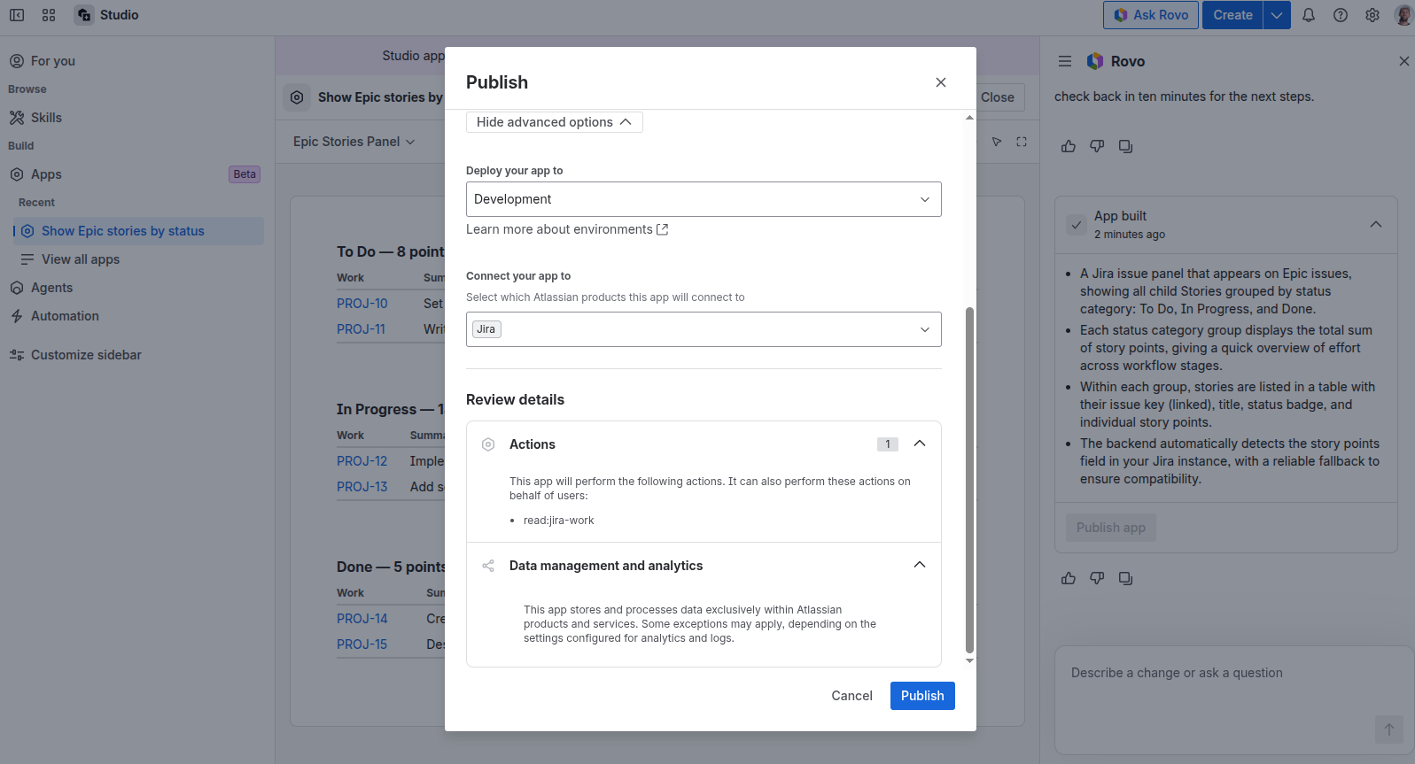

A few examples from my notes. The builder happily published an app whose local build was actually failing its type-check. The changelog it generated once described a feature that didn't exist in the code. A new permission, one that lets the app send data to an outside domain, arrived through a small, collapsed line in the publish dialog without much fanfare. And while wiring up an API key, I got a useful reminder to keep secrets out of code, which is exactly right, and then a prompt to paste the key into the chat, which is exactly the thing to be careful about. None of these is fatal. All of them are the kind of thing a beta smooths out over time. But together they taught me where to keep my eyes.

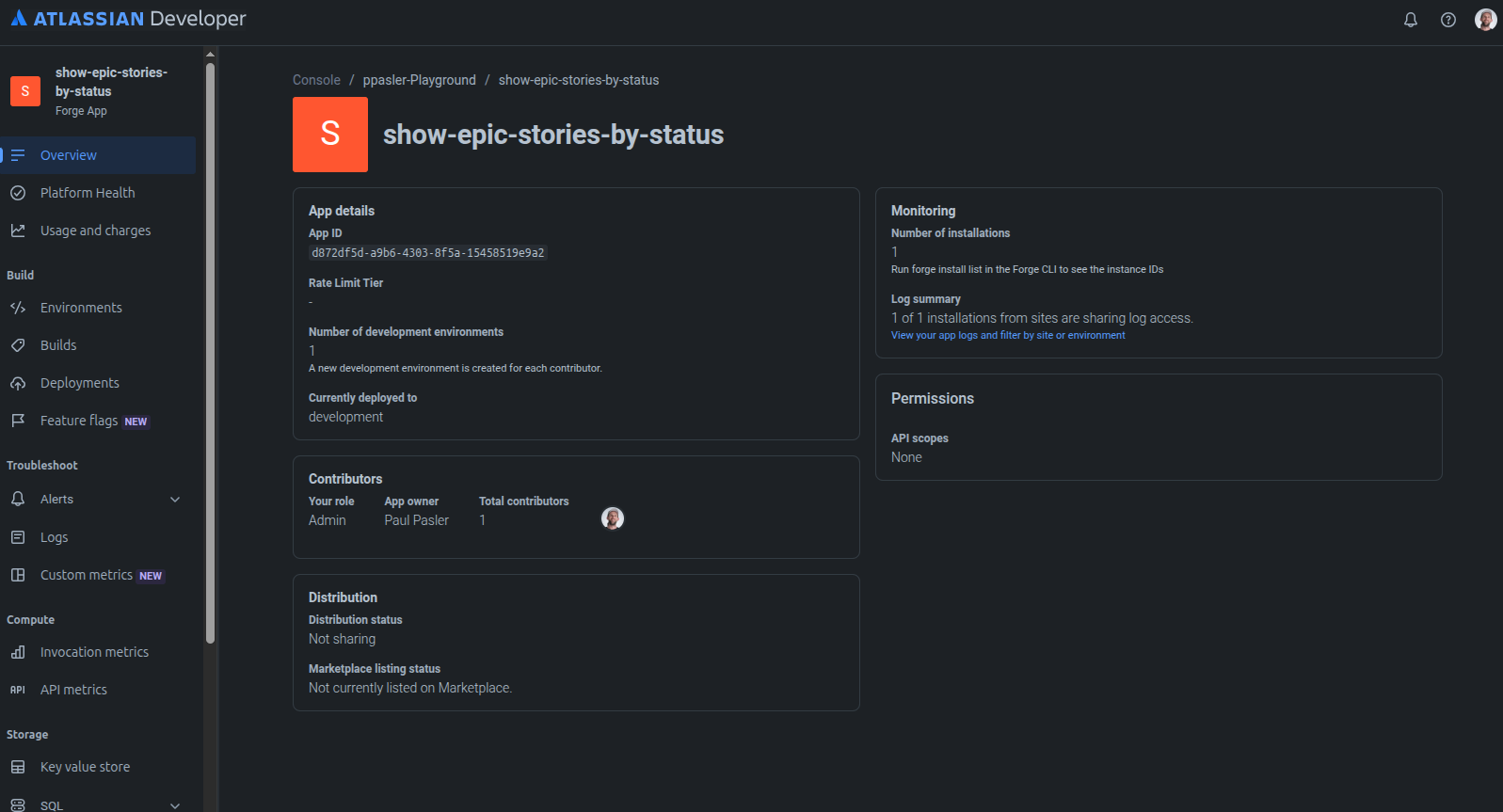

The longest detour was a cross-product call that simply refused to work. I had a confident theory. I was wrong. I had a second confident theory. I was also wrong. The tool had its own theories, some right, some not. The only thing in the whole episode that consistently told the truth was the runtime logs in the Developer Console. That turned out to be the single most useful habit of the entire trip.

Read the logs. When the tool says "fixed" or "your app is live", treat that as a hypothesis, not a fact, and confirm it in the Developer Console: deployments, logs, API metrics. This one habit saved me every time, and it humbled both the tool's guesses and my own.

Notice the governance moments. New scopes and new egress are real decisions. They can slide by quietly, so it is worth pausing on the publish dialog and actually reading what you are approving, especially anything that sends data outside Atlassian.
