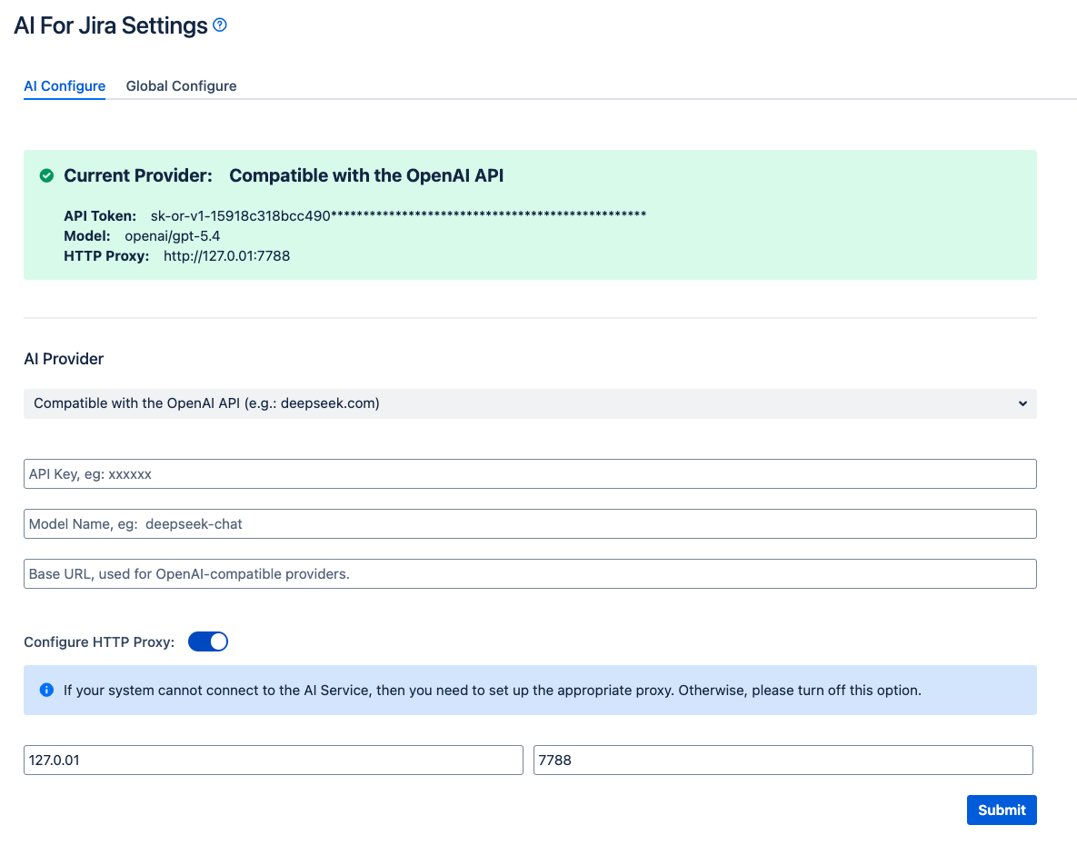

2. Configure your AI provider
In the admin configuration page, choose the provider you want to use.
Depending on your environment, you can connect:
- OpenAI for a fast managed setup
- An OpenAI-compatible endpoint if your organization uses a compatible provider
- Ollama if you want a self-hosted model option
- Azure OpenAI if your AI strategy already runs on Azure
- Qwen if that model family fits your regional or platform requirement
Then enter the required connection details, such as API key, model name, endpoint details, or deployment name. If your network requires outbound traffic to go through a proxy, configure the HTTP proxy settings at the same time.
This provider flexibility is an important point for Data Center customers. It lets teams adopt AI without being forced into a single model vendor or a single deployment pattern.

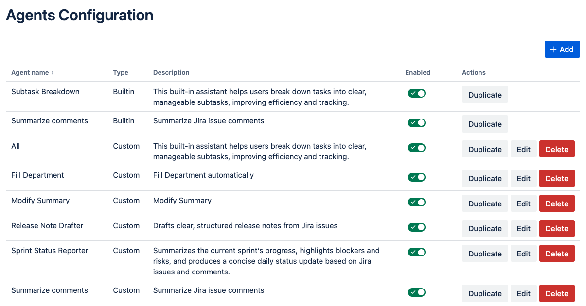

3. Enable the right agent experience
After the provider is configured, the next step is deciding how users will interact with AI.
The plugin includes a built-in Default Agent with broad Jira issue management capabilities, including creating, editing, searching, and transitioning issues. For teams that want more specialized experiences, the app also supports built-in and configurable assistants.
One example is the built-in Subtask Breakdown assistant. It is designed specifically to turn a larger Jira issue into a set of manageable sub-tasks, rather than simply generating generic suggestions.

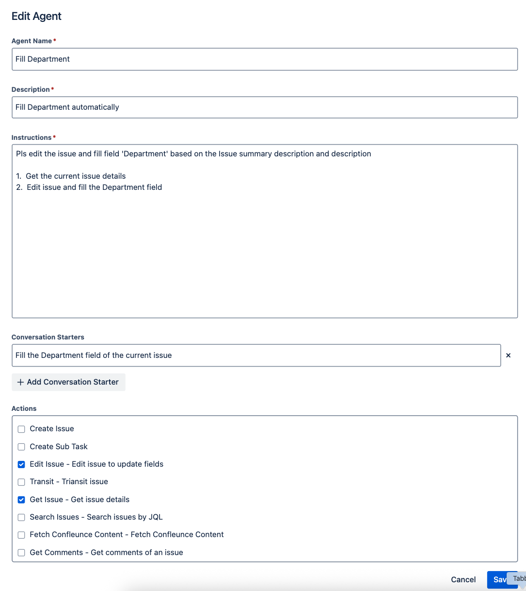

Configuration
Here is how that agent can be configured:
| Agent Name |
Fill Department |
| Description |
Fill Department automatically based on issue description |
| Instructions |
Please edit the issue and fill the `Department` field based on the issue summary and description.
1. Get the current issue details.
2. Edit the issue and fill the Department field.
| Conversation Starters |
Fill the Department field of the current issue |
| Actions |
Get Issue, Edit Issue |

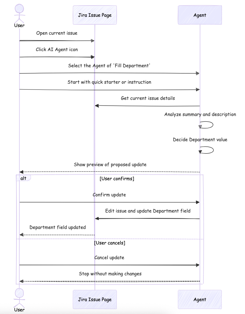

Usage
Once this agent is configured, the user can open the current issue, click the `AI Agent` icon in the upper-right corner, and select the `Fill Department` agent.
From there, the user can invoke it with clicking the quick starter such as:
"Fill the Departmentfield of the current issue"

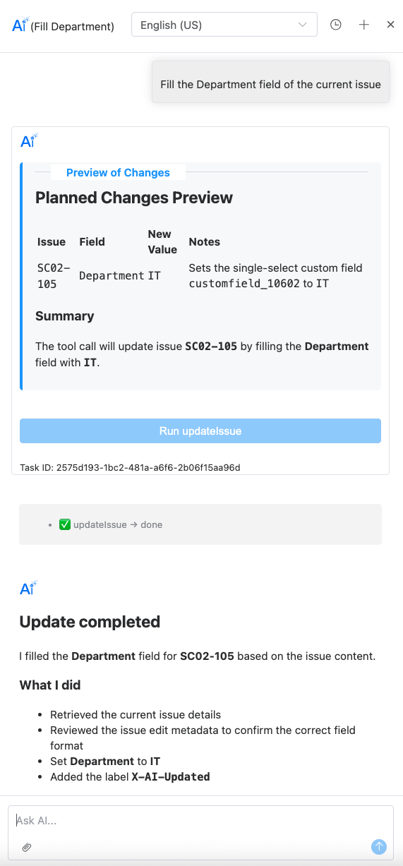

The agent then performs a short, practical workflow:
- Get the current issue details.
- Generate a preview of the proposed `Department` field update.
- Wait for the user to confirm the change.
- Edit the issue and fill the `Department` field.
This is a strong example because it is small enough to deploy quickly but meaningful enough to deliver immediate operational value. The user does not need to understand the field structure and select options , remember the routing rules, or manually decide which department should own the issue. The agent reads the current issue context and updates the right field in Jira.
That matters because real Jira Data Center environments often rely on custom fields for triage, team ownership, reporting, and workflow routing. If those fields are missing or inconsistent, the downstream process slows down. With a focused agent like `Fill Department`, teams can reduce manual classification work and keep issue intake more consistent.

From the user side, the experience is simple: open the current issue, invoke the agent, and provide a natural-language instruction.
Under the hood, the workflow is more structured.
First, the agent uses its configured instructions and allowed actions to determine what it is supposed to do. In this example, the goal is narrow and explicit: inspect the current issue and populate the `Department` field.
Second, the agent retrieves the current issue details. This step matters because the decision should be based on the actual Jira content, not on a user retyping the ticket in chat. The summary and description already contain the business signal needed for routing.
Third, the agent interprets that issue context and decides which department best matches the request. For example, an access request may map to IT, a payroll dispute may map to Finance, and a benefits or policy request may map to HR.
Finally, the agent executes the issue edit and writes the result back to Jira. Because the workflow is tied to Jira issue operations, the output is not just a suggestion in a chat window. It becomes an actual field update inside the issue.
That is the key difference between a generic AI assistant and a Jira-native AI agent. A generic assistant can recommend what to do. A Jira AI agent can read issue context, call the right action, and update the issue in the same working flow.
