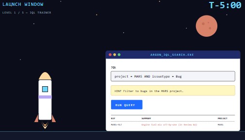

T-5:00. Greg from QA interrupts with the worst sentence in software: "I think there's a software issue somewhere on the rocket?" The MARS project has hundreds of issues across three programs. Mission control is on the line. The clock does not stop.
On the right side of the screen is a Jira-style issue list with a real JQL input labelled ARGON_JQL_SEARCH.EXE. On the left, a pixel rocket on the pad. Below, Greg types out hints in real time. Your job is to narrow hundreds of issues down to one before the countdown hits zero.
What You Learn (in Five Levels)
- T-5:00 — Where do I even look? Filter by
project. The starting view shows issues from MARS, VENUS, and JUPITER all mixed together — you have to scope down before anything else makes sense.
- T-4:00 — Just the bugs. Combine clauses with
AND and add an issuetype = Bug filter. The first taste of stacking constraints.
- T-3:00 — Critical only. Two priorities matter: Highest and High. Instead of two
ORs, you learn the IN (...) operator.
- T-2:00 — Which component? Mission control radios in: the rocket is wobbling. That's propulsion. You add
component = propulsion and find a single suspect: MARS-417, "engine fuel mix off-by-one." But it's In Review. Is the fix actually deployed?

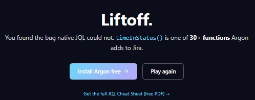

- T-1:00 — Find the real problem. Native JQL can't filter on time-in-status. JQL Argon can. You write
issue in timeInStatus("project = MARS AND component = propulsion", "In Review", "3d") and discover MARS-417 has been sitting in review for eight days. Nobody merged it. You ping the deploy team. Liftoff.
