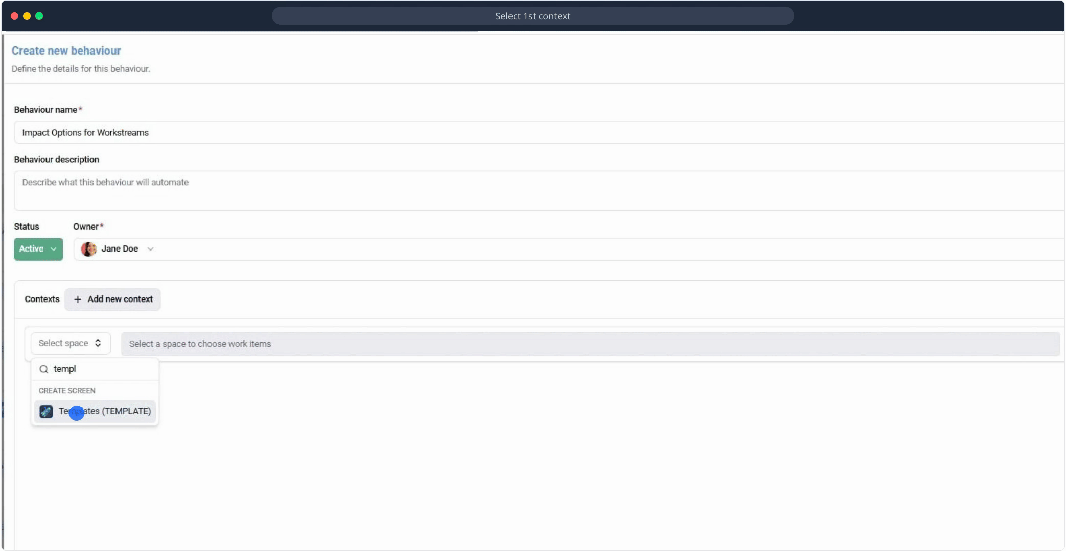

Define the first Context: Space = Templates, Work Type = Workstream

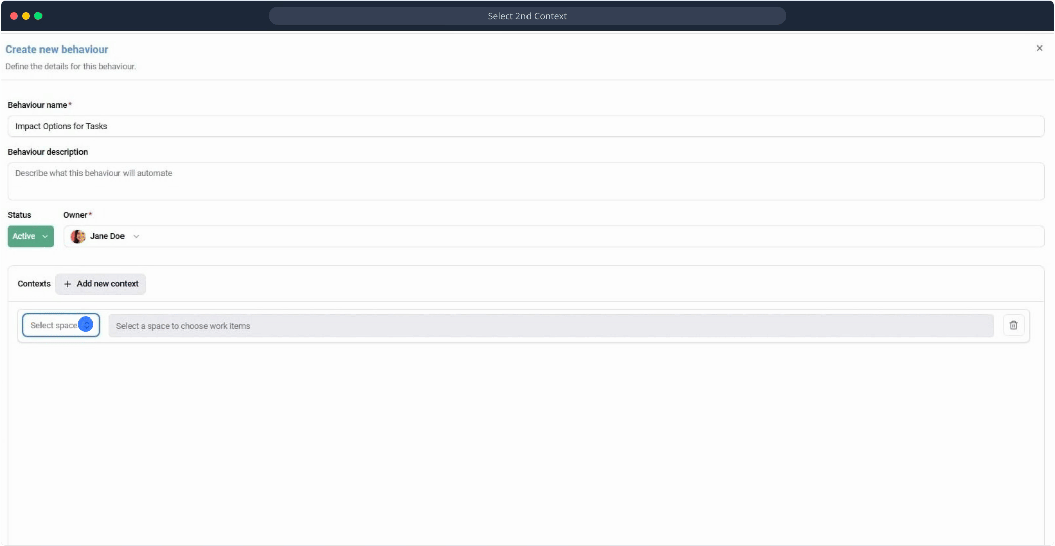

Define the second Context: Space = Templates, Work Type = Task

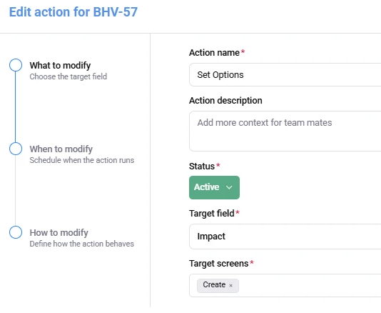

Now, for each Context, you add the actions to be performed on the Target field: Impact.

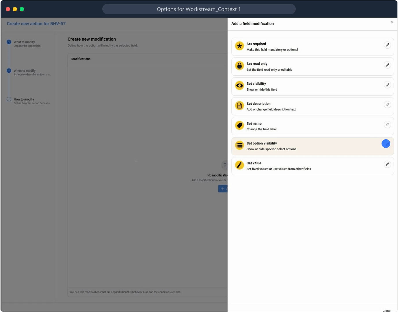

Set Options for Context 1
Set Options for Context 2

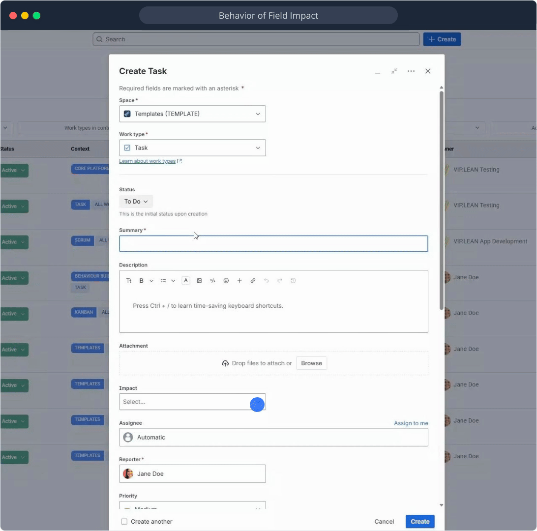

Result: The available options in Impact now follow the work type, inside the same space, with one underlying field.
