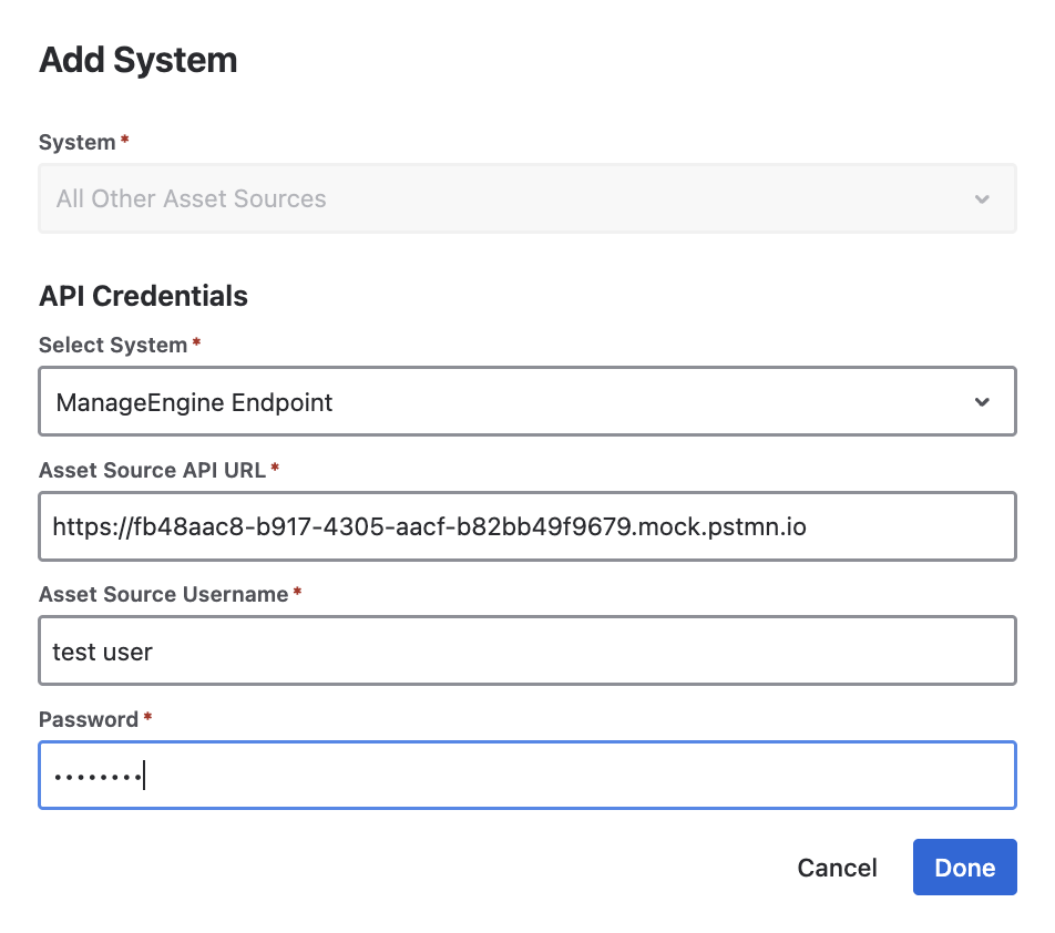

Step 1: Configure the Connection
In OnLink, choose "All Other Asset Sources" and select ManageEngine Endpoint Central to add a new connection. You'll need:
- The base URL of your Endpoint Central server (e.g.,
<a href="https://endpoint-central.yourcompany.com" rel="noopener nofollow noreferrer" target="_blank">https://endpoint-central.yourcompany.com</a>)
- A username and password for API authentication (OnLink uses the "Generating Authentication Key using API tool" mechanism described in the Endpoint Central API docs)

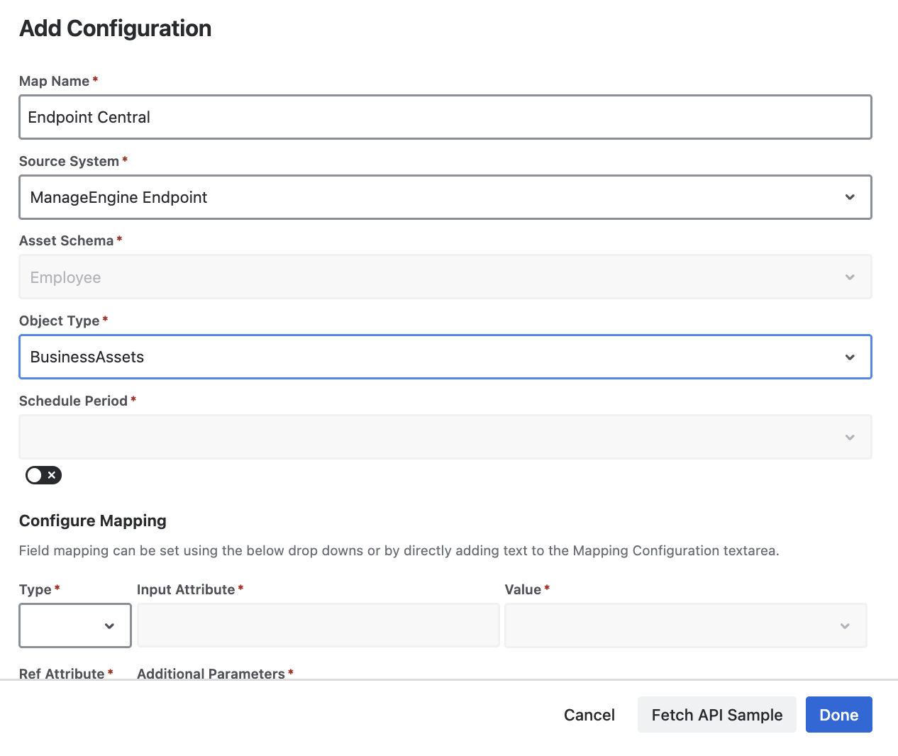

Step 2: Set Up the Asset Mapping Configuration
Once the connection is established, configure the API in your Asset Mapping Configuration within OnLink. This is where you tell OnLink which Endpoint Central API endpoint to call and how to map the response fields to your JSM Assets object schema.

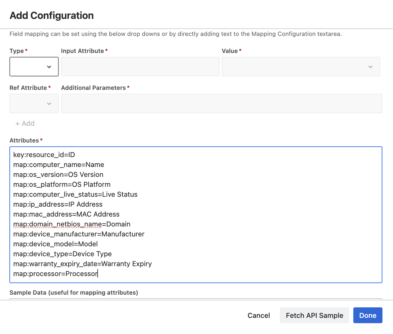

Step 3: Define Your Field Mapping
OnLink uses a straightforward mapping syntax. Here's an example configuration:
<span>key:resource_id=id
</span><span>map:os_version=OS Version
</span><span>map:os_platform=OS Platform
</span><span>map:status_label=Status</span>
How to read this:
| Syntax |
Description |
key:resource_id=id |
Designates resource_id as the unique identifier. The key keyword tells OnLink to use this field to match and update existing records rather than create duplicates. id is the target text attribute in Assets. |
map:os_version=OS Version |
Maps the os_version field from Endpoint Central to the "OS Version" text attribute in your Assets schema. |
map:os_platform=OS Platform |
Maps os_platform to the "OS Platform" attribute in Assets. |
map:status_label=Status |
Maps the device status label to a "Status" attribute. |
You can extend this mapping to include any field returned by the API — computer name, IP address, MAC address, domain, and more.

Mapping syntax example for the full set:
<span>key:resource_id=ID
</span><span>map:computer_name=Name
</span><span>map:computer_live_status=Live Status
</span><span>map:ip_address=IP Address
</span><span>map:mac_address=MAC Address
</span><span>map:domain_netbios_name=Domain
</span><span>map:device_manufacturer=Manufacturer
</span><span>map:device_model=Model
</span><span>map:device_type=Device Type
</span><span>map:warranty_expiry_date=Warranty Expiry
</span><span>map:processor=Processor</span>
Tip: Before configuring your mapping, make sure the corresponding attributes exist in your JSM Assets object type schema. Create any missing attributes first, then reference them by exact name in your OnLink mapping configuration.
