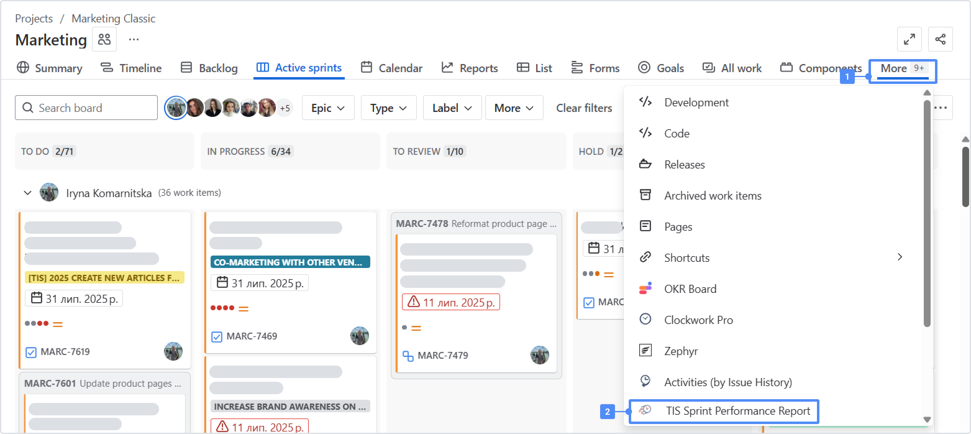

Step 1: Open the Sprint Performance Report (properly)
The Sprint Performance Report works only on boards where sprints are enabled. To open it:
- Go to your board → click More (top right) → Sprint Performance Report
- Pick the sprint you want to analyze (completed—or active, more on that later).

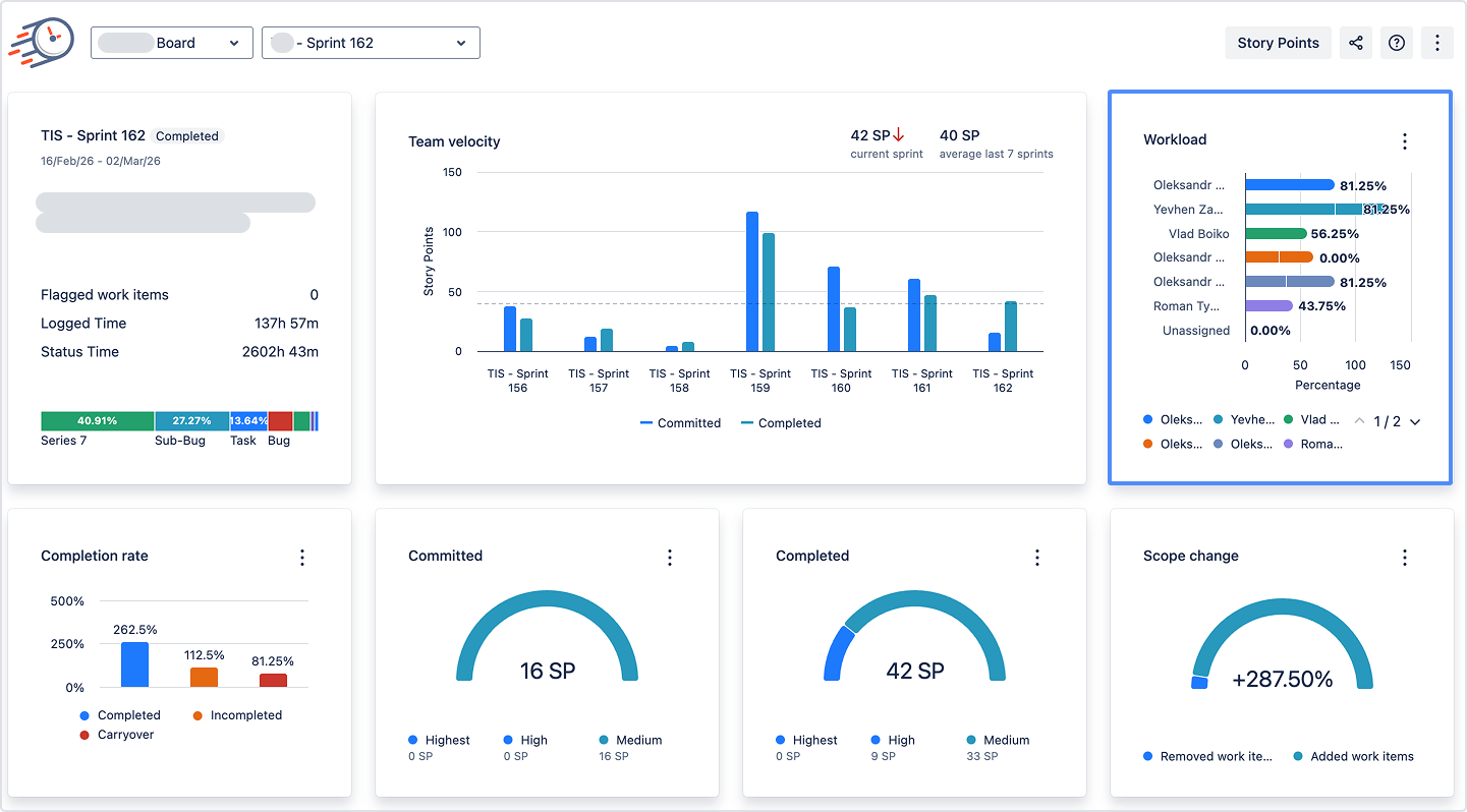

Step 2: Meet the Workload chart (where hidden heroes get caught)

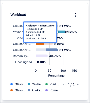

In the report, Workload by Assignee shows how work was distributed among people during the sprint.
Each assignee gets a stacked bar:
- Committed = what they started the sprint with
- Added = what got assigned to them during the sprint
- Removed = what got taken away during the sprint.
Positive portions show committed + added; negative portions show removed. Unassigned items can appear too (which is Jira’s polite way of saying “everyone’s responsible, so no one is”).
The chart even spells out the “color logic”:
- bright segments = committed + added
- light segments = removed
…and you can hover a person’s line to see their numbers.
The actual workload math (so you can explain it in a retro)
Per assignee, workload is calculated like: (Committedₐ + Addedₐ − Removedₐ) / Committed
(There’s also a “Total Sprint Commitment” form of the formula shown in the docs; the spirit is the same: it’s showing how much of the sprint’s planned load ends up on each person.)

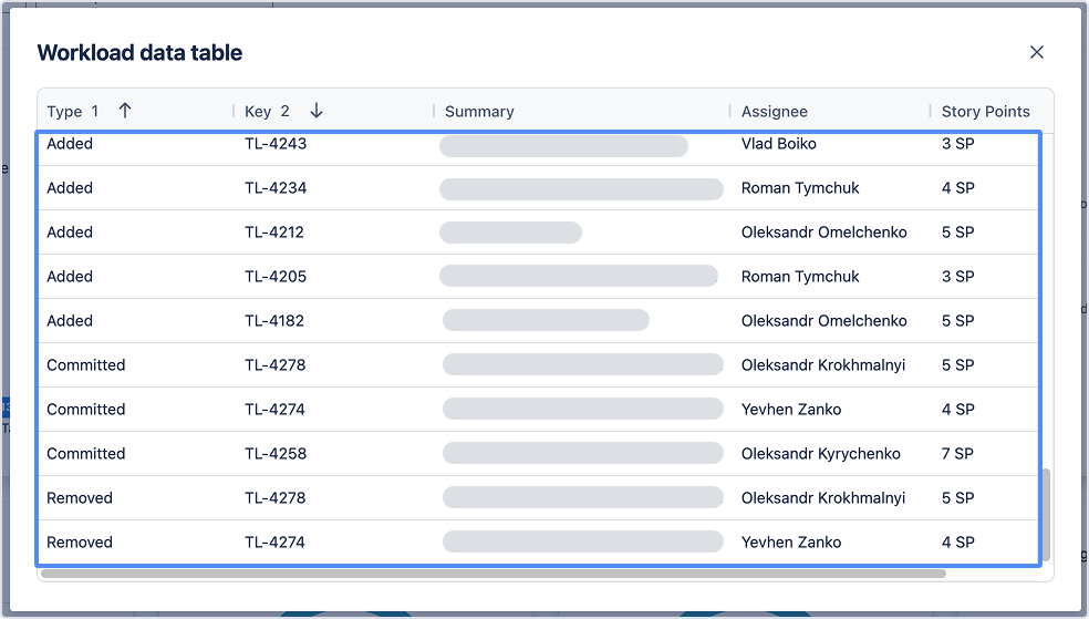

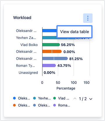

Step 4: Click “View data table” to see the receipts (no guessing)
Charts are great. Charts also cause arguments.
That’s why Sprint Performance Report includes View data table: open a detailed table that shows exactly which issues were included in a metric’s calculation (with estimation values).
How to use this for workload imbalance:
- Open the sprint → go to Workload
- Find the “hidden hero” bar
- Use the data table to identify what kind of issues created the load (bugs? reviews? interrupts? big stories?)
- Decide on a fix that matches the real cause (not the loudest theory)

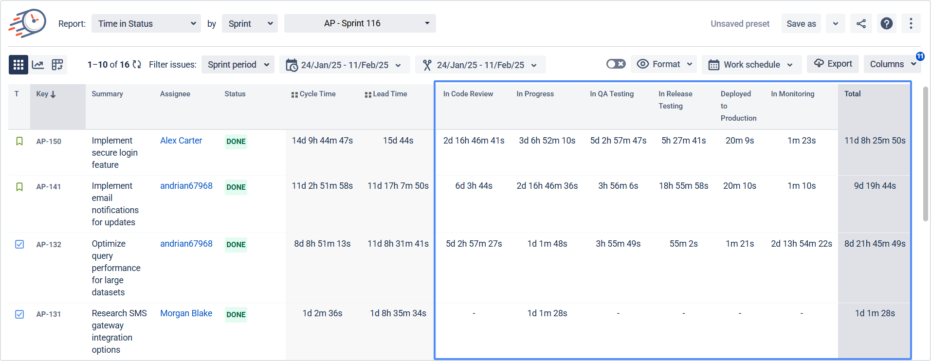

When Workload looks bad, tie it to “where time actually went”
Sprint Performance Report is meant to give you the sprint story, including workload and “where time actually went.”
If workload is uneven, drill deeper using Time in Status’ other reports to find the exact bottleneck status (Review, Waiting, Blocked) and whether rework loops exist.
That’s how you keep the conversation evidence-based:
Not “you were blocked a lot,” but “Review time spiked and work got reassigned mid-sprint.”
