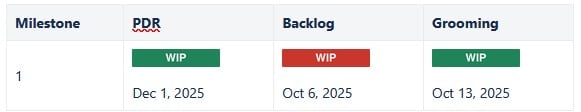

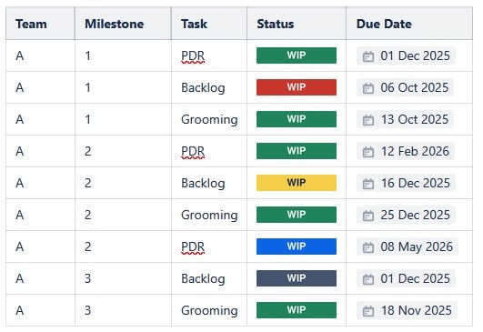

I have a (sample date) table below. I want to group by the milestone and show the status for a task in the same cell as the Due date. I have the SQL below. But when it combines the status and due date the status formatting is lost and it just shows as plain text. I looked into using a case statement and manually formatting the status with a Case Statement and {status:colour=Green|title=" + T1.'Status' + "}" but I don't see a way to know the status color or to accommodate status values which are variable
Desired Result
with row for each milestone and the columns, status color/value dynamic based on the data.

Sample Data Table
