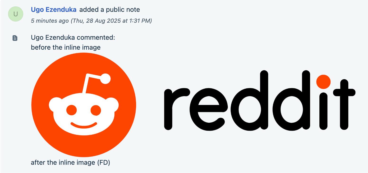

With Exalate, you can sync inline images from Freshdesk to Jira Cloud. So whenever you add an inline image in a note or even the description of a Freshdesk ticket, it will be automatically forwarded to Jira.
Similarly, when you add an inline image to a work item description or comment, it will appear as an actual inline image in the public note or attachment.
The key thing here is that it doesn’t appear as an attachment and clogs up the work item. But to understand how that happens, let’s talk about the differences between inline images and attachments.

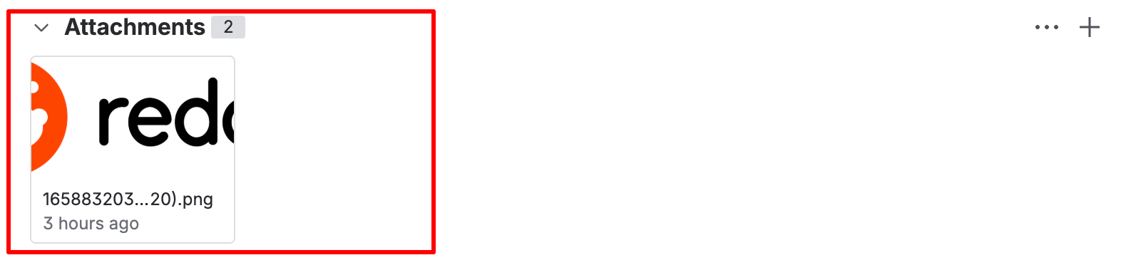

Attachments are files added to a ticket or comment but listed separately, usually below the main message body. They're meant for download and long-term reference.
On Jira, you’ll see them in the work item as a separate field for download.
The real difference is user experience: inline images are contextual within a ticket or work item, while attachments are optimized for storage and download.

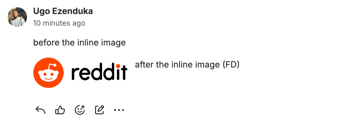

Before we go into detail, let’s look at the use case closely. When you add an inline image to a Jira comment:
The comment will appear on the Freshdesk ticket alongside the image.

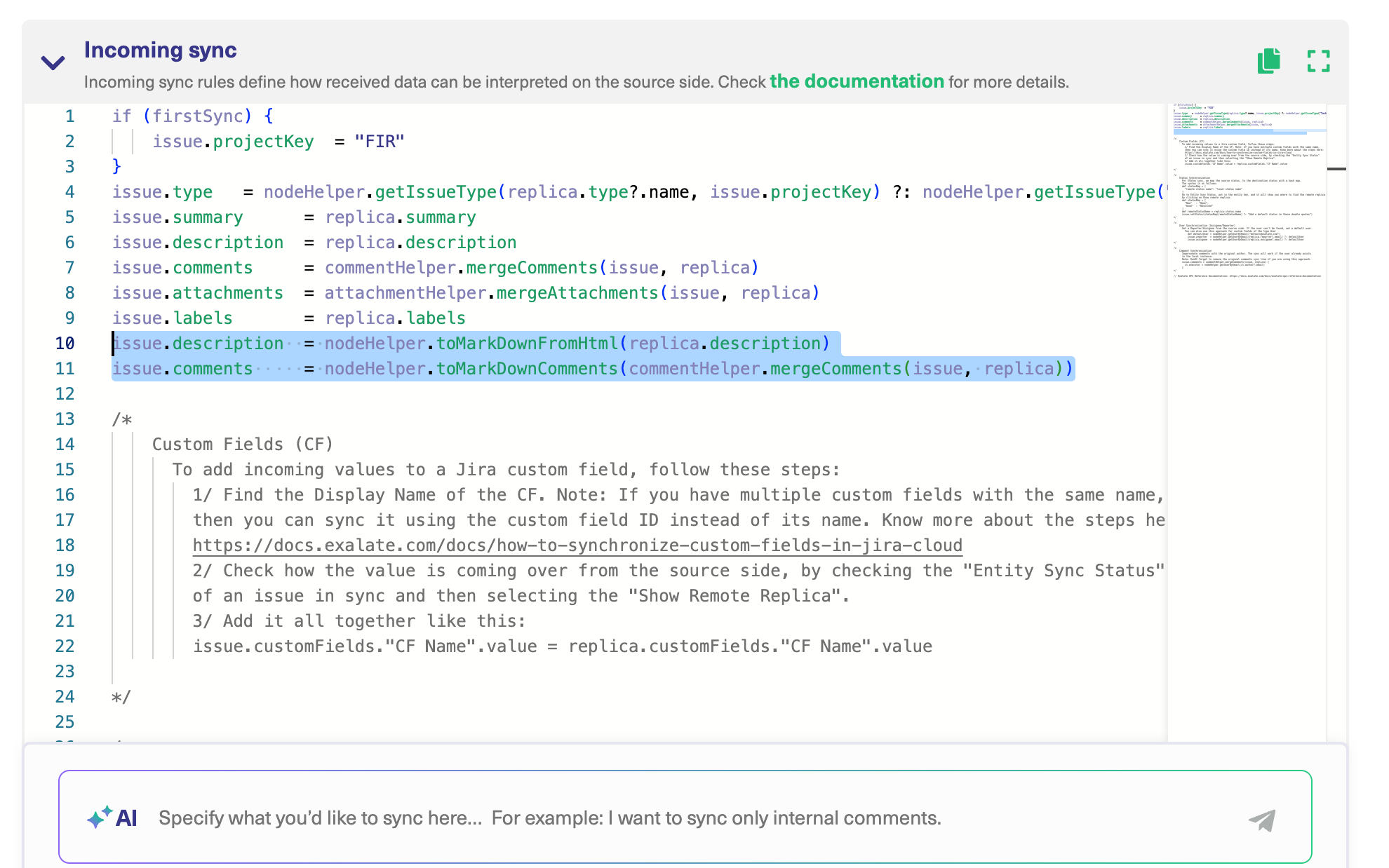

The feature is not available by default, which means that you’d need to set up a Script mode connection between Jira Cloud and Freshdesk. This type of connection makes it possible to write a custom script in order to map inline images.
So after setting up the connection, go to the scripting console and enter the following code snippets on either side. Or you can ask AI Assist to fetch you the code:

The following code is used to convert the incoming data from HTML to Markdown:
issue.description = nodeHelper.toMarkDownFromHtml(replica.description)
issue.comments = nodeHelper.toMarkDownComments(commentHelper.mergeComments (issue,replica))
The toMarkDownFromHtml and toMarkDownComments methods both fetch the description and comments from the incoming payload from Freshdesk and convert them into Markdown.
