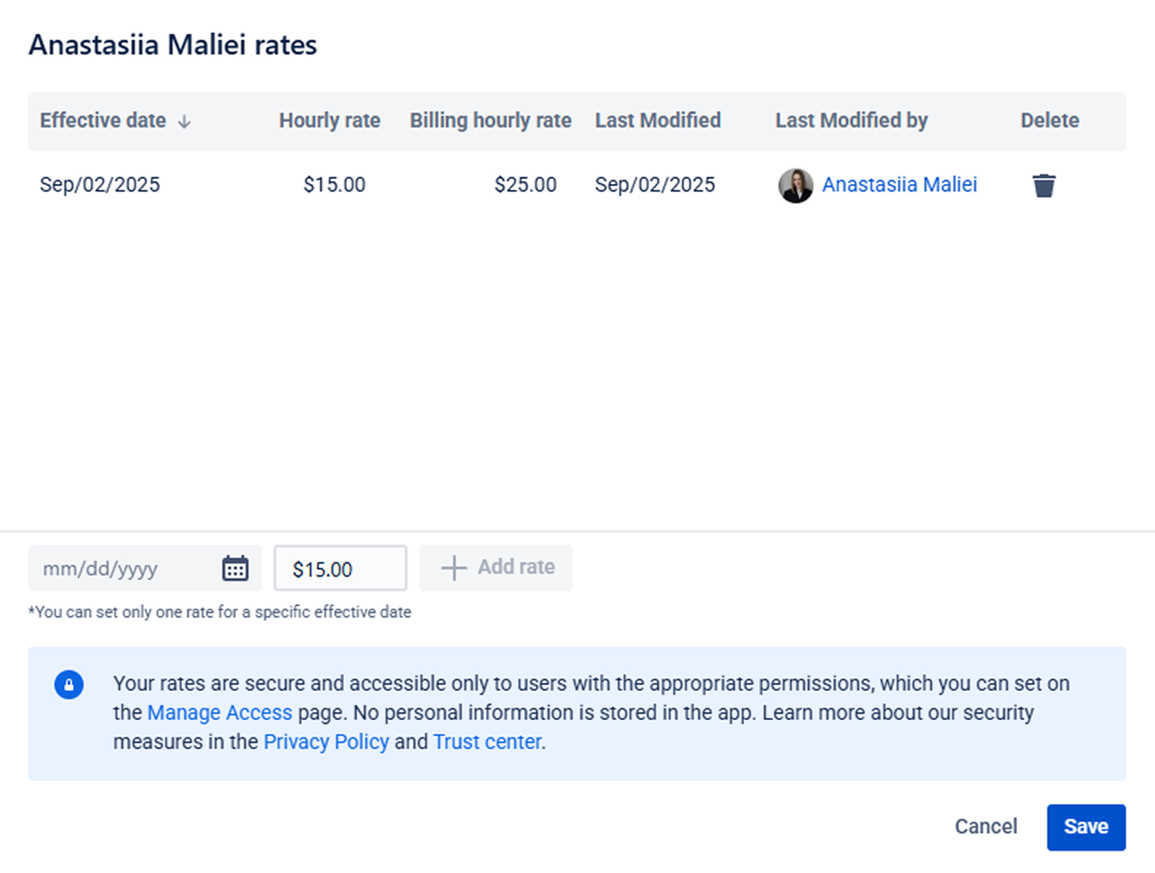

Step 3 — Set rates once
- Team → Rates: set the internal and external (billing) rates for every team member who works with clients.
💡 Effective date — is the date when a certain rate is agreed with an employee. All work logs are then multiplied by the rate that was active on that date.
For example:
- In January 2021, an employee logged 100 hours with a $40 rate.
- Starting from February 1, based on the agreement, the rate was increased to $45.
Thus, all logs until February are multiplied by $40, and all logs from February onward are multiplied by $45.
👉 For accurate calculation, make sure to add rates carefully according to their effective dates.

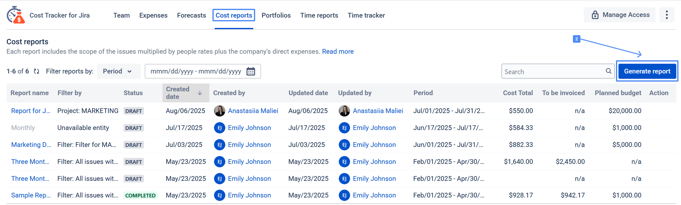

Step 4 — Generate a Cost report
- Cost reports → Create report

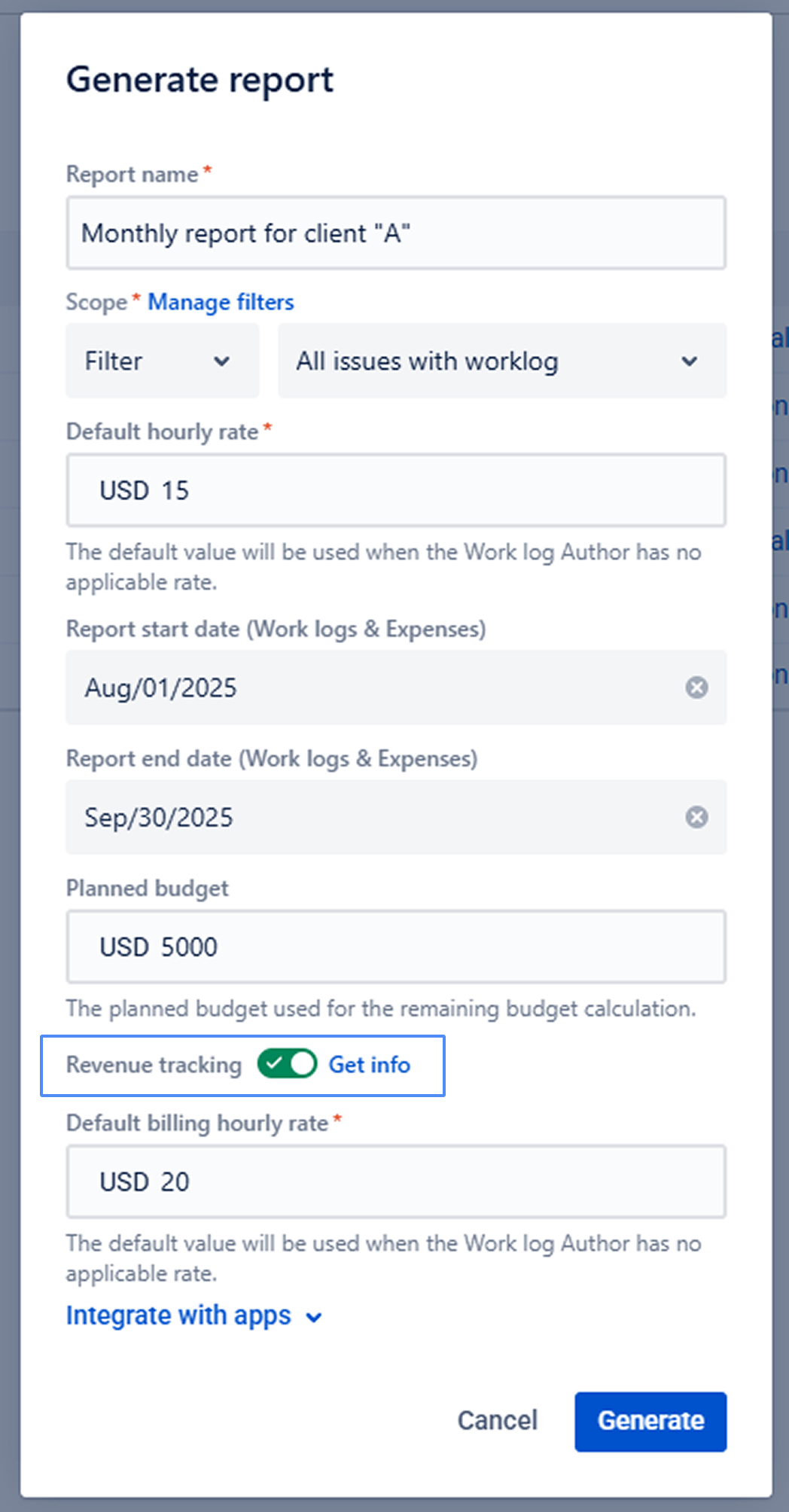

- Pick the scope filter and billing period (e.g., last month)
- Enable Revenue tracking ✅ and set the Default billing hourly rate
💡 To generate the invoice, specify the billing period's start and end dates. The system will then retrieve all work logs for that period and calculate the costs by multiplying the hours logged by their respective rates. This process ensures an accurate and straightforward invoicing system.

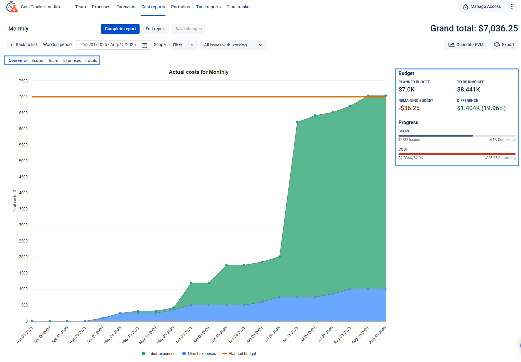

Step 5 — Review Report Data
Once you generate the report, you’ll see multiple tabs with detailed financial insights:
Overview tab – gives you a high-level summary of project costs and progress.
On the chart, you’ll see how costs accumulate over time compared to the planned budget.
On the right-hand panel, you can track the planned budget, remaining budget, total to be invoiced and profitability difference.
The progress bar shows how much of the scope is completed vs. how much budget has been spent.
This tab is great for quickly assessing whether your project is on track financially and in terms of delivery.

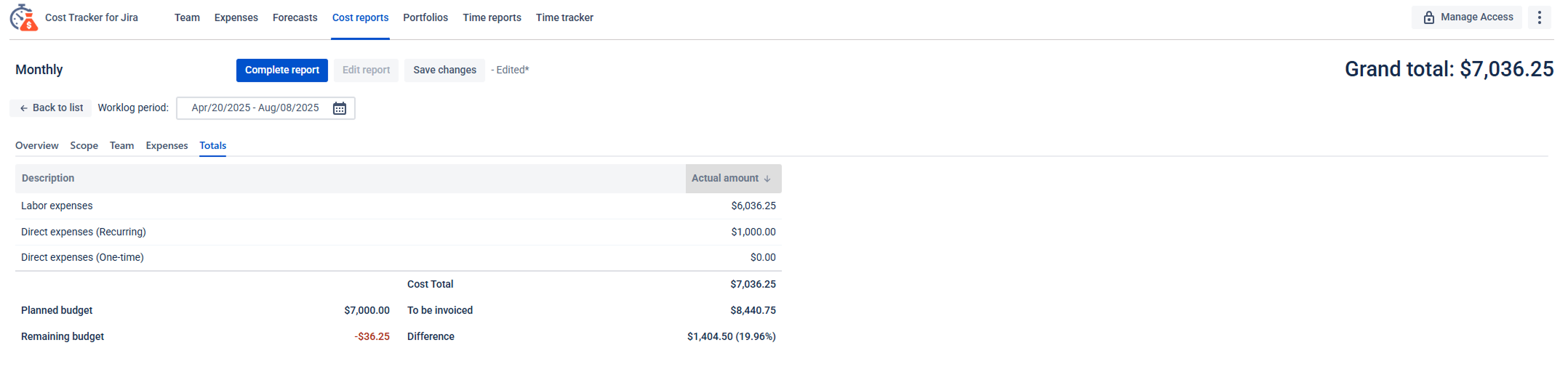

Totals tab – consolidates all financial data:
Costs total – your internal spending.
To be invoiced – what you’ll bill to your client.
Difference – the profitability margin (i.e., revenue vs. cost).
Planned budget vs. Remaining budget.
