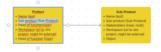

- Object types are boxes. I like to use "Rectangles" colored in yellow. Write the name of the Object Type in bold and list the attributes as a bullet list. Notice how I write the attribute type by the name. As a general recommendation, let the first attribute be the object type label. Also, if you reference another object, use the object type name as the attribute type.
- Whenever your objects are related, create arrows between them: The rule goes as follows: The object that contains the related object has an arrow outgoing towards the referenced object.

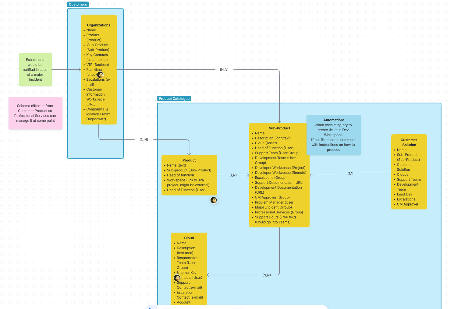

A real example

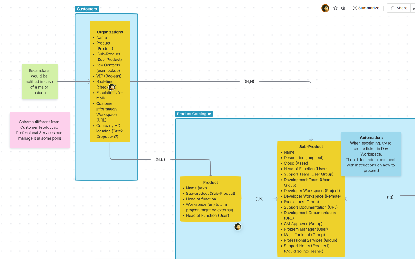

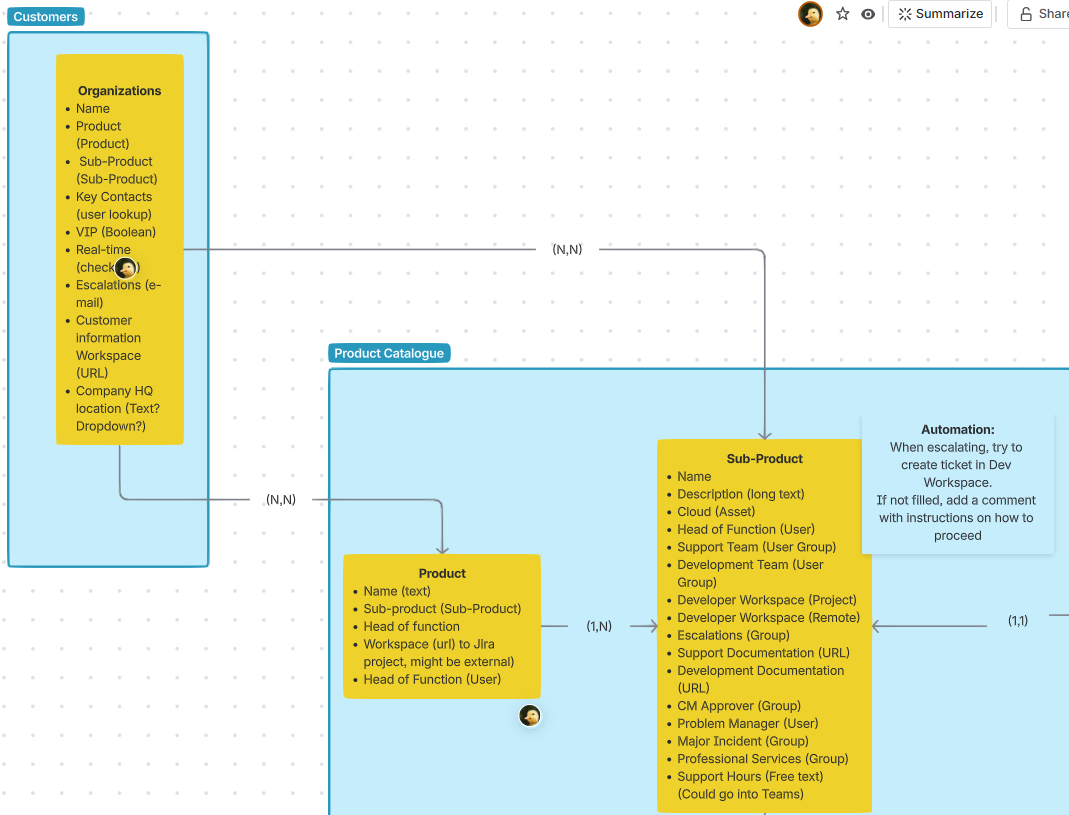

Recently I designed toguether with a colleague and a client a small database whose aim was:
- Keeping track of how many clients the company had
- Keeping track of the Products this customers had purchased
- Keeping a catalogue of Products and their modules.
- Cataloguing all their hosting, key stakeholders, support groups, etc for an ITSM service
- Automating assignments according to which customer opened tickets in JSM, as the routing could depend on which products they had purchased.
I might write another article outlining my best practices on designing Assets databases. This time around, let's just see the final diagram without zooming in. (Don't worry, I made sure to ask for permission before reposting this)
