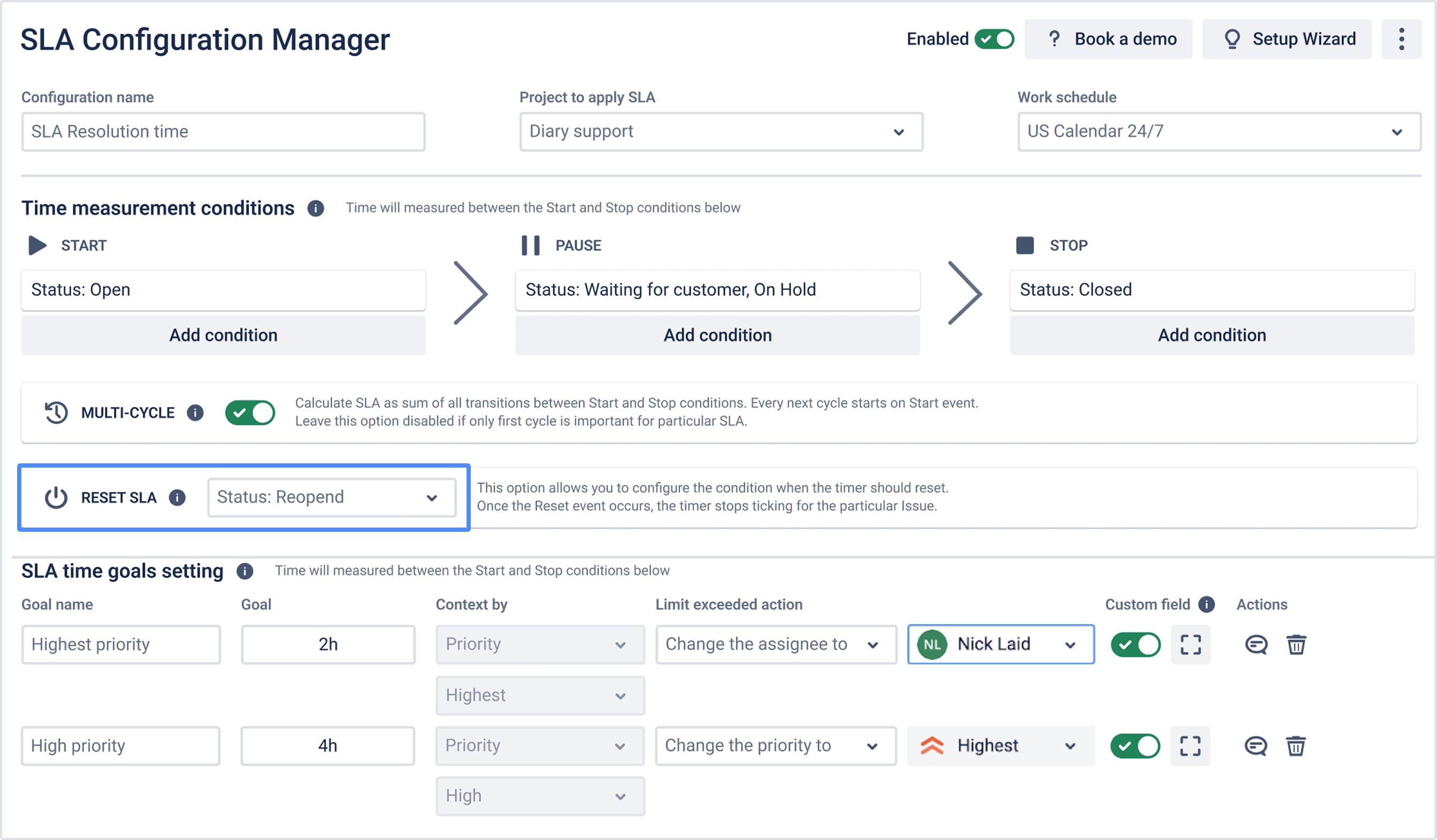

✅ After: Visual debugging and quick fix with SLA Time and Report
With SLA Time and Report, you just:

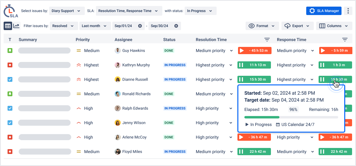

- Open the issue in the app
- Instantly see the SLA timeline, including exact start and stop points
- Notice the SLA hasn’t stopped after “Resolved”
- Use the Reset SLA button to stop it or apply logic-based corrections
Even better? You can filter and batch fix similar issues across your queue, using visual indicators and SLA filters like:
- SLA Status = In Progress
- Final Status = Resolved
