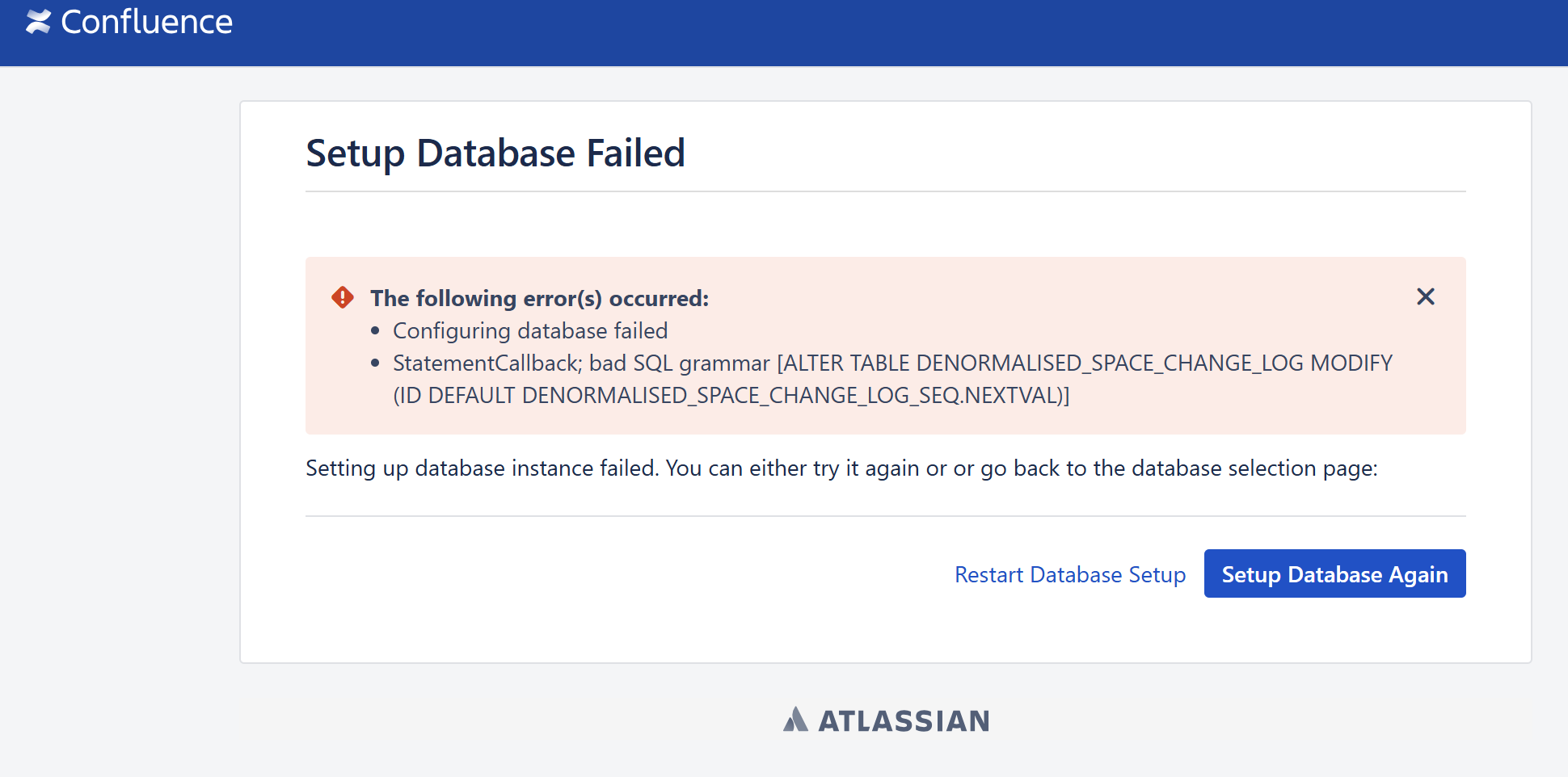

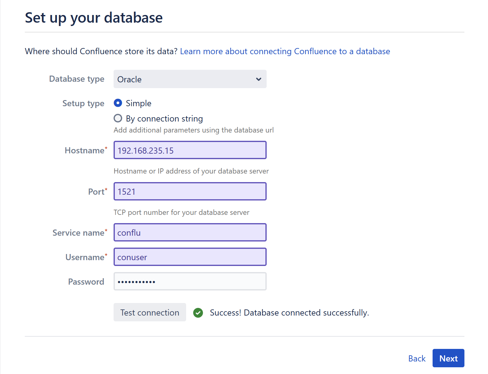

I am installing Confluence Datacenter 9.2.5 and Datacenter 9.2.4, and choose Oracle as the database. When the program is create the database, then the bellow error.
Setup Database Failed
The following error(s) occurred:
- Configuring database failed
- StatementCallback; bad SQL grammar [ALTER TABLE DENORMALISED_SPACE_CHANGE_LOG MODIFY (ID DEFAULT DENORMALISED_SPACE_CHANGE_LOG_SEQ.NEXTVAL)]
It seems like bad SQL, but the right SQL such as "ALTER TABLE DENORMALISED_SPACE_CHANGE_LOG MODIFY ID DEFAULT DENORMALISED_SPACE_CHANGE_LOG_SEQ.NEXTVAL".
