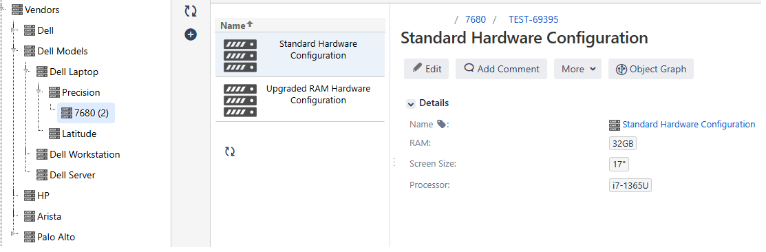

I'm not sure if I'm being clear, but the configuration object might look a little like this:

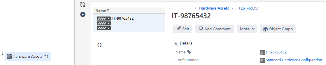

Then the HW asset might look like this:

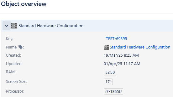

The problem with this is obviously that you lose all of the values within the "tree" of object types. In fact, the values of the Configuration Type object are gone themselves, although they can be displayed by clicking the configuration object, but you still don't have any record of the object types above "7680" in the example given, and even then the HW asset doesn't "know" it's a 7680 (much less Precision, Laptop, or Dell), it only knows the hardware configuration of the 7680.
