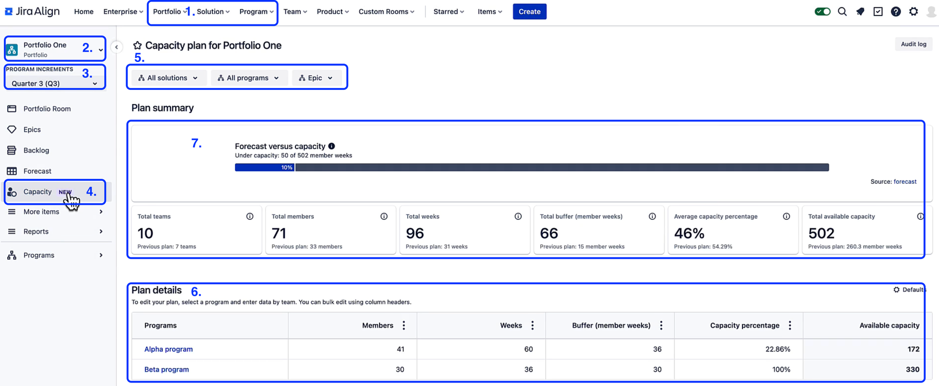

- Begin by navigating to the capacity page, which can be accessed through the portfolio, solution (if applicable), or program context using the top navigation bar.
- Our goal is to develop the capacity plan for the entire portfolio within our program increment. Therefore, we will start at the portfolio level and select “Portfolio One.” Next, choose the upcoming program increment from the sidebar
- We will focus on the capacity for our “Q3” program increment.
- Finally, select the capacity option from the sidebar, located just below the forecast.
- The filters allow you to narrow down the data on the page to specific programs. Since we initiated from the portfolio level, we can view child team levels.
- At the bottom, you will find the plan details, which provide a spreadsheet-like experience where the real work occurs. Managers and other planning leaders input information about their specific programs and teams into the table.
- The plan summary displays all aggregated data along with a helpful visual representation of your capacity status, indicating whether you are above or below capacity compared to your forecasted work.

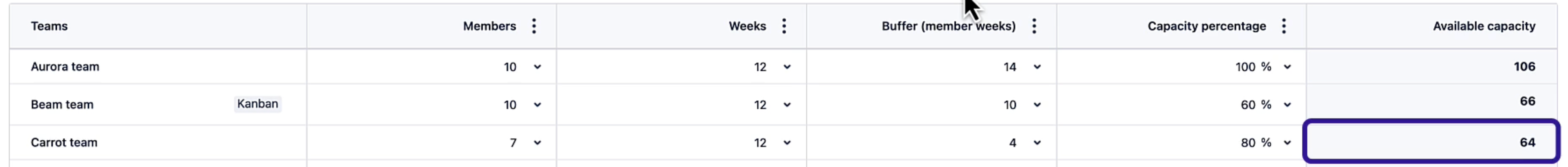

Observe how the columns in the table correspond to the four components used to assess capacity: member weeks, buffer member weeks, and capacity percentage. At this level, we cannot edit individual cells since each team within the program has distinct values. Therefore, let's select the program on the left to examine the teams within it. This view is collaborative, and several team leaders have already populated the data. By hovering over each cell, we can access detailed information about each entry's data source, author, and timestamp.
Next, let's input the capacity values for the carrot team. There are four methods to enter data for a capacity plan:
Manual Entry: This is the method we will use for all of the team’s capacity values. We know that the team will consist of 7 members when the Program Increment (PI) begins, so we will enter 7 in the members' cell. The team will be working throughout the entire PI, which lasts for 12 weeks. However, 4 members will be on vacation for one week. To accommodate this, we will include a buffer of 4 member weeks. Lastly, we need to specify the capacity percentage. Our team anticipates spending 80% of its time on program increment work, with the remaining time allocated to unplanned tasks, such as fixing bugs. At the end of the row, we can now see the calculated available capacity for the team.

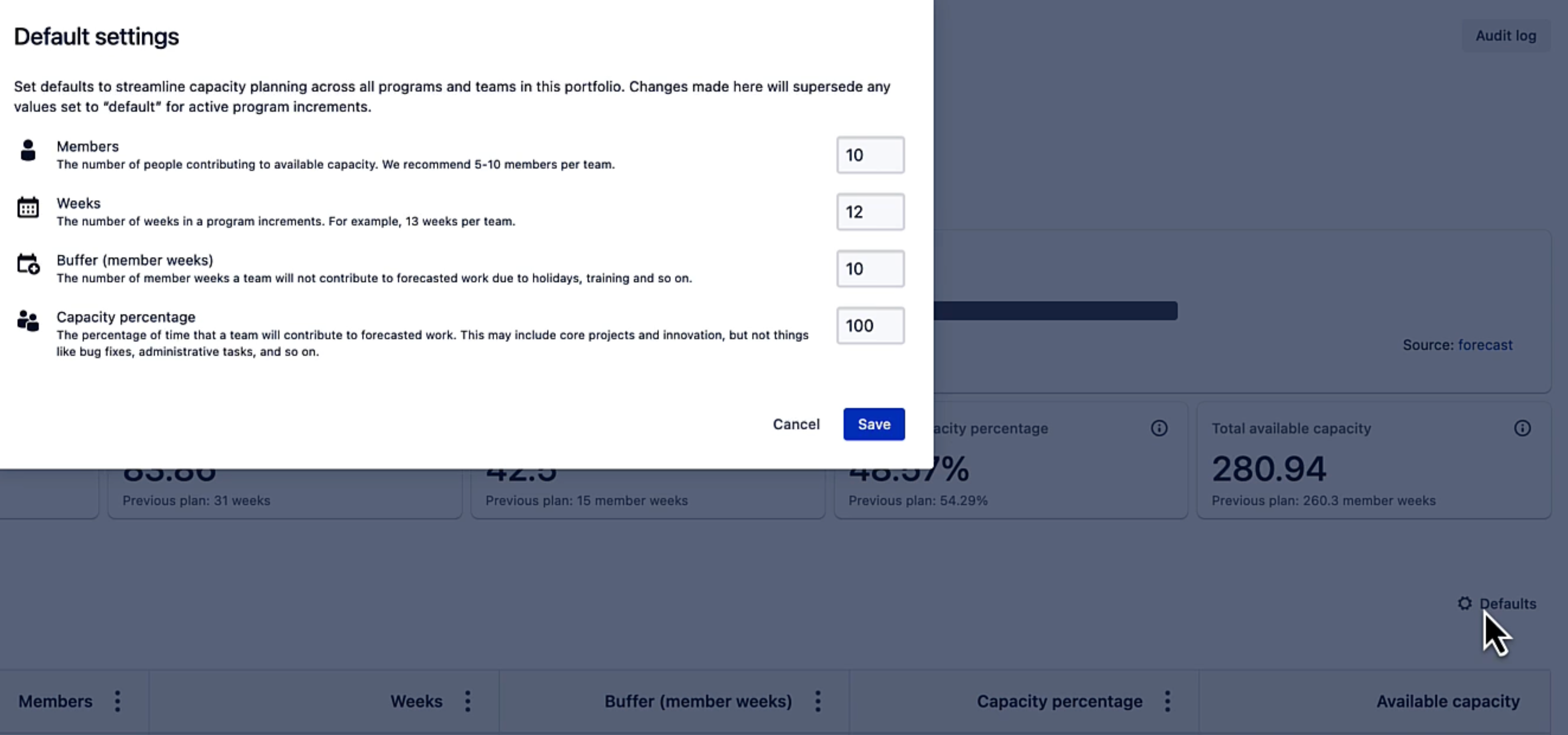

Defaults provide a convenient method for quickly establishing values that are commonly used across all programs and teams.
You can configure defaults by clicking the defaults button located on the page.
The configurations within this section can influence the entire portfolio.
To set or adjust default settings, please ensure that the default permissions toggle is activated for your system role.
To establish a best practice, all teams within the portfolio have collectively agreed to allocate 85% of their time to focus on PI priorities. Consequently, we have adjusted the default allocation from 100% to 85%.

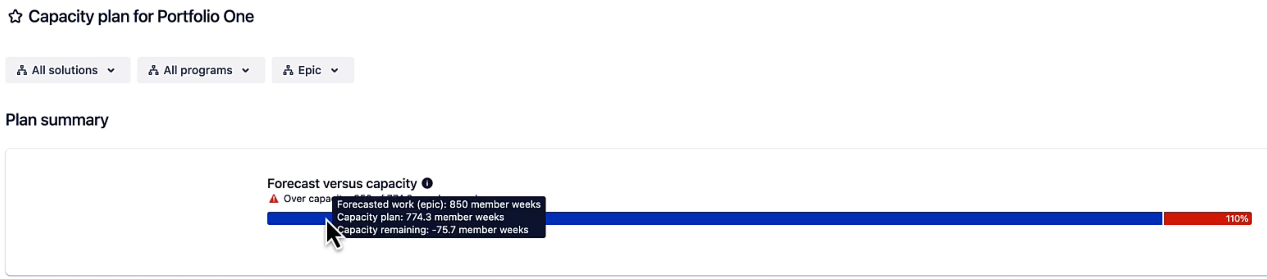

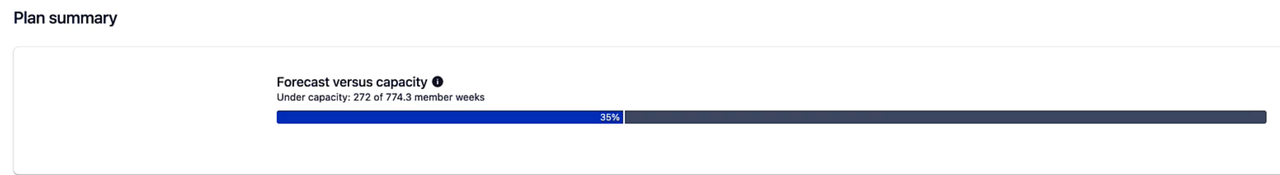

You can view the total number of teams engaged in the Program Increment (PI), along with the aggregated values for each component of the available capacity calculation and the overall available capacity. This available capacity is presented both numerically and visually through a capacity bar. As you input estimates for work in the PI—either via the forecast page or the forecast tab of each work item—the capacity bar will progressively fill up.

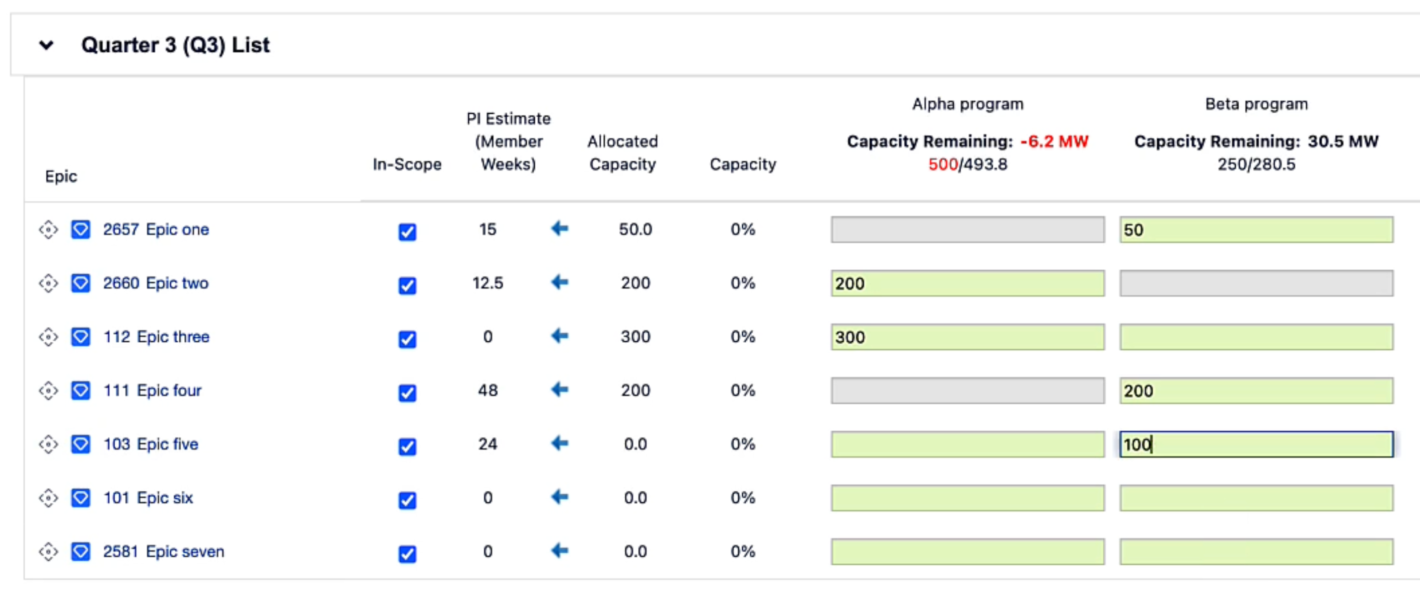

To begin, select the link on the forecast page to assess the planned work. We will utilize the program at our team level on this page to estimate for epics. You will notice that the same two PIs from our capacity plan correspond with the available capabilities.
We need to incorporate some estimates into these epics.
On the capacity page, you will observe that the capacity bar reflects our estimates. By hovering over the bar, you can view a detailed breakdown of capacity versus forecast estimates. Currently, we have exceeded our available capacity, which necessitates the removal of an epic from our Program Increment (PI). To address this, we must explore options to either break down an epic and reduce its estimate or identify strategies to enhance our capacity.

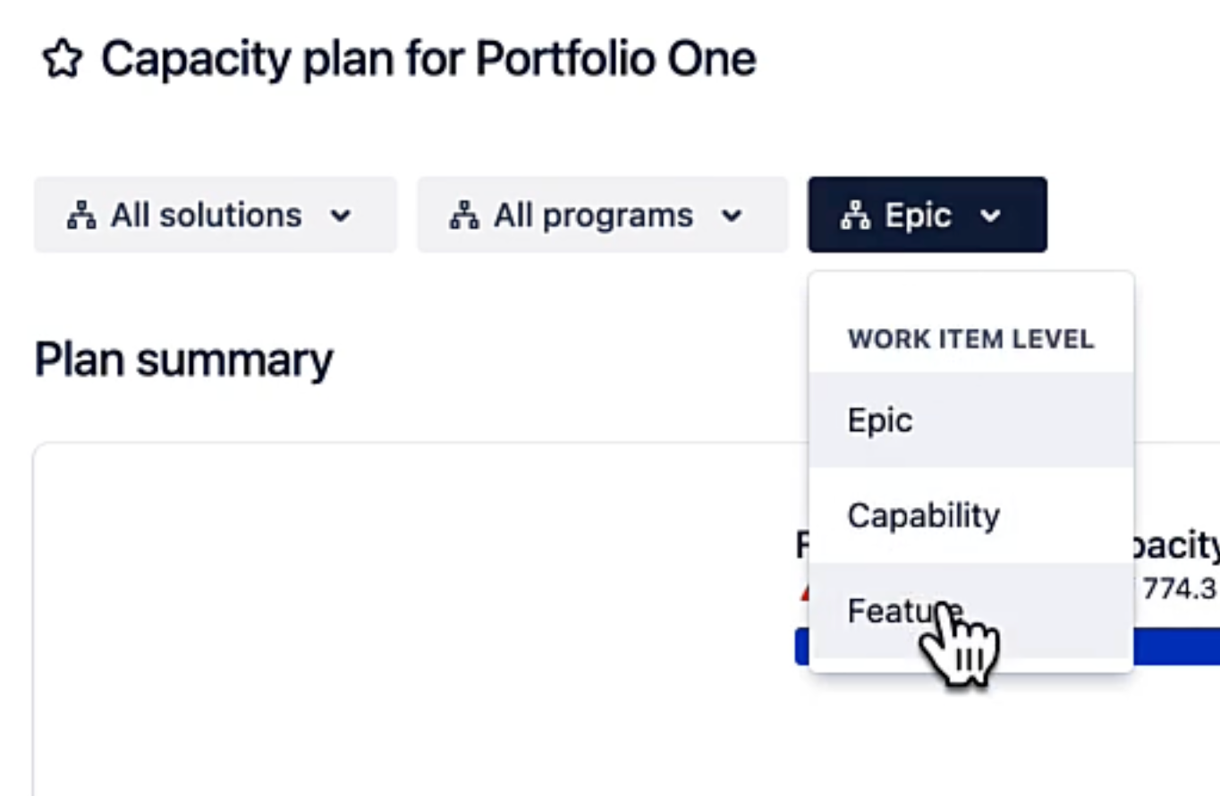

We can also evaluate our capacity by comparing it with the features we have previously estimated. This can be done by modifying the work item using the filter located at the top.
The capacity bar now displays the total amount of capacity utilized for feature work.
