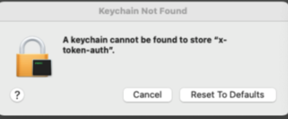

What happens is, when it tries to “git clone” the project the Mac Mini gets this dialog “Keychain not found - A keychain cannot be found to store ‘x-token-auth’”
So if I press the cancel button, it continues working as expected.
I tried giving permission to all apps in the keychain to the bitbucket.org internet password, but nothing changed. I tried unlocking the system and login keychain, also no change.
