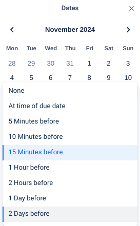

Part 2 - Understand how the reminders work
This is what you see but if you peek behind the scenes👀, Trello is setting these values in minutes, like below:
- None = -1
- At time of due date = 0
- 5 Minutes before = 5
- 10 Minutes before = 10
- 15 Minutes before = 15
- 1 Hour before = 60
- 2 Hours before = 120
- 1 Day before = 1440
- 2 Days before = 2880
Now you know this important information, my automation is going to show you how to set the reminder to 1 hour before (60), you can change the automation to your preferred choice.

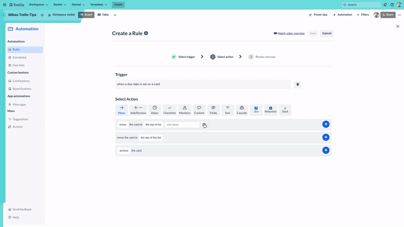

Step 1 - Create the Trigger
For this, we are going to use the trigger
when a due date is set on a card
Step 2 - Create the Action

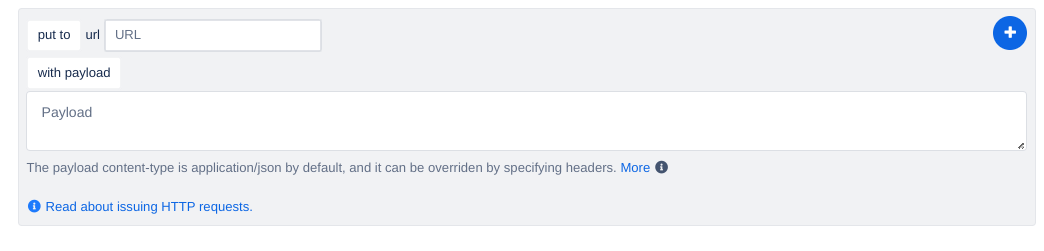

- Go to the Content Actions Page and scroll to the bottom to find the HTTP request action
- Set the action in the drop down to put to
- In the URL below, replace the text PASTEYOURAPIKEYHERE with the API you saved earlier and PASTEYOURTOKENHERE with the Token you saved earlier.\
https://api.trello.com/1/cards/{cardid}?key=PASTEYOURAPIKEYHERE&token=PASTEYOURTOKENHERE
- Copy and paste the URL from number 3 above into the URL field
- Paste the following payload into the Payload field
{"dueReminder": "60"}
Note: if you want to change the reminder time, here is the place to do it, so if you want it to be 1 day, you can replace 60 with 1440
