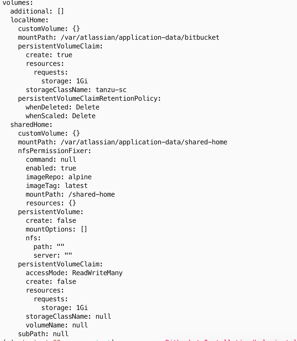

Below are is my values.yaml file for the volume configuration part:
Events: Type Reason Age From Message ---- ------ ---- ---- ------- Warning FailedCreate 8m21s (x31 over 3h50m) statefulset-controller create Pod bitbucket-geroge-0 in StatefulSet bitbucket-geroge failed error: Pod "bitbucket-geroge-0" is invalid: spec.initContainers[0].volumeMounts[0].name: Not found: "shared-home"
https://github.com/atlassian/data-center-helm-charts/blob/c0bb8bcf25a6fed259c84395592c3eb344b67dfe/src/main/charts/bitbucket/values.yaml#L203
