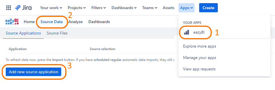

Adding a new Data Source to eazyBI
In the Jira Apps menu:
- select eazyBI
- Switch to Source Data tab
- Click on the Add new source application button.

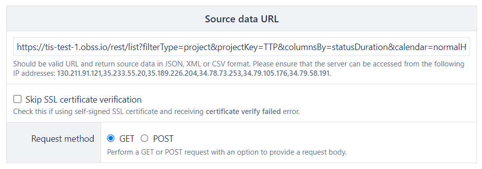

Source Data URL
You enter the Timepiece Reporting URL (mentioned above) as the "Source data URL" and select a "GET" request.

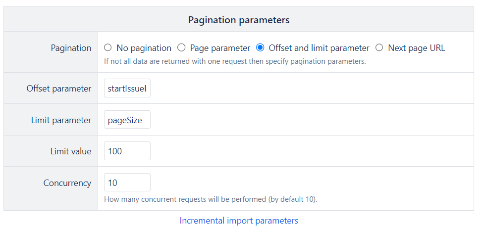

Pagination
Timepiece REST API will provide issues in pages of 100 so the integration will need to run with paging.
- For "Pagination", select the "Offset and limit parameter" option.
- For "Offset parameter", enter "startIssueIndex".
- For "Limit parameter", enter "pageSize".
- For "Limit value", enter "100".
- For "Concurrency", you can leave the default value "10".

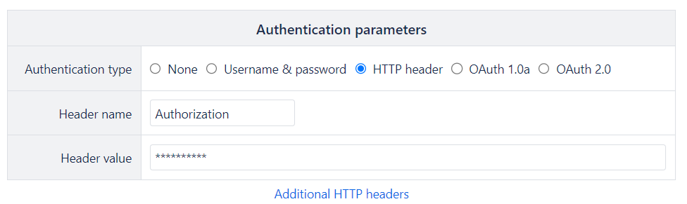

Authentication
For authentication, you'll first need to get a Timepiece REST API token as described in the API Settings page. After you get the API token,
- For "Authentication type", select "HTTP Header".
- For "Header Name", enter "Authorization".
- For "Header Value", enter "TISJWT <your_api_token>" and replace the "<your_api_token" with the actual API token you created in the API Settings page.

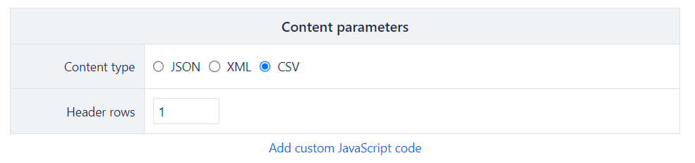

Content Parameters
- For Content Parameters, set the "Content type" to "CSV"
- For "Header Rows", enter "1", as all the CSV responses from Timepiece REST API will contain a header row.

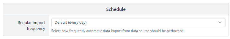

Schedule
You can set the schedule according to your needs.

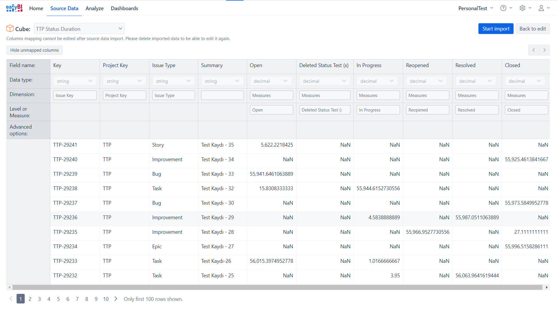

Next steps
Once the data source is configured and imported, you will map the Timepiece data to the appropriate dimensions and measures within eazyBI.
After completing these mappings, click the "Start Import" button to finalize the setup.
You have now successfully integrated Timepiece - Time in Status for Jira data with eazyBI, enabling comprehensive analysis and reporting of your time-tracking metrics alongside other data sources.
