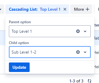

As for Reporting it's fairly straight forward, especially in the Basic issue search:
JQL: "cascading list[select list (cascading)]" in cascadeOption(10067, 10070)
