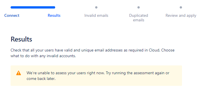

ASSESS AND PREPARE YOUR USERS
When trying to assess and prepare the users I get an error:
I used the same user (email) on-prem and in the cloud. They are admins on both sites.
Furthermore it sometimes throws this exception in the catalina.out a while after clicking to beginn the assessment:
Exception in thread "com.atlassian.migration.agent.service.analytics.AnalyticsEventService:thread-46" com.atlassian.migration.agent.service.encryption.exception.EncryptionException: Encryption Config has gone corrupt
at com.atlassian.migration.agent.service.encryption.EncryptionConfigHandler.getKeyLocationFromConfig(EncryptionConfigHandler.java:60)
at com.atlassian.migration.agent.service.analytics.AnalyticsEventBuilder.buildCompletedInstanceAnalysisAnalyticsEvent(AnalyticsEventBuilder.java:495)
at com.atlassian.migration.agent.rest.StatisticsResource.lambda$getServerStatistics$0(StatisticsResource.java:55)
at com.atlassian.migration.agent.service.analytics.AnalyticsEventService.lambda$saveAnalyticsEventAsync$0(AnalyticsEventService.java:75)
at com.atlassian.migration.agent.service.analytics.AnalyticsEventService.lambda$saveAnalyticsEvents$1(AnalyticsEventService.java:80)
at com.atlassian.migration.agent.logging.LoggingContextAwareExecutorService.lambda$execute$3(LoggingContextAwareExecutorService.java:104)
at java.base/java.util.concurrent.ThreadPoolExecutor.runWorker(Unknown Source)
at java.base/java.util.concurrent.ThreadPoolExecutor$Worker.run(Unknown Source)
at java.base/java.lang.Thread.run(Unknown Source)
Caused by: java.lang.NullPointerException
at com.atlassian.migration.agent.service.encryption.EncryptionConfigHandler.getKeyLocationFromConfig(EncryptionConfigHandler.java:58)
... 8 more

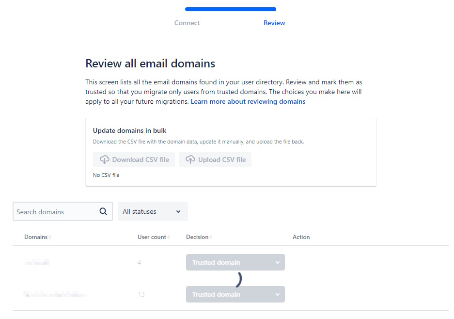

REVIEW ALL EMAIL DOMAINS
When I click on review all email domains this starts to turn perpetually:
Yesterday I managed to select the domains as trusted, however that does not change anything.
While this is working in the GUI these warnings get reported in catalina.2024-01-11.log (I redacted the server name and GUID):
11-Jan-2024 13:44:35.639 WARNING [Catalina-utility-2] org.apache.catalina.valves.StuckThreadDetectionValve.notifyStuckThreadDetected Thread [https-jsse-nio-8091-exec-24] (id=[284]) has been active for [60,505] milliseconds (since [1/11/24 1:43 PM]) to serve the same request for [https://***.local:8091/rest/migration/latest/email/blocked-domains/<GUID>] and may be stuck (configured threshold for this StuckThreadDetectionValve is [60] seconds). There is/are [1] thread(s) in total that are monitored by this Valve and may be stuck.

I hope someone recognizes these problems and can help me resolving them.
Thanks and greets!
