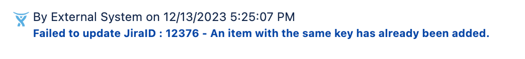

This article describes how to proceed when a Jira Align work Item (e.g. a Story or a Feature) is not syncing with Jira anymore, and the following error message can be seen in its audit log:
By External System on <date> <time>
Failed to update JiraID : XXXX - An item with the same key has already been added

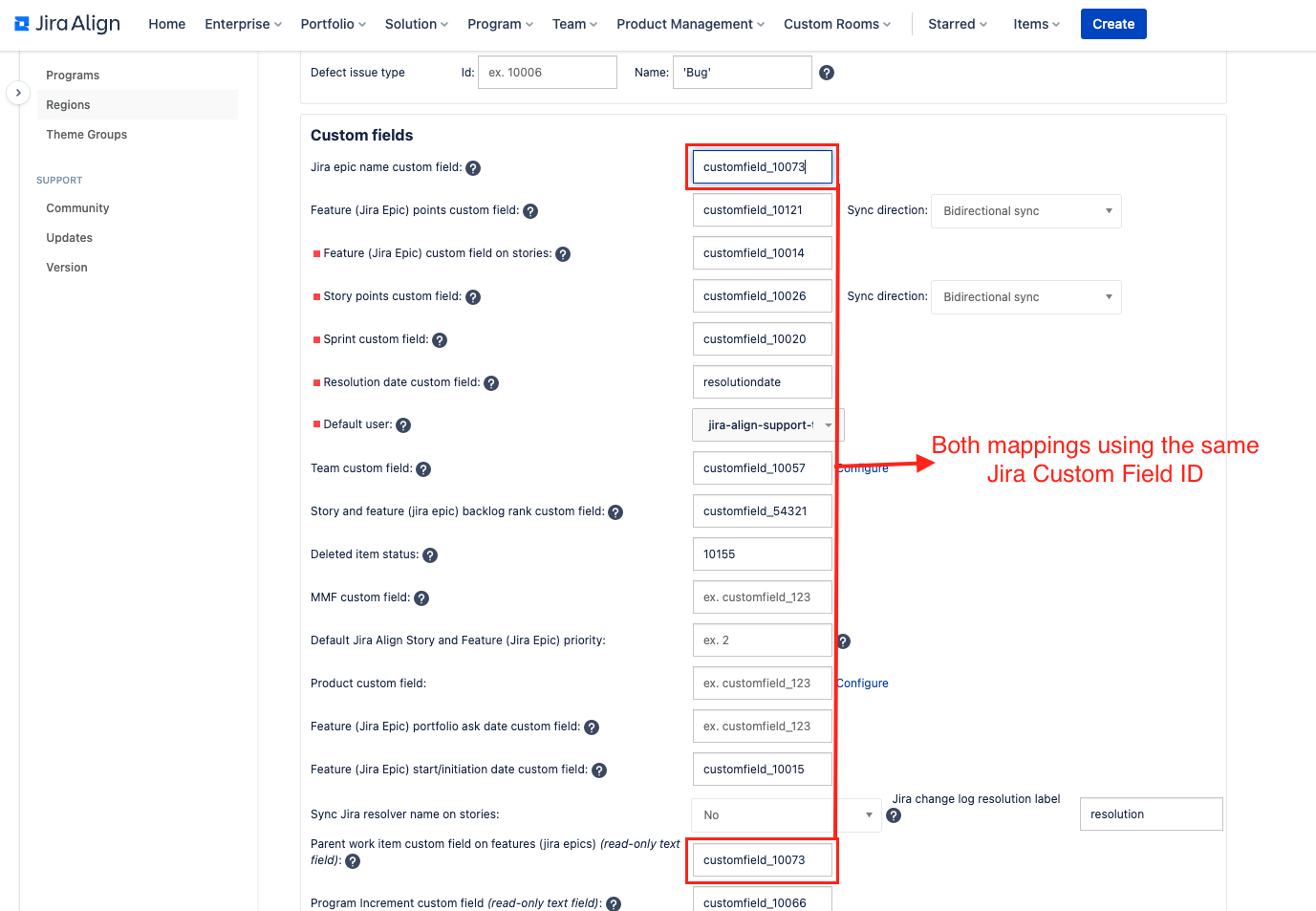

Now in the Custom Fields take a closer look for duplicates customfield_xxxxx mappings, like the example below:
Note: If you don’t find duplicates here take a look in the Field management Tab
Now you have found the duplicate, remove or adjust it according your needs
Hit the Save button at the end of the page
