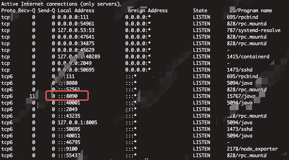

We checked the server port:

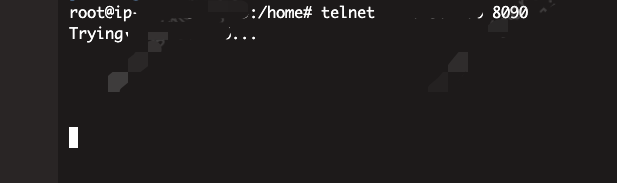

Checked the NG network:
not reachable, but before we use the 7.17.4 version, all things are fine.
