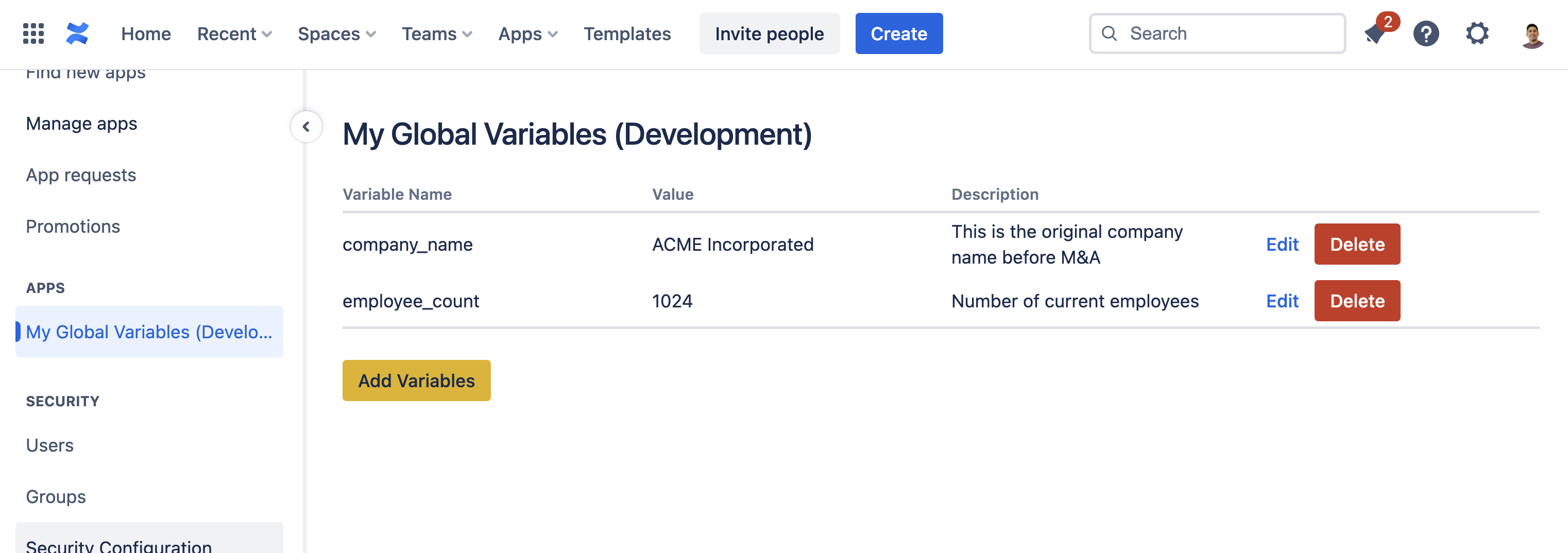

It’s always a nice feeling to see and validate our progress so let’s do that right now! If you’re thinking, “but we just run a number of commands in the CLI, is this a working app now?”, the short answer is YES 🙂. Even without adding the Table component in the previous step, the app generated by forge create is already a working app.
To deploy and install the app in your instance, follow these steps:
Change to your project directory e.g., cd My-Global-Variables
Run the command forge deploy to package the app files and deploy them to the development environment by default.
Run forge install to install the app in your Confluence Cloud instance. Key in your instance URL {yourInstanceName}.atlassian.net when prompted, and give consent to the read:me scope when asked.
To view the app, go to cog > APPS > My Global Variables (Development). It should look something like this.

Now, that should complete the global variable’s configuration page. To test it out go to your command line and run the following commands:
forge deploy - to package and deploy the updated app files
forge install --upgrade - since there are changes in the manifest.yml when you added the storage scope, this call is required for the changes to take effect
After running the two commands successfully, it is time to look at your current progress and test it out. The three buttons should work as expected, modal dialogs will be displayed, and the values are now being stored. Great work so far!

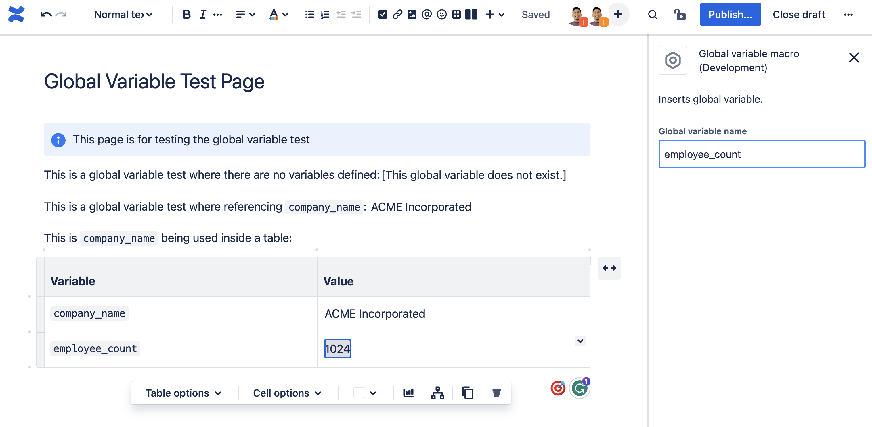

Step 5: Build an inline macro to display your variables
Since variable storage is done, we need a way to retrieve these values and display them on a page or blog. For us to do this, we can use the Macro UI kit component.

The last step is to export the components so they can be referenced by the function handlers.
export const runMacro = render(
<Macro
app={<AppMacro />}
export const configMacro = render(
<ConfigMacro />
Since we used new UI kit components and a hook – MacroConfig, Macro, and useConfig, be sure to import them.
import ForgeUI, { render, Fragment, Text, GlobalSettings, Table, Head,
Cell, Row, Button, useState, ModalDialog, Form, TextField,
useConfig, MacroConfig, Macro } from '@forge/ui';
With all the changes done, let’s do another round of forge deploy and forge install --upgrade for the changes to take effect in our current installation. Once done, you can create a page and test it out!
Note: For reference, the variables are set in the previous section above.
