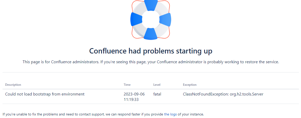

I have a confluence macro that is not working fine in Confluence version 7.x
Now I am going to upgrade my macro to support confluence 8.x (8.5.0), I am facing a few issues while upgrading it.

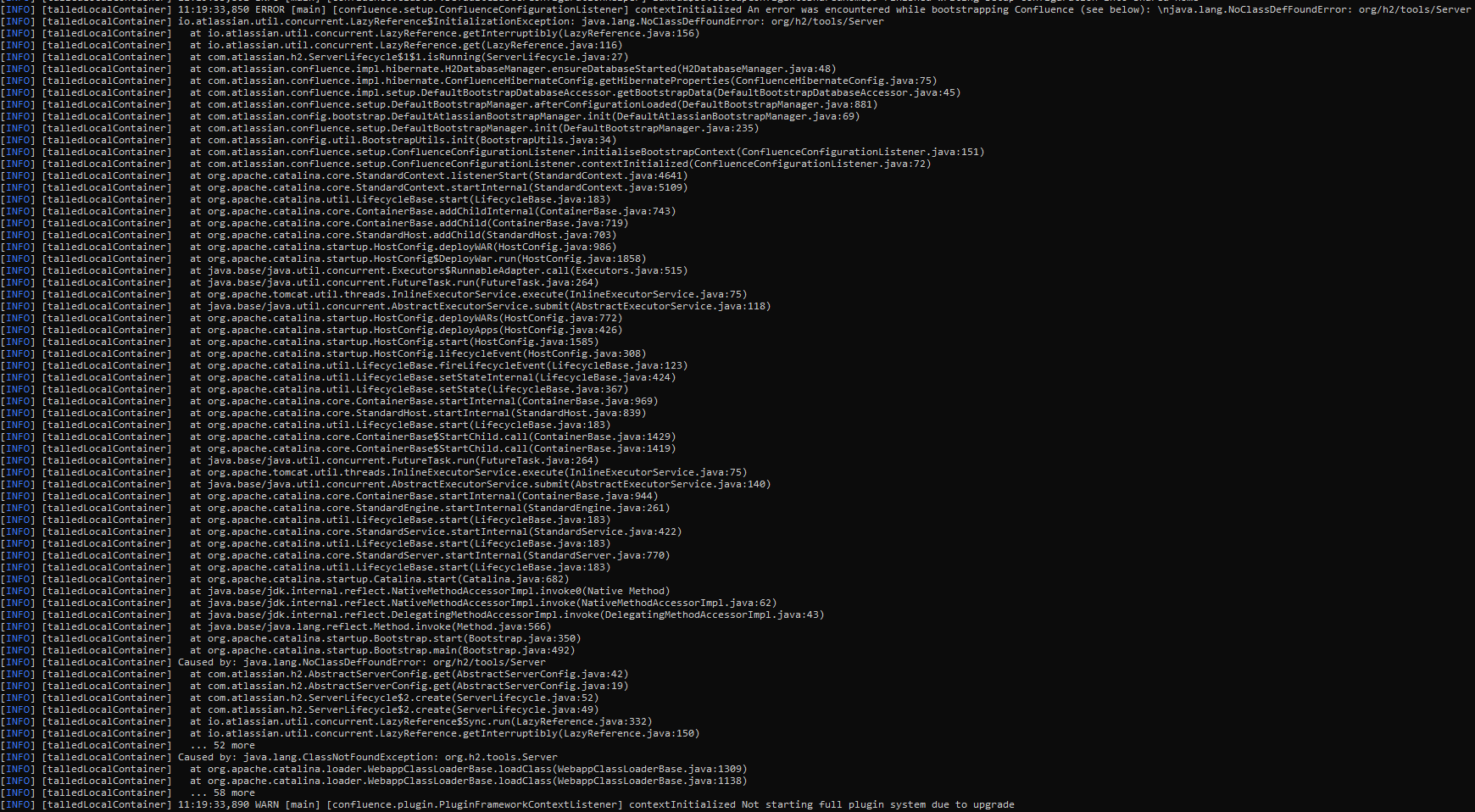

After updating all the plugins to the latest version, when I run atlas-run I get the following error
[INFO] [talledLocalContainer] io.atlassian.util.concurrent.LazyReference$InitializationException: java.lang.NoClassDefFoundError: org/h2/tools/Server
[INFO] [talledLocalContainer] at io.atlassian.util.concurrent.LazyReference.getInterruptibly(LazyReference.java:156)
[INFO] [talledLocalContainer] at io.atlassian.util.concurrent.LazyReference.get(LazyReference.java:116)
[INFO] [talledLocalContainer] at com.atlassian.h2.ServerLifecycle$1$1.isRunning(ServerLifecycle.java:27)
[INFO] [talledLocalContainer] at com.atlassian.confluence.impl.hibernate.H2DatabaseManager.ensureDatabaseStarted(H2DatabaseManager.java:48)
[INFO] [talledLocalContainer] at com.atlassian.confluence.impl.hibernate.ConfluenceHibernateConfig.getHibernateProperties(ConfluenceHibernateConfig.java:75)
[INFO] [talledLocalContainer] at com.atlassian.confluence.impl.setup.DefaultBootstrapDatabaseAccessor.getBootstrapData(DefaultBootstrapDatabaseAccessor.java:45)
[INFO] [talledLocalContainer] at com.atlassian.confluence.setup.DefaultBootstrapManager.afterConfigurationLoaded(DefaultBootstrapManager.java:881)
[INFO] [talledLocalContainer] at com.atlassian.config.bootstrap.DefaultAtlassianBootstrapManager.init(DefaultAtlassianBootstrapManager.java:69)
[INFO] [talledLocalContainer] at com.atlassian.confluence.setup.DefaultBootstrapManager.init(DefaultBootstrapManager.java:235)
[INFO] [talledLocalContainer] at com.atlassian.config.util.BootstrapUtils.init(BootstrapUtils.java:34)
[INFO] [talledLocalContainer] at com.atlassian.confluence.setup.ConfluenceConfigurationListener.initialiseBootstrapContext(ConfluenceConfigurationListener.java:151)
[INFO] [talledLocalContainer] at com.atlassian.confluence.setup.ConfluenceConfigurationListener.contextInitialized(ConfluenceConfigurationListener.java:72)
[INFO] [talledLocalContainer] at org.apache.catalina.core.StandardContext.listenerStart(StandardContext.java:4641)
[INFO] [talledLocalContainer] at org.apache.catalina.core.StandardContext.startInternal(StandardContext.java:5109)
[INFO] [talledLocalContainer] at org.apache.catalina.util.LifecycleBase.start(LifecycleBase.java:183)
[INFO] [talledLocalContainer] at org.apache.catalina.core.ContainerBase.addChildInternal(ContainerBase.java:743)
[INFO] [talledLocalContainer] at org.apache.catalina.core.ContainerBase.addChild(ContainerBase.java:719)
[INFO] [talledLocalContainer] at org.apache.catalina.core.StandardHost.addChild(StandardHost.java:703)
[INFO] [talledLocalContainer] at org.apache.catalina.startup.HostConfig.deployWAR(HostConfig.java:986)
[INFO] [talledLocalContainer] at org.apache.catalina.startup.HostConfig$DeployWar.run(HostConfig.java:1858)
[INFO] [talledLocalContainer] at java.base/java.util.concurrent.Executors$RunnableAdapter.call(Executors.java:515)
[INFO] [talledLocalContainer] at java.base/java.util.concurrent.FutureTask.run(FutureTask.java:264)
[INFO] [talledLocalContainer] at org.apache.tomcat.util.threads.InlineExecutorService.execute(InlineExecutorService.java:75)
[INFO] [talledLocalContainer] at java.base/java.util.concurrent.AbstractExecutorService.submit(AbstractExecutorService.java:118)
[INFO] [talledLocalContainer] at org.apache.catalina.startup.HostConfig.deployWARs(HostConfig.java:772)
[INFO] [talledLocalContainer] at org.apache.catalina.startup.HostConfig.deployApps(HostConfig.java:426)
[INFO] [talledLocalContainer] at org.apache.catalina.startup.HostConfig.start(HostConfig.java:1585)
[INFO] [talledLocalContainer] at org.apache.catalina.startup.HostConfig.lifecycleEvent(HostConfig.java:308)
[INFO] [talledLocalContainer] at org.apache.catalina.util.LifecycleBase.fireLifecycleEvent(LifecycleBase.java:123)
[INFO] [talledLocalContainer] at org.apache.catalina.util.LifecycleBase.setStateInternal(LifecycleBase.java:424)
[INFO] [talledLocalContainer] at org.apache.catalina.util.LifecycleBase.setState(LifecycleBase.java:367)
[INFO] [talledLocalContainer] at org.apache.catalina.core.ContainerBase.startInternal(ContainerBase.java:969)
[INFO] [talledLocalContainer] at org.apache.catalina.core.StandardHost.startInternal(StandardHost.java:839)
[INFO] [talledLocalContainer] at org.apache.catalina.core.ContainerBase$StartChild.call(ContainerBase.java:1429)
[INFO] [talledLocalContainer] at org.apache.catalina.core.ContainerBase$StartChild.call(ContainerBase.java:1419)
[INFO] [talledLocalContainer] at java.base/java.util.concurrent.AbstractExecutorService.submit(AbstractExecutorService.java:140)
[INFO] [talledLocalContainer] at org.apache.catalina.core.ContainerBase.startInternal(ContainerBase.java:944)
[INFO] [talledLocalContainer] at org.apache.catalina.core.StandardEngine.startInternal(StandardEngine.java:261)
[INFO] [talledLocalContainer] at org.apache.catalina.core.StandardService.startInternal(StandardService.java:422)
[INFO] [talledLocalContainer] at org.apache.catalina.core.StandardServer.startInternal(StandardServer.java:770)
[INFO] [talledLocalContainer] at org.apache.catalina.startup.Catalina.start(Catalina.java:682)
[INFO] [talledLocalContainer] at java.base/jdk.internal.reflect.NativeMethodAccessorImpl.invoke0(Native Method)
[INFO] [talledLocalContainer] at java.base/jdk.internal.reflect.NativeMethodAccessorImpl.invoke(NativeMethodAccessorImpl.java:62)
[INFO] [talledLocalContainer] at java.base/jdk.internal.reflect.DelegatingMethodAccessorImpl.invoke(DelegatingMethodAccessorImpl.java:43)
[INFO] [talledLocalContainer] at java.base/java.lang.reflect.Method.invoke(Method.java:566)
[INFO] [talledLocalContainer] at org.apache.catalina.startup.Bootstrap.start(Bootstrap.java:350)
[INFO] [talledLocalContainer] at org.apache.catalina.startup.Bootstrap.main(Bootstrap.java:492)
[INFO] [talledLocalContainer] Caused by: java.lang.NoClassDefFoundError: org/h2/tools/Server
[INFO] [talledLocalContainer] at com.atlassian.h2.AbstractServerConfig.get(AbstractServerConfig.java:42)
[INFO] [talledLocalContainer] at com.atlassian.h2.AbstractServerConfig.get(AbstractServerConfig.java:19)
[INFO] [talledLocalContainer] at com.atlassian.h2.ServerLifecycle$2.create(ServerLifecycle.java:52)
[INFO] [talledLocalContainer] at com.atlassian.h2.ServerLifecycle$2.create(ServerLifecycle.java:49)
[INFO] [talledLocalContainer] at io.atlassian.util.concurrent.LazyReference$Sync.run(LazyReference.java:332)
[INFO] [talledLocalContainer] at io.atlassian.util.concurrent.LazyReference.getInterruptibly(LazyReference.java:150)

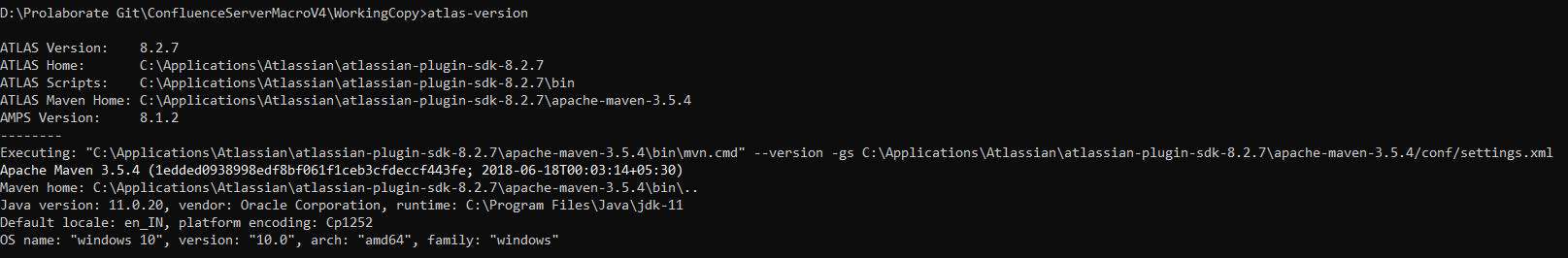

I am using Atlassian SDK - 8.2.7.
My Java version is 11

<properties>
<confluence.version>8.5.0</confluence.version>
<confluence.data.version>8.5.0</confluence.data.version>
<amps.version>8.1.2</amps.version>
<plugin.testrunner.version>2.0.1</plugin.testrunner.version>
<atlassian.spring.scanner.version>1.2.13</atlassian.spring.scanner.version>
<!-- This key is used to keep the consistency between the key in atlassian-plugin.xml and the key to generate bundle. -->
<atlassian.plugin.key>${project.groupId}.${project.artifactId}</atlassian.plugin.key>
<project.build.sourceEncoding>UTF-8</project.build.sourceEncoding>
<maven.compiler.source>11</maven.compiler.source>
<maven.compiler.target>11</maven.compiler.target>
<jvm.args.custom/>
<!-- Allows to specify custom arguments in build scripts -->
<jvm.args.xmx>1024m</jvm.args.xmx>
<jvm.args>-Xmx${jvm.args.xmx} ${jvm.args.custom}</jvm.args>
<containerId>tomcat9x</containerId>
<webdriver.browser>chrome</webdriver.browser>
<atlassian.dev.mode>false</atlassian.dev.mode>
</properties>
I'm not sure what I'm missing, so if anyone can help, that would be great.
Please let me know if you require any additional details from my end.
Any support you can give would be greatly appreciated.
