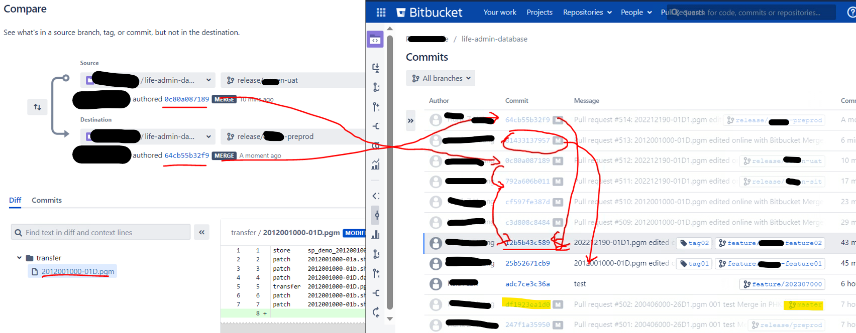

But now we encounter one Diff issue between UAT and PreProd.
For example:
Feature01(25b52671cb9) -> SIT(c3d808c8484) -> UAT(cf597fe387d) via PR Merge, It means Feature a is ready for preprod
After Feature a merged into UAT, do the same thing for feature B
Feature02(12b5b43c589) -> SIT(792a606b011) -> UAT(0c80a087189) via PR Merge, It means Feature b is ready for preprod
At this moment, Diff between SIT & UAT is no changes, SIT and UAT both contains feature01 & feature02, all Diff are expected. Then
Feature01(25b52671cb9) -> PreProd(81322137957) via PR Merge
Now the Diff also is expected, due to feature01 just has been merge into PreProd, so it will only show feature02 diff. but after
Feature02(12b5b43c589) -> PreProd(64cb55b32f9) via PR Merge
Now the result is not expected, Diff shows the code change of Feature01.
Due to Feature01 & 02 have both merged into PreProd, UAT contains Feature01 & 02, so the expectation is Diff shows no changes between UAT & PreProd.
But the final Diff screen share like the following:
BitBucket version: 8.01
Could you help to clarify why? and how to get our expectation?
