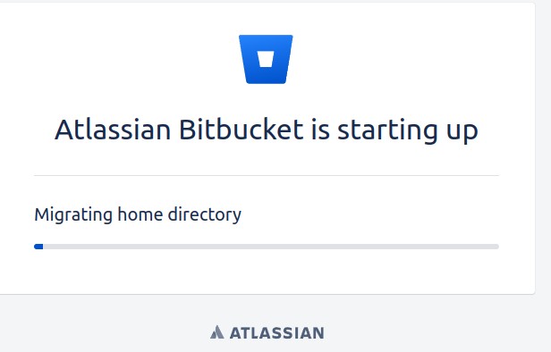

1) The app starts up.
I run the start script and the app starts. Sometimes it gets to the scren shoen in step 3 below, sometimes it immediately fails. When it gets to the "Migrating home directory" screen, the logs are clean and show no errors. Things just seem to stop there. When it fasils, it throws the errors I have listed below.
2) Logs (launcher.log, atlassian-bitbucket.log) either show nothing at all (as in no errors), or when the app fails they show the below java errors. Messages and audit logs show no system or SElinux hiccups.
3) I can connect to the GUI in my browser, and I see it get to "Migrating home directory."
4) That's where things come to a screeching halt.
It's been here for quite some time, and it just doesn't progress. Tried re-starting the app, the server, etc. Nothing.
