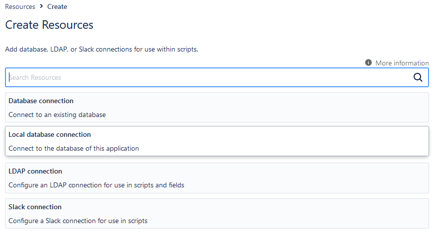

Resource
Create a Resource in ScriptRunner to the Local database and call the Pool name local. No need for any additional script (unless you want).

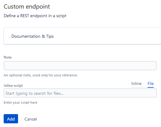

REST Endpoint
Create your custom REST endpoint with the above script either inline or saved in the Script Editor.
