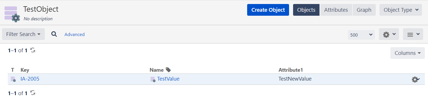

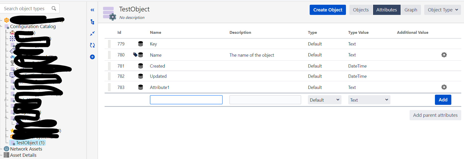

I've created "TestObject" object type (id=85) with attributes: "Name" and "Attribute1" in Insight:
and I have one object there with Key = IA-2005.

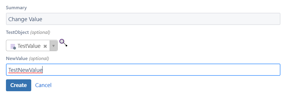

Also I have service in JMS with CustomFields:
- TestObject (customfield_14026) from Insight Test Object
- NewValue (Customfield_14012) text field
So after choosing TestObject and filling text in NewValue fields (and after creation of ticket), I need to update TestValue object from Insight TestObject with attribute1's value, like this:

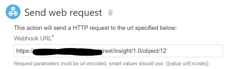

I've tried to create automation rule with web request (web hook), but it requires objectid (id) in the webhook url and which is my IA-2005 and I don't know how to find out the key/id of the appropriate object.
