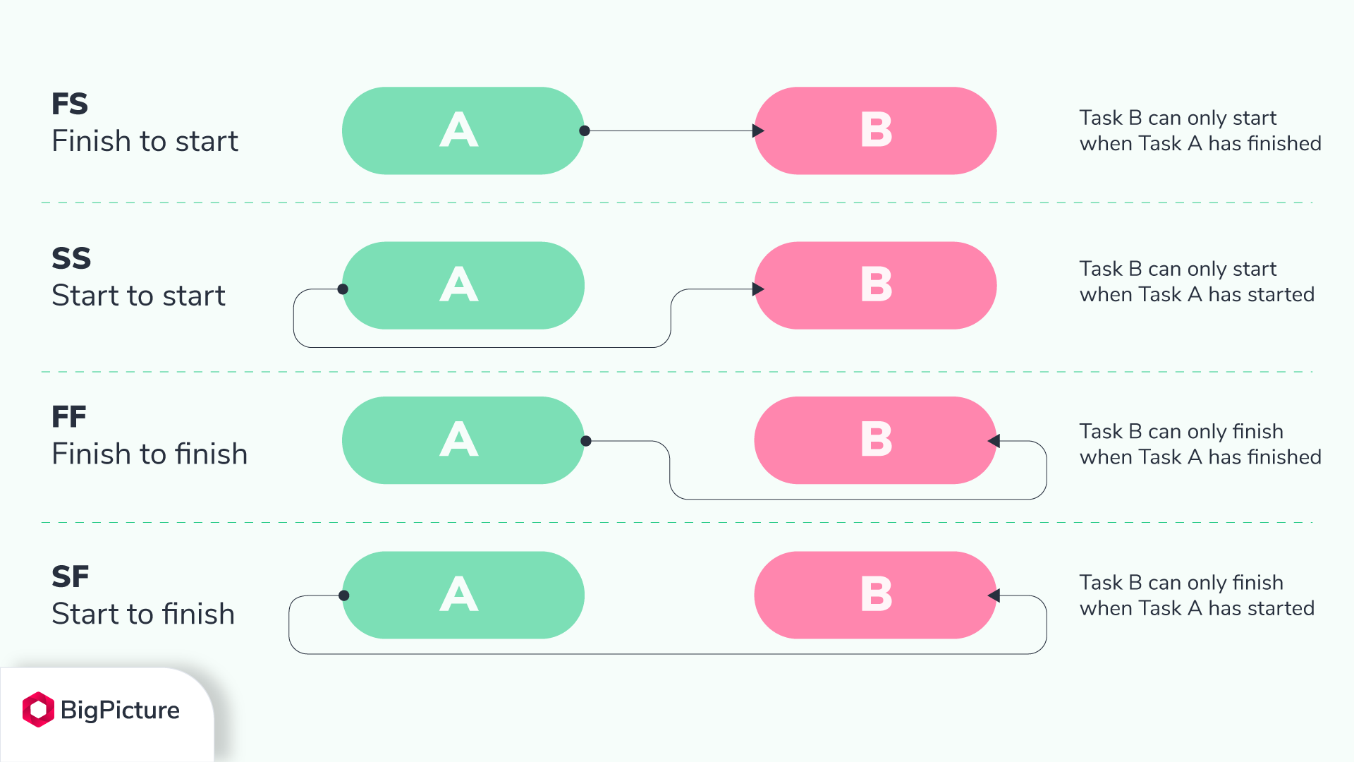

Types of task dependencies
By linking two issues together you can indicate how one task relates to another, and thus—create the order of their execution. But that order can vary depending on the sheer relation between tasks. In general, there are four logical ways to link issues/tasks together to indicate the order and build a schedule. These are:
- Finish to Start (FS): one task can only start when the other one has finished.
- Finish to Finish (FF): one task can only finish when the other one has finished.
- Start to Start (SS): one task can only start when the other one has started.
- Start to Finish (SF): one task can only finish when the other one has started.

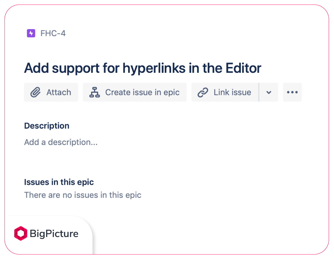

How to create Jira Issue Link
Before you start linking your dependencies in your Jira project, make sure you have the “Linked any issues” permission to do so.
- Open the issue that you want to link to.
- Select triple dots (•••) to expand more options. Click Link > Jira Issue.
- Choose the type of issue link (e.g., “this issue is duplicated by…”).
- Specify the issue(s) you want to link.
Add a comment to describe the reason for linking and select Link.
You can search for the issues you want to link by its full issue key (e.g., FHC-4), or using a basic text search or advanced text search. You will need JQL (Jira Query Language) for the latter one.

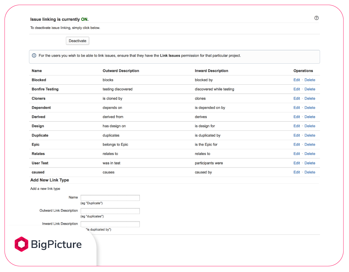

How to add a custom Jira Issue Link
Your Jira administrator can activate more link types, depending on the individual needs of your project.
- Go to Administration > Issues.
- Select Issue Features > Issue Linking to open the Issue Linking page.
- In the Add New Link Type form at the bottom of the page, provide:
- “Causes” in the Name text field.
- “causes” in the Outward Link Description text field.
- “is caused by” in the Inward Link Description text field.
4. Click the Add button.
You will see the Issue Linking page featuring the default and your new link types.
In the screenshot above, you can see the four default Jira issue link types along with a few custom ones.

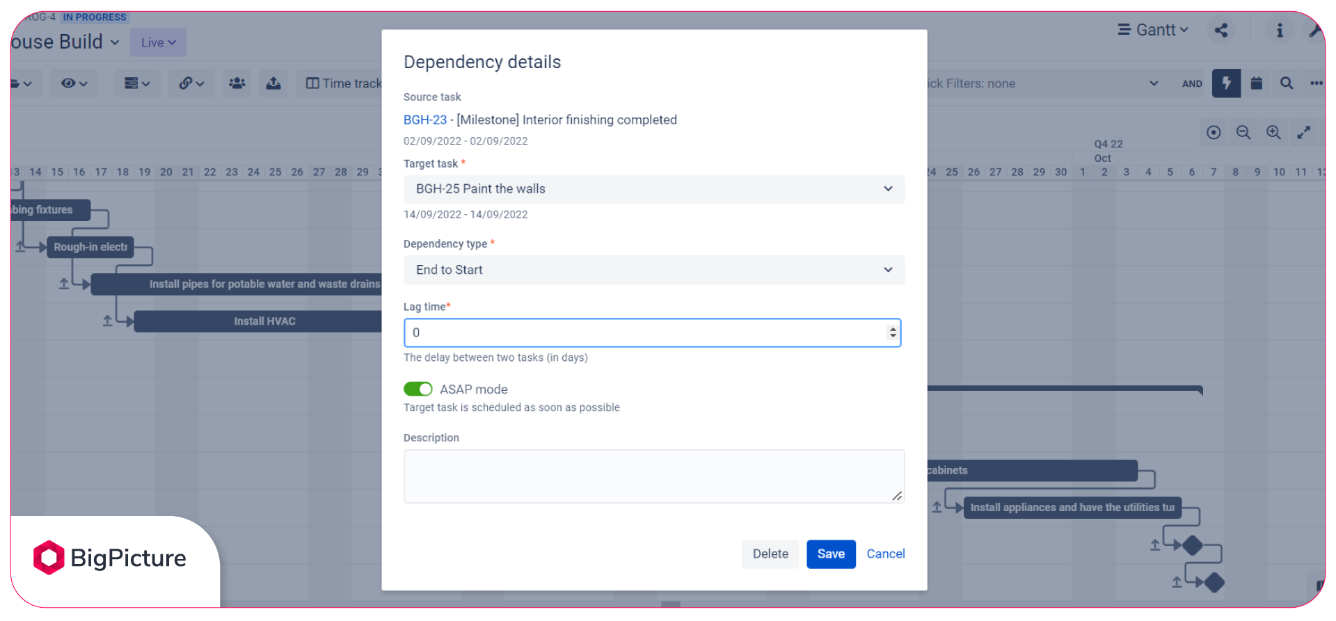

Moreover, you will be able to add lead or lag time to your tasks and enable ASAP mode if needed.
- Lag time is the additional amount of wait time added between two tasks. In other words, a successor task gets accelerated in relation to its predecessor (here, the predecessor gets delayed). You can add Lag to any type of dependency.
- ASAP mode is the scheduling mechanism whose purpose is to try to reduce the gap between dependent tasks to a minimum.
Setting Lag Time and ASAP mode.

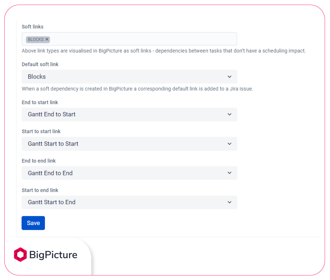

Mapping Jira Issue Links to BigPicture/BigGantt dependencies
When you install BigPicture or BigGantt, the app will automatically add Strong dependency link names to your Issue Links list in Jira. It also works the other way round: whenever you create a new Issue Link in Jira, you will see it in BigPicture/BigGantt, too.
So what is left to do is to tell the app which Issue Link means which dependency.
By default, when you install BigPicture (or BigGantt), you will see in the App Configuration panel that the “Blocks” Jira Issue Link is mapped to the Soft link in the app. The Strong links, however (e.g., “End to start link”) are not specified. It means, that the app does not know which Issue Links from your Jira project should consider as Strong (i.e., which of your Jira links should impact your project schedule).
The App Configuration panel shows default Issue Links mapping in BigPicture (and BigGantt). Here, you customize how you want to map your Jira Issue Links to Soft and Strong dependencies.
Therefore, you will need to either:
- Customize dependency settings (in the App Configuration panel) by selecting which Jira Issue Links will be a Strong type;
- Leave the default settings as they are and create dependency links between the tasks by hand.
NB: Please note that you can assign only one type of an Issue Link to one type of dependency. For example, all “Blocked” Jira links will become “End to Start” dependencies, therefore, no other Jira Issue link can be the “End to Start” Strong link.

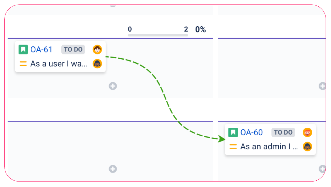

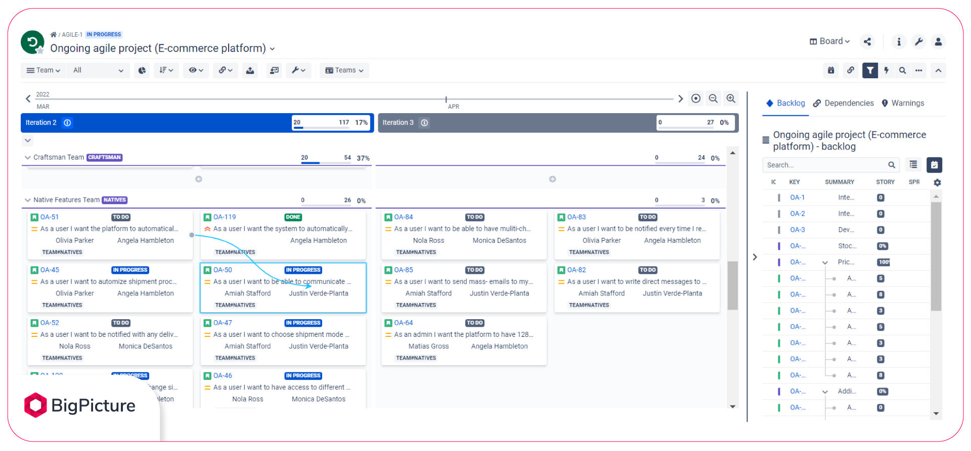

How to create dependencies
You can create a dependency link in two ways.

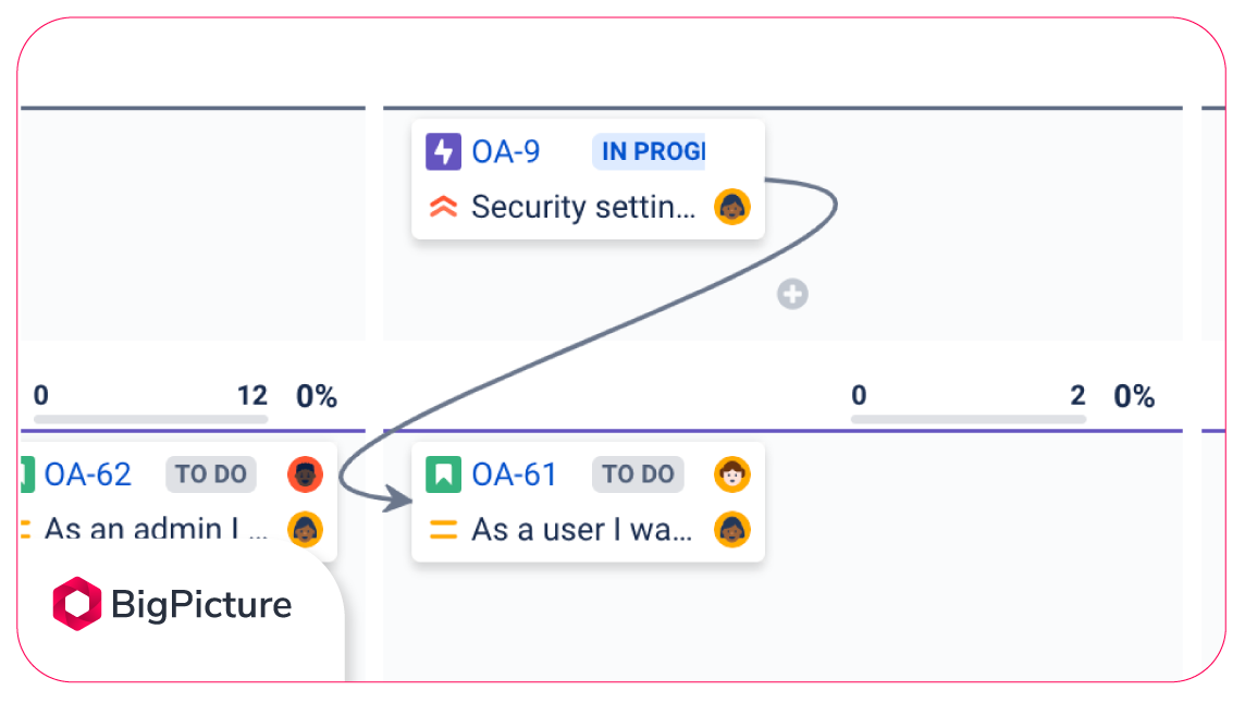

The first method is a simple drag and drop. When you hover over the issue card, a grey dot will appear on the right side. Drag and then drop it on the task you want to link. Keep in mind the direction of the tip of an arrow, i.e., whether it goes from task A to B, or from task B to A.
The BigPicture Board module. A blue line is dragged from task QA-51 to QA-50. When you drop it, it will turn grey. To delete it or edit dependency details (type, lag, ASAP mode), click on it to prompt the edit window.

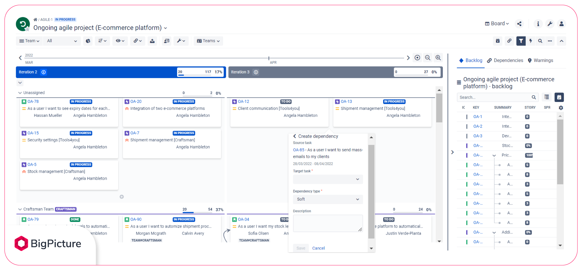

With the second method, you click on the grey dot to prompt the “Create dependency” window. Enter your details and click the “Save” button. This method is much more convenient when working with numerous cards, but you need to know the Issue Key of the task you want to link.
Here, you connect two tasks by specifying the target task to the one you have selected (you can use a drop-down menu to look for the target task or enter a full issue key).

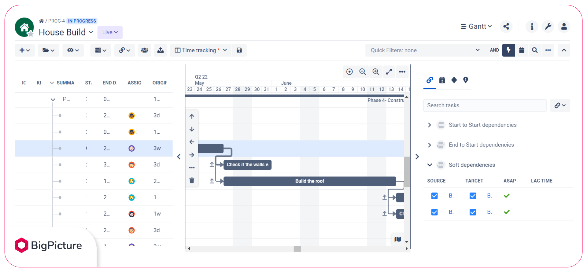

Tracking Jira dependencies
Visualizing dependencies on Agile boards (Scrum board, Kanban Board) or Gantt charts help managers predict conflicting schedules, estimate times, and make apt adjustments. But if there are dozens or hundreds of interdependent tasks, then you need to have a way of tracking them.
Infobar
In BigPicture and BigGantt you can look up your project dependencies on the Infobar, which you will find on the right hand-site. You can conveniently expand (open) and collapse it (hide) whenever you need it.
This view comes from the BigGantt app. The Infobar (on the right) will list all the dependencies present in your project which you can filter based on the type, related task, source, or whether it has Lag or ASAP attributes.

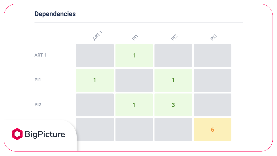

Reports module
If you need a more comprehensive and high-level overview, then you will find what you need in the BigPicture Reports module. You can generate two reports with this module: the Dependencies report and the Cross-Team Dependencies report.
Both reports consist of matrices that show the names of projects or iterations that have at least one dependency. The matrix shows the number of dependencies between projects and their iterations from lower levels (PI Iterations, Sprints, etc.). Depending on the number of dependencies, the color will change from green through yellow to red. If there are no dependencies between projects or iterations, the report will mark it as “No data.”
The difference between these two reports is that the Dependency report does not include parent-child dependencies. The Cross-Team report, on the other hand, shows parent-child dependencies but does not present dependencies between tasks of the same team (you will find it in the Dependencies report).
