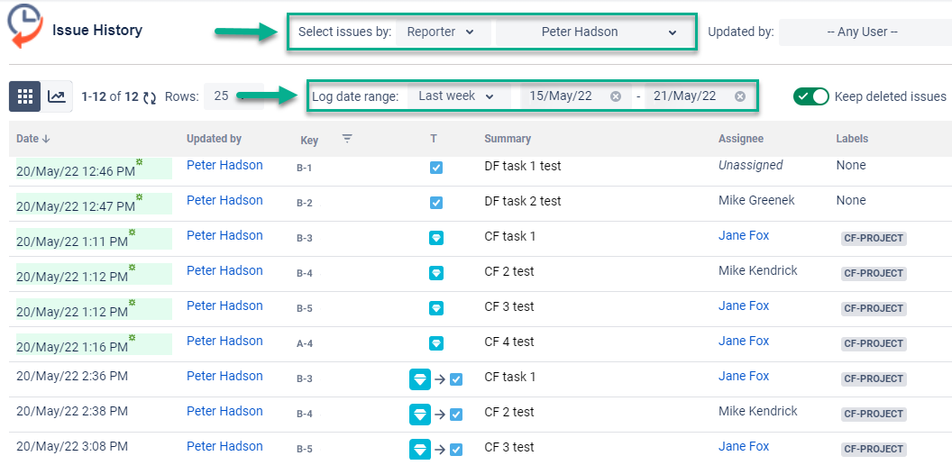

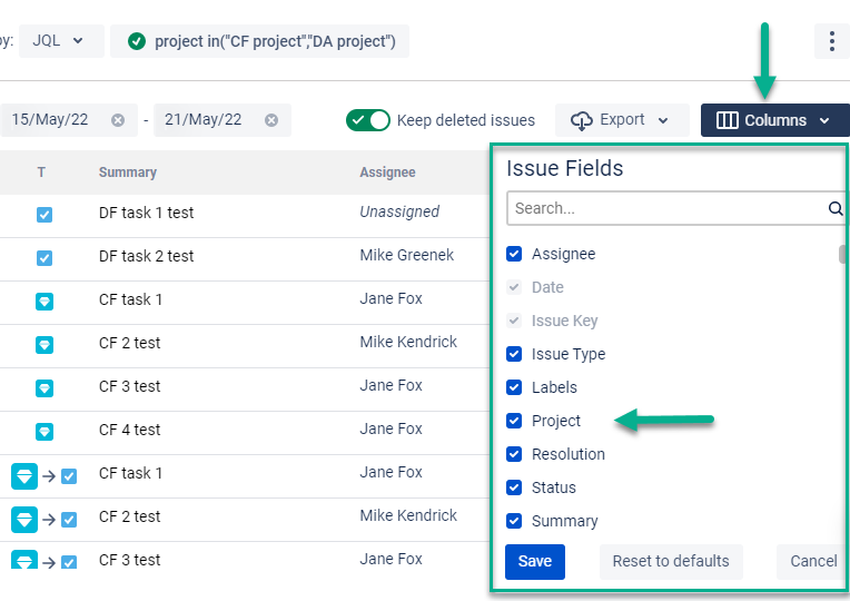

1. Open the Issue History for Jira and use the filter to load tasks according to date and creator.
You can also choose other filters: project, sprint, assignee, JQL, etc.

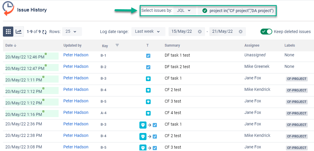

Here is an example with JQL to get 2 projects at once.

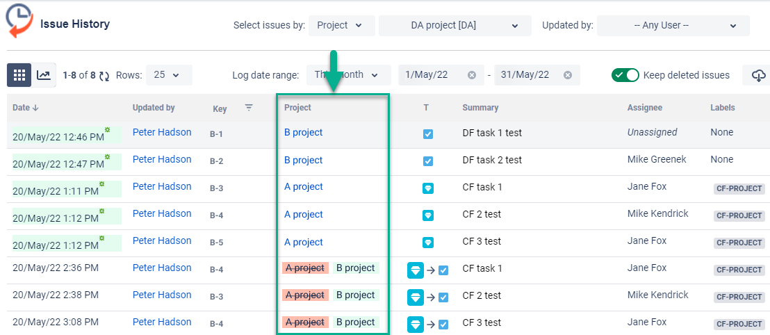

2. Add necessary issue fields as the grid’s columns with help of the Column Manager. Just enter and checkmark the ones you need. Here we added the project.
Now, you’ll get the column with projects’ changes in the table.

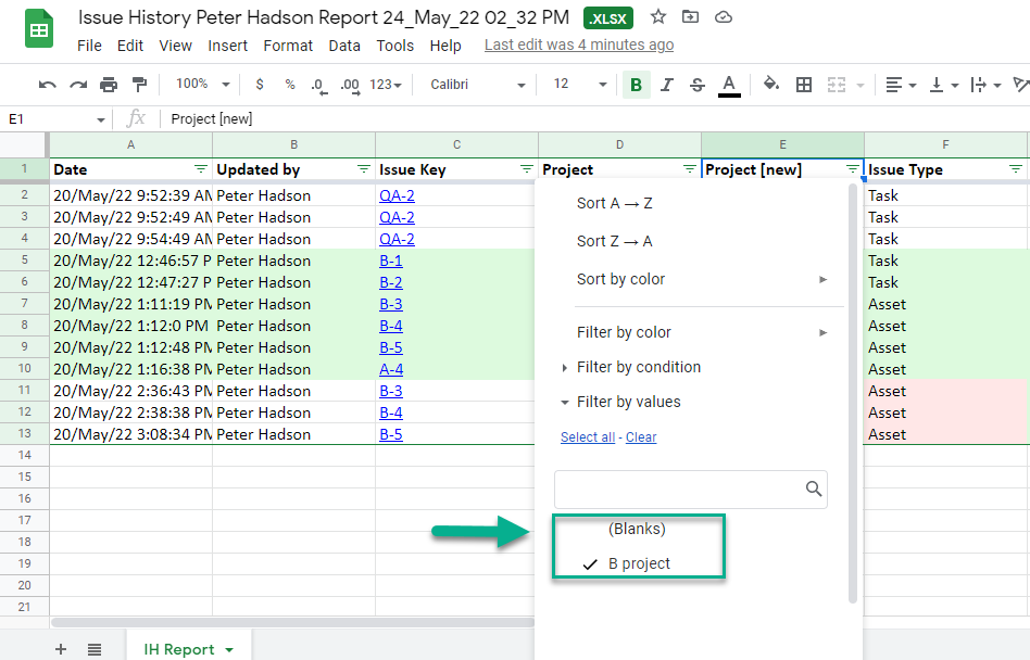

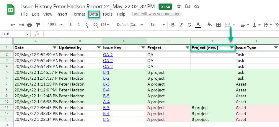

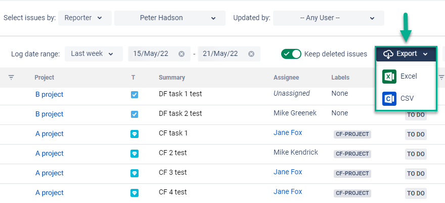

3. Export the report with data to an XLS file (or CSV).
4. Use Data filters for migrated projects (Data → Create filter).
5. Project [new] is the one where tickets were transferred, it’s your target. Uncheck blanks in the Project [new] column.
So, we have a number of tickets that were moved from A → B.
