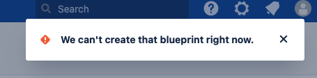

I get the following error when trying to create spaces or pages in my staging instances of Confluence:
Both of the database instances are Azure SQL, so they are on the current version.
Here is what is in the logs when we're doing diagnostic logging. I expect this is somewhat a database issue somewhere, because Confluence is referencing production.dbo.SPACES - but this would not exist in the new database created from the backup of the previous database, because the new database is not called production - it has a different name:
