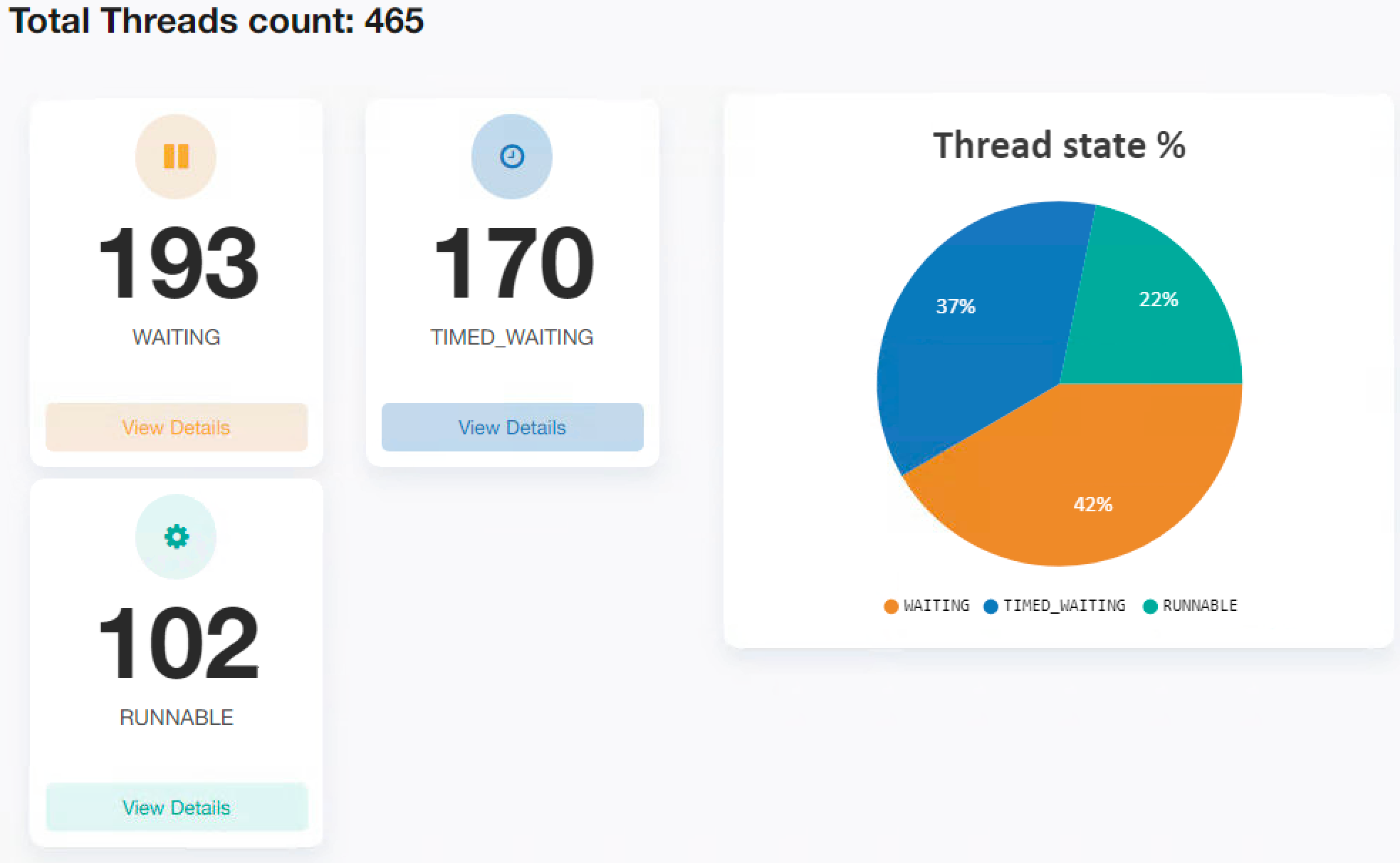

Thread dump from Bamboo (bitbucket have the same situation) - many threads in waiting state

UPD: helps increasing of threads -Dbamboo.plan.exe.threads=8 and heap memory -Xmx
