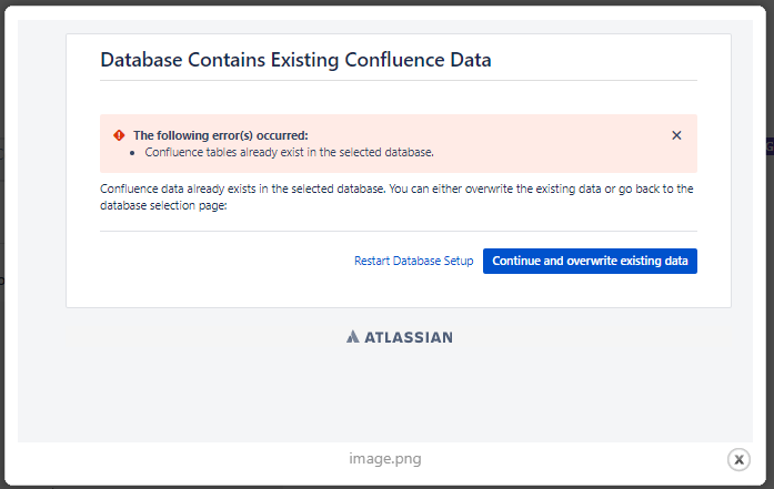

2) Database connectivity issue(Critical): When we continued with installation procedure we got the database error The following error(s) occurred: Confluence tables already exist in the selected database.
the error screenshot is provided as attachment. we have copied dc data to DR now this DR DB is in snap mode when DR confluence installation started .We could not empty the database nor could create the new schema . As if we do this it would not be replica of DC.
