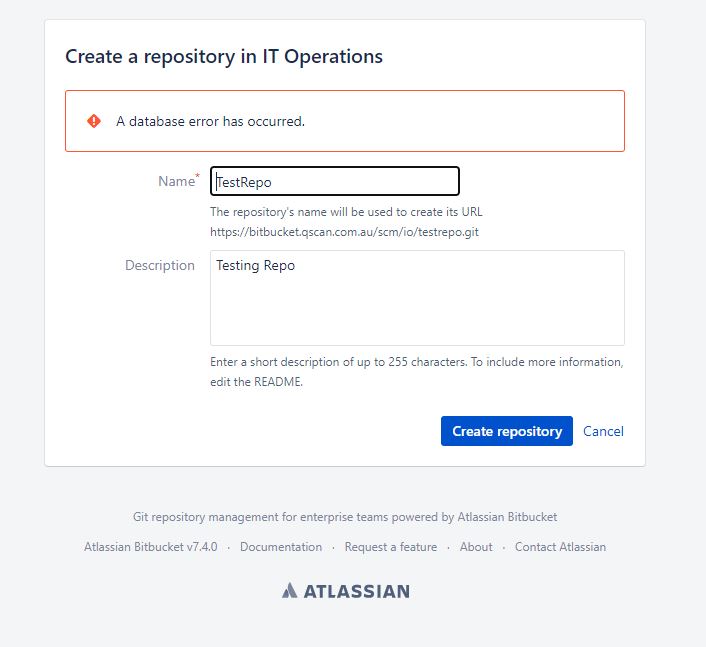

When we try to create new repositories we are getting a message to say "A Database Error Has Occurred"
Have tried restarting bitbucket.

at org.hibernate.event.internal.AbstractFlushingEventListener.performExecutions(AbstractFlushingEventListener.java:348)
at org.hibernate.event.internal.DefaultFlushEventListener.onFlush(DefaultFlushEventListener.java:40)
at org.hibernate.event.service.internal.EventListenerGroupImpl.fireEventOnEachListener(EventListenerGroupImpl.java:102)
at org.hibernate.internal.SessionImpl.doFlush(SessionImpl.java:1356)
at org.hibernate.internal.SessionImpl.flush(SessionImpl.java:1343)
at com.atlassian.stash.internal.repository.HibernateRepositoryDao.create(HibernateRepositoryDao.java:81)
at com.atlassian.stash.internal.repository.HibernateRepositoryDao.create(HibernateRepositoryDao.java:33)
at com.atlassian.stash.internal.repository.DefaultRepositoryService.createRepositoryInDatabase(DefaultRepositoryService.java:754)
at com.atlassian.stash.internal.repository.DefaultRepositoryService.lambda$null$7(DefaultRepositoryService.java:808)
at org.springframework.transaction.support.TransactionTemplate.execute(TransactionTemplate.java:140)
at com.atlassian.stash.internal.repository.DefaultRepositoryService.lambda$createRepositoryWithRetry$8(DefaultRepositoryService.java:807)
at io.atlassian.fugue.retry.RetrySupplier.get(RetrySupplier.java:100)
at com.atlassian.stash.internal.repository.DefaultRepositoryService.createRepositoryWithRetry(DefaultRepositoryService.java:825)
at com.atlassian.stash.internal.repository.DefaultRepositoryService.create(DefaultRepositoryService.java:196)
at com.atlassian.stash.internal.repository.DefaultRepositoryService.create(DefaultRepositoryService.java:94)
... 33 common frames omitted
Caused by: java.sql.BatchUpdateException: Batch entry 0 insert into repository (store_id, description, is_forkable, hierarchy_id, name, project_id, is_public, scm_id, slug, state, id) values (NULL, 'Testing Repo', 'TRUE', '93eaee3fd7e0ea415987', 'TestRepo', 105, 'FALSE', 'git', 'testrepo', 0, 162) was aborted: ERROR: null value in column "is_read_only" violates not-null constraint
Detail: Failing row contains (162, testrepo, TestRepo, 0, 105, git, 93eaee3fd7e0ea415987, t, f, null, Testing Repo, null, null). Call getNextException to see other errors in the batch.
at org.postgresql.jdbc.BatchResultHandler.handleError(BatchResultHandler.java:159)
at org.postgresql.core.v3.QueryExecutorImpl.processResults(QueryExecutorImpl.java:2268)
at org.postgresql.core.v3.QueryExecutorImpl.execute(QueryExecutorImpl.java:510)
at org.postgresql.jdbc.PgStatement.internalExecuteBatch(PgStatement.java:851)
at org.postgresql.jdbc.PgStatement.executeBatch(PgStatement.java:874)
at org.postgresql.jdbc.PgPreparedStatement.executeBatch(PgPreparedStatement.java:1563)
at com.zaxxer.hikari.pool.ProxyStatement.executeBatch(ProxyStatement.java:128)
at com.zaxxer.hikari.pool.HikariProxyPreparedStatement.executeBatch(HikariProxyPreparedStatement.java)
at org.hibernate.engine.jdbc.batch.internal.BatchingBatch.performExecution(BatchingBatch.java:119)
... 55 common frames omitted
Next exception: org.postgresql.util.PSQLException: ERROR: null value in column "is_read_only" violates not-null constraint
at org.postgresql.core.v3.QueryExecutorImpl.receiveErrorResponse(QueryExecutorImpl.java:2532)
at org.postgresql.core.v3.QueryExecutorImpl.processResults(QueryExecutorImpl.java:2267)
at org.hibernate.engine.jdbc.batch.internal.BatchingBatch.doExecuteBatch(BatchingBatch.java:105)
at org.hibernate.engine.jdbc.batch.internal.AbstractBatchImpl.execute(AbstractBatchImpl.java:148)
at org.hibernate.engine.jdbc.internal.JdbcCoordinatorImpl.executeBatch(JdbcCoordinatorImpl.java:198)
<snip>
Caused by: org.postgresql.util.PSQLException: ERROR: null value in column "is_read_only" violates not-null constraint
... 62 common frames omitted
Does anyone have any suggestions? The "is_read_only" column in the table is set to require a value and does not have a default value assigned. I could set this but obviously hesitant to make any changes here without knowing consequences.
Thanks in advance.
