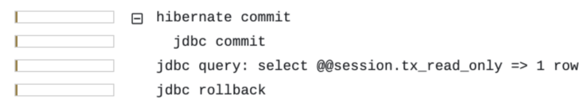

First of all, Glowroot showed that for each request to the database, Confluence checks the state of the connection, as follows:
But the number of status checks is 11 per one useful request, and it takes from 0.20 ms to 0.32 ms for each check. That is, on average, 2 to 3 milliseconds are spent on auxiliary requests. And if we do not have caching at the application level or when caching is invalidated, then this is a bottleneck.

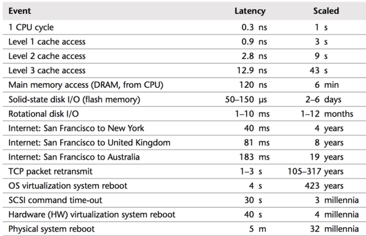

Further, after specifying the DBMS version and driver version using the following link https://{CONFLUENCE_URL} /admin/systeminfo.action, there was room for thought. Especially thanks to the good old delays plate, as it always helps me to identify bottlenecks by eye.

Since I am still using MySQL, updating the driver has traditionally reduced my symptoms. The article “After updating the online database, there is a problem of excessive rollback of database transactions” helped me to understand the reasons, where the solution was switching to another puller (https://github.com/alibaba/druid/wiki/FAQ). In my case, switching to PostgreSQL.

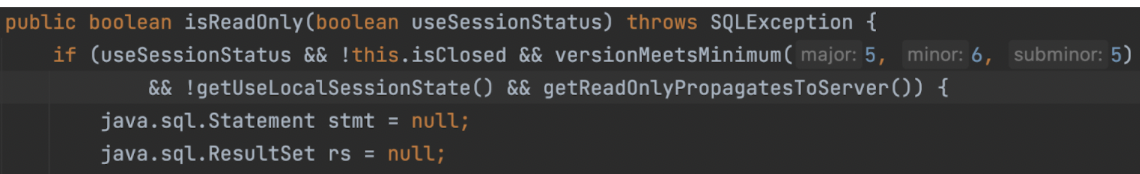

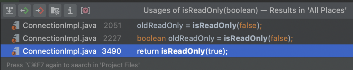

If you want to see how the useSessionStatus parameter works, you can download the connector and check the use of the isReadOnly method.
Зависимость версии легко проверить, посмотрев первое условие в методе.
In summary, the short-term solution is to take risks and update the DBMS connector driver, while the long-term solution is to migrate to PostgreSQL 11.
