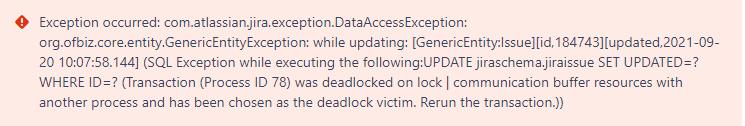

Often, when we update a ticket, we get the error:
"Deadlock errors in logs when running Jira server with SQL Server database"
Often it is enough to repeat the action to make it successful, other times it is necessary to reload the ticket page and then repeat the action.
It happens practically every day on many agents, we can't understand what it comes from.

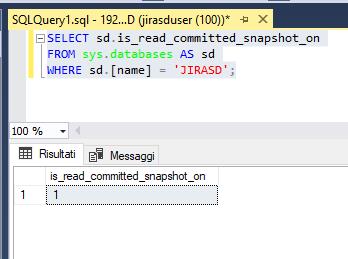

2. Tried the solution here with no success (https://confluence.atlassian.com/jirakb/deadlock-errors-in-logs-when-running-jira-server-with-sql-server-database-283640022.html? utm_medium = scheduledLogScan & utm_source = STP), Screenshot attached

I've found those in the LOGS:
Line 3011: Caused by: org.ofbiz.core.entity.GenericDataSourceException: SQL Exception while executing the following:UPDATE jiraschema.jiraissue SET UPDATED=? WHERE ID=? (Transaction (Process ID 88) was deadlocked on lock | communication buffer resources with another process and has been chosen as the deadlock victim. Rerun the transaction.)
Line 3869: Caused by: org.ofbiz.core.entity.GenericDataSourceException: Generic Entity Exception occurred in deleteAll (SQL Exception while executing the following:DELETE FROM jiraschema.customfieldvalue WHERE ID=? (Transaction (Process ID 57) was deadlocked on lock | communication buffer resources with another process and has been chosen as the deadlock victim. Rerun the transaction.))
Line 5899: Caused by: org.ofbiz.core.entity.GenericDataSourceException: SQL Exception while executing the following:UPDATE jiraschema.OS_CURRENTSTEP SET START_DATE=? WHERE ID=? (Transaction (Process ID 90) was deadlocked on lock resources with another process and has been chosen as the deadlock victim. Rerun the transaction.)
Line 8356: Caused by: org.ofbiz.core.entity.GenericDataSourceException: SQL Exception while executing the following:UPDATE jiraschema.jiraissue SET ASSIGNEE=?, UPDATED=? WHERE ID=? (Transaction (Process ID 90) was deadlocked on lock | communication buffer resources with another process and has been chosen as the deadlock victim. Rerun the transaction.)
