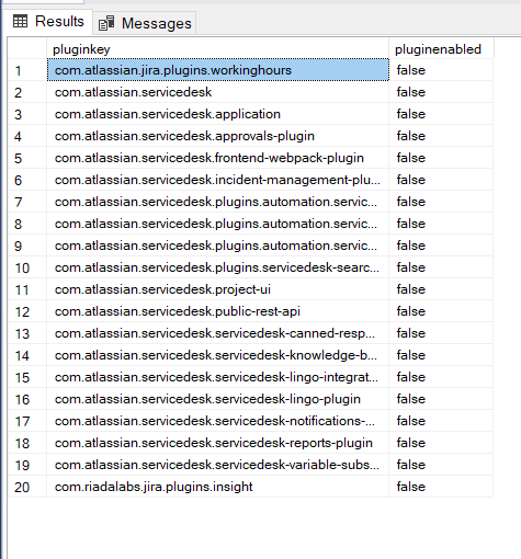

I had some problems with Jira Service Desk after the update to 8.19. It was displayed as "you got a license but its not installed." Installing resulted in an error.
However I did a complete reinstall and everything went fine (complete clean install, no LDAP, nothing, no restore, no data, version 8.20.0). I installed Service Desk and added my License. After a restart its "not installed" again.
Why does it stop working after some restarts and is set to false?
/****** Script for SelectTopNRows command from SSMS ******/
SELECT TOP (1000) [pluginkey]
,[pluginenabled]
FROM [XX].[dbo].[pluginstate]
