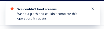

One of our users reported they could no longer access the "Screens" menu from the admin interface in Jira Core. They get a popup that simply says "We couldn't load screens".
We recently upgraded our Jira Core local server instance to 18.19.1, but it had been a while since anyone had tried to make modifications to any screens. So I can't tell if this is the cause.
The server log spits out a long error message each time the "Screens" menu button is pressed, I have attached the log below. Any suggestions where to go from here?
