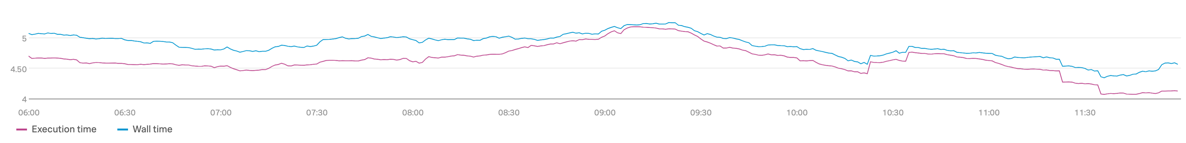

What we discovered was eye-opening. From reviewing detailed logs for some merge operations we had identified as particularly slow, we noticed that our system for scheduling and executing background tasks reported major discrepancies between the timestamps when tasks were received vs. when they were completed, which could not be explained by their runtime. During periods of peak traffic, this discrepancy reached pathological levels as can be seen in the graph below, capturing a period during which wall time exceeded 30s while task execution time remained only a few seconds.
On its face, this scenario did not seem entirely mysterious. Two straightforward explanations exist to account for the difference between execution time and wall time: tasks could be sitting in a queue, or they could be prefetched by workers and effectively delayed by other long-running tasks. However, our metrics indicated that queues were not backing up; and we configured our workers to disable prefetching.
Ultimately what we found, without getting into too much detail, is that a bug in the library our services use to schedule and execute background tasks was causing a large number of workers to sit idle without executing tasks. A master orchestrator process was still consuming from our queues fast enough to prevent a backlog of messages, but these tasks were being allocated to an artificially small pool of workers preventing effective parallelization. This bug had not affected our services running in the data center; it only started to affect things after our migration to our new cloud platform due to subtle differences in configuration.
Through extensive testing, we were able to identify changes to the configuration of the service responsible for performing pull request merges to work around this bug and restore the intended behavior. This has made a huge difference and we can now see wall times tracking much closer to task execution times, typically within < 1 second.
