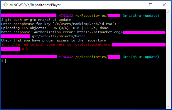

- Trying to push to that branch via bash, it will ask you to log in 2 or 3 times, then fail with "batch reponse: Authorization error" and "Check that you have proper access to the repository", and "error: failed to push some refs to [$repo]", which is odd since we can still access other branches just fine.

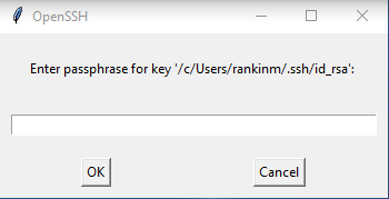

- Windows pops up multiple OpenSSH "Authenticate" windows, and neither logging in or closing it gets rid of it... it just keeps popping back up. (Virus check was clean.)

Here's the bash when I try to push the latest changes:
Here's the OpenSSH window that it opens multiple copies of, even when you close it. (In the Task Manager, we can see multiple instances of it running, as "Git for Windows (32 bit)")
