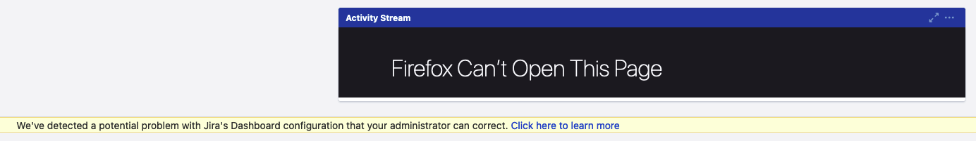

When accessing https://jira.mydomain.com:8443, we are able to login and access Jira, but the gadgets are failing to load, most likely because the Base URL is set to https://jira.mydomain.com (without the port).
See picture below when accessing https://jira.mydomain.com:8443:
What would be the best practice and configuration to also redirect the requests with port :8443 in the URL to the appropriate proxy connector in Jira ?
