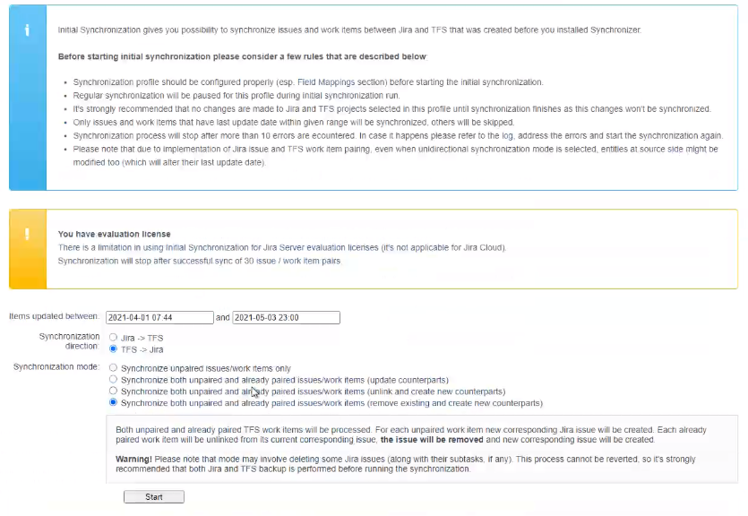

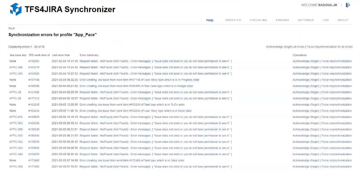

Once the app was installed in Jira, it acted very similar to the Jira and ADO Connectors for Jira Align. As you would expected, you need to establish field mapping between Jira and ADO (what's the "Epic Link field" or "what's the Story Point field"). Once field mapping is established, establish a Jira Project and Jira Board for each ADO team, and map the ADO team to the Jira Project. You'll also need to map the workflows, users, and other data points needed. Needless to say, there are a lot of options during these steps to set up the synchronization. Once you have things mapped, you can then begin the synchronization process to pull data from ADO into Jira. There is a handy log that shows you any synchronization issues along the way (see below).
At this point you are beginning to sync changes from ADO to Jira, but what if you want to sync changes from Jira to ADO? Within the app you can establish what kind of bi-directional syncing you'd like to use...
Congratulations! You now have data synchronization between ADO and Jira. Changes made in either system will replicate, including work items, sprints, story points, etc. Now all you need to do is sync the Jira Project and Jira Board into Jira Align (using the standard steps found in the Jira Integration Guide) and you will now experience bi-directionality syncing between Jira Align < > Jira < > ADO!

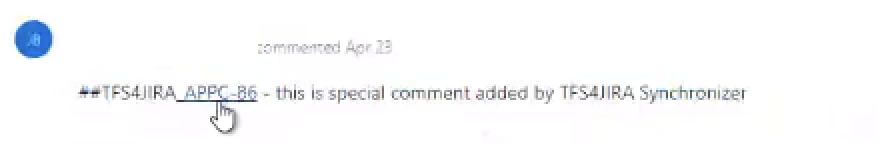

- Similar to work item links being added to Jira from Jira Align (to give you a direct link to the Jira Align object), the app will do the same thing by placing a comment on the ADO object with a link to the Jira issue. Super handy!

- Data synchronization issues between Jira and ADO will appear in Jira, but not Jira Align. We experienced an issue where a field wasn't mapped properly between Jira and ADO. From Jira Align we were seeing overall changes come through and thought "hey, everything looks good" but in fact there was data missing. Jira Align will only know if there are synchronization issues between Jira and Jira Align, so make sure to regularly check the synchronization log in the TFS4Jira Azure DevOps Integration app to ensure data between Jira and ADO is updating as expected.
