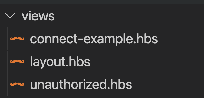

app.set('views', viewsDir);These lines tell us that our app will use Handlebars which is a template engine for html output. We can see that all templates are in the views folder:
The unauthorized.hbs template is used by atlassian-connect-express to provide errors if something wrong happened during calling our app module.
Other templates we will discuss later.

hbs templates
We did not discuss yet the views/layout.hbs and views/connect-example.hbs.
views/layout.hbs is just the root template which should be included in all templates for the pages which we call from webPanel, repoPage, adminPage or configurePage modules:
