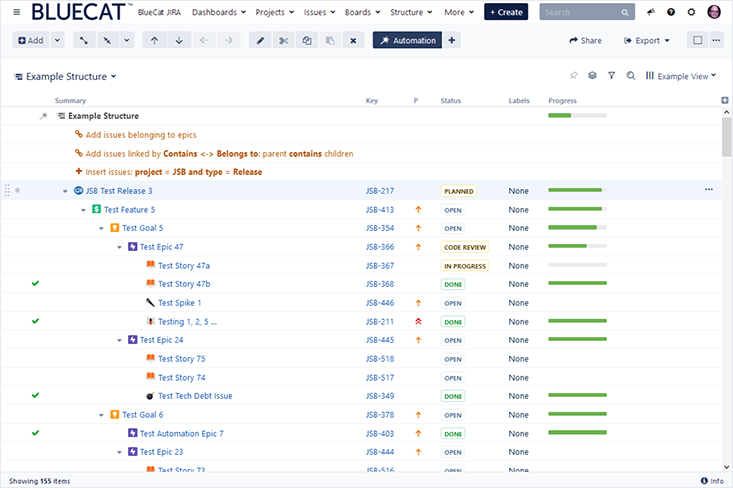

BlueCat wanted to organize hierarchies that went above the standard Jira epic. Structure allows for largely open-ended construction of hierarchies, so Bluecat could organize their hierarchies to suit their preferences. Here's what they went with:
- Release
- Feature
- Goal
- Epic
- Story
BlueCat could zoom in and out of its hierarchies — drilling down to see stories, and then back up for high-level feature views. Everyone can see their work in its proper context, in as much or as little detail as they need.
BlueCat is able to visualize its preferred issue hierarchy with a few simple business rules.
Keep key connections in place, automatically
With Structure, Arrey's team builds hierarchies of issues, called "structures," and populates them using the app's automation feature. That feature allows the users to define special rules — called generators — that become the basis for these hierarchies
BlueCat uses an Insert generator to pull in the root-level issue and they add Extend generators — which follow issue links, epic links, and sub-task links — to build out the tree from the roots.
For example, BlueCat uses a custom Jira issue link called "contains < > belongs to" to create the desired hierarchy. If someone updates the issue links, the structure updates in response. Furthermore, as new “releases,” “features,” “goals,” etc., that fit the JQL criteria are created elsewhere in Jira, they are automatically pulled into the structure.
"That's very powerful — our program managers live and die by this," Arrey says.

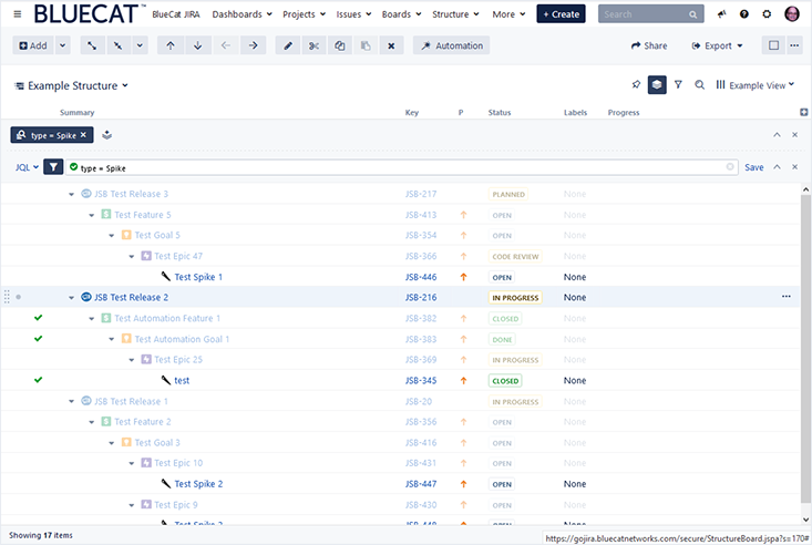

Individual BlueCat users can take advantage of a feature called Transformations to re-organize their hierarchies — without changing the views of other users sharing the structure — to see individual tasks in a variety of contexts that can help them ensure everything is accounted for.
These allow users to easily see the issues that matter to them without affecting anyone else's view.
BlueCat uses Transformations to narrow the focus of their structures for a particular topic or team.
BlueCat uses a few types of Transformations. Select an epic together with the pin Transformation, and you zoom in on specific parts of the structure. For example, selected epics — and their parents and children — will be highlighted while everything above and below will be grayed out or disappear.
Other Transformations create different views that allow users to see their work in whatever context they need.
